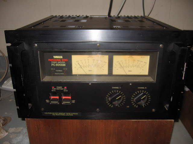

Hey Chris, if you're not gonna run the volume on that PC5002M all the way up, send it to me for proper attention. I'll swap ya for one of these PC4002M since you never got one. :D

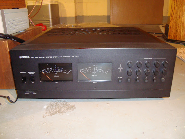

B-1/UC-1 :drool:
