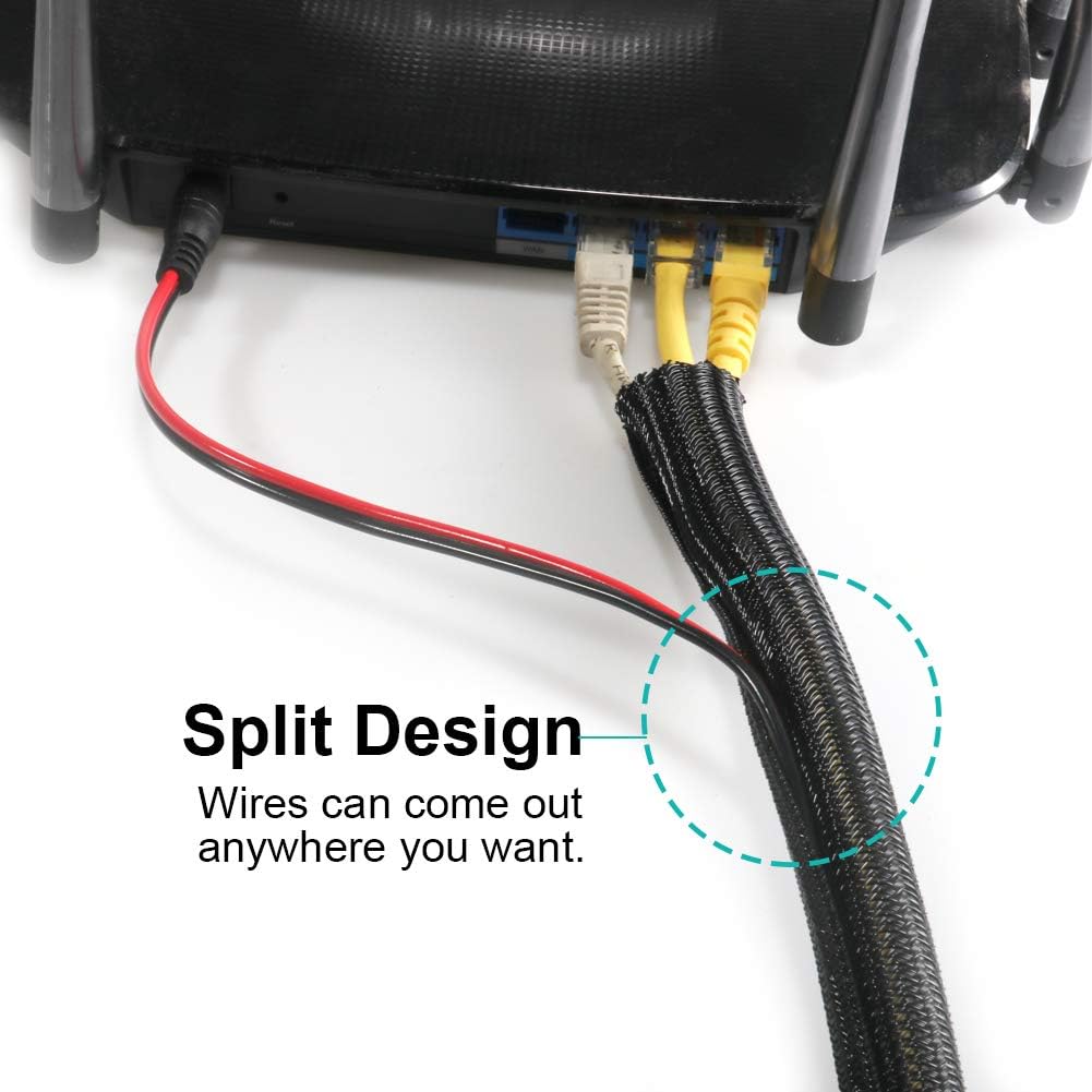

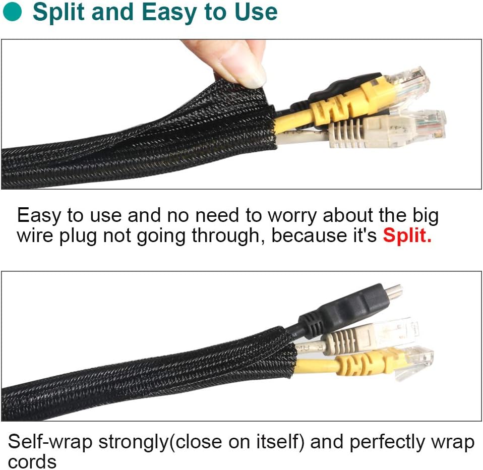

One thing that is a miracle worker for organizing wires is Alex Tech sleeves (https://www.amazon.com/Feet-Protector-Management-Protectors-Television/dp/B07NVG25D1/ref=sr_1_6?crid=35MS4WZDSY89W&dchild=1&keywords=alex+tech+braided+cable+sleeve&qid=1603082295&sprefix=alex+tech,aps,153&sr=8-6). If you have several cables running most of the length in parallel, you can bundle them together with the sleeving below. Unlike TechFlex that is solid, this sleeving is split down its length and self-enclosing, so it's easy to add and remove cables from the bundle as needed. Be sure to order the right diameter based upon how many cables you are bundling together (usually 3/4" works pretty well).
This stuff is pretty life-changing when it comes to organizing cables.
