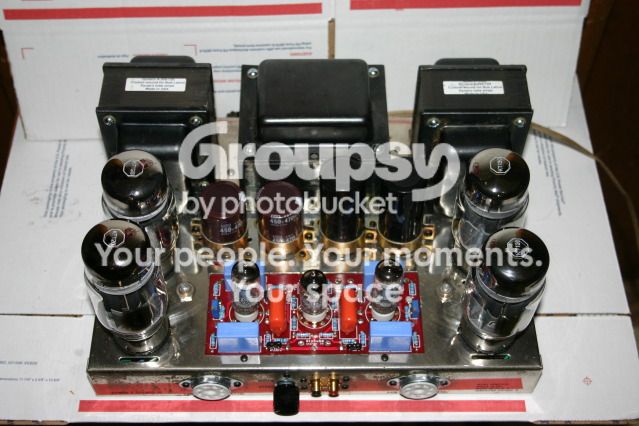

In my most recent build I used the same exact tubes, same exact OPTs, same exact power transformer, but with SS rectifier instead of GZ34. No choke for the plate supply, only 500uf low ESR capacitance right from the UF4007s. Bass is impressively low and tight.
Problem is, there are other changes like a completely different driver stage and fixed bias vs. cathode bias.
