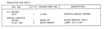

Hello
Do you know the correct Carver TFM meter lamps> I thought it was 8V at 250ma? Thanks
Anthony
I have refreshed a half dozen of these and I always forget the meter light voltages...
Per the service manual: 12V 0.15A
