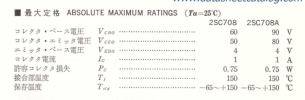

I'm finding some conflicting datasheets on the original parts, a few sources say they are 100mhz parts, another says 15 mhz. Inclined to believe the 15 since its an official Toshiba datasheet. If so that sounds like the new parts are a reasonable sub. They exceed the voltage, current, and power ratings by a sizable margin and the gain numbers are similar.

When matching I rarely look at the mhz component of tranisistors. What's the impact if the sub is much higher or lower speed over the original?

If its much higher it can possibly allow for oscillation that wouldn't happen with a slower part. Thats kind of why I'm wondering if something fishy is happening. Oscillation causes high current draw = heat. I'd expect it to show up as high voltage across the emitter resistors too though. Either way if its oscillating it should show up as something weird on the output of the amp.

the original transistors are rated for 3/4 watt of power dissipation
that would be very little heat output. If you want to calculate th dissipation to confirm its somewhere within the limits, voltage from emitter to collector times the current flow. Voltage drop across the collector resistor divided by the resistor value will get you the current. Current * volts = watts
