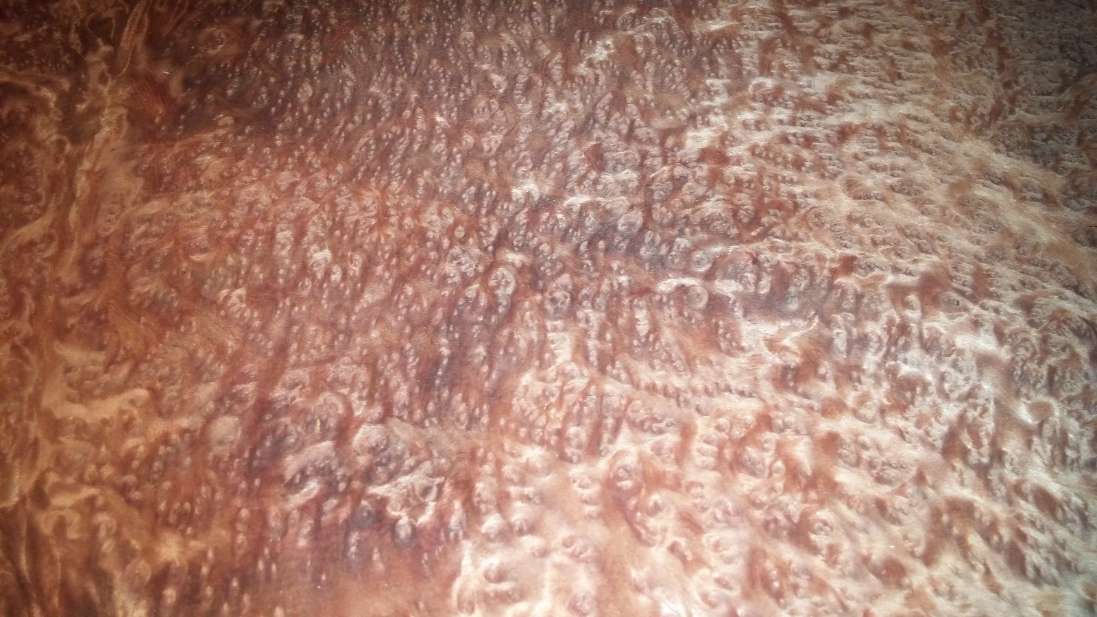

Well, after much searching and deliberation, I've decided the the proper way to do these side panels is to use real veneer.
Earlier this week I found a very nice candidate for a simulated wood side using a 3/4" shelf panel at HD, which would be perfect, since that's the thickness of the originals and all other pre-finished shelf candidates were too thin. But just as I was about to go to checkout, I noticed that the edgebanding on the one side was a different kind/shape than the other three (thin and perfectly flat, as opposed to thicker and rounded edge like the other three - presumably the flat being the rear of the shelf). Shown below are the top, front, and side, but the back didn't have that same edge. It's a shame, because they actually looked even nicer in person than the pic suggests (not near as textured), and were the perfect size to cut right down the middle lengthwise, then chop off the back end to exact dimensions. Only thing was, that the one edgebanding wouldn't match, and that would be the top part of the rail. Too much of a visible difference, and not cost effective if I had to buy a second shelf to have two that perfectly matched, since for only a couple bucks more (and a little extra DIY) I can do real wood veneer instead.
So I've been searching online for veneer and have found a couple of candidates, all with enough extra to practice on before doing the final project.
I've been reading a couple veneer threads here in DIY, and see that maybe my best option is to use these original panels, heating the vinyl and edging to strip it off, and then repair the damaged corners with that machinable epoxy stuff. Then, just putting on a new veneer - this time, the real stuff.
So now comes the question...
What veneer?
All options I've selected are raw veneers (which I've been studying the correct process for applying).
There's rosewood, like the original panels.
But there are also burl maple, and a couple burl redwoods that could look amazing as well. And with any of these options, there would be enough left over to do the sides of a Sony ES CD player from that same era as well if I ever decided to get one, so they'd all match.
I'm usually a stickler for keeping things pretty original, so the rosewood seems to be the most true in that sense. But those burls... just wow! And I've seen some of the custom cabinets and plinths you all have posted pics of here. I have a burl veneer table that can be seen above which the receiver is sitting on, and I have to say, it sure does look good when the light hits it. Having a similarly interesting wood pattern on these side panels would be unique. (It won't be sitting on that table anyway. That's just for while I've been going through it and getting it operating.)
So I'm kinda in a limbo. I've ruled out the pre-made shelf panels, so now it's just deciding if I want nice original, or if I want custom awesome.
Any suggestions? Input? Please let me know - I'm all ears! :)
