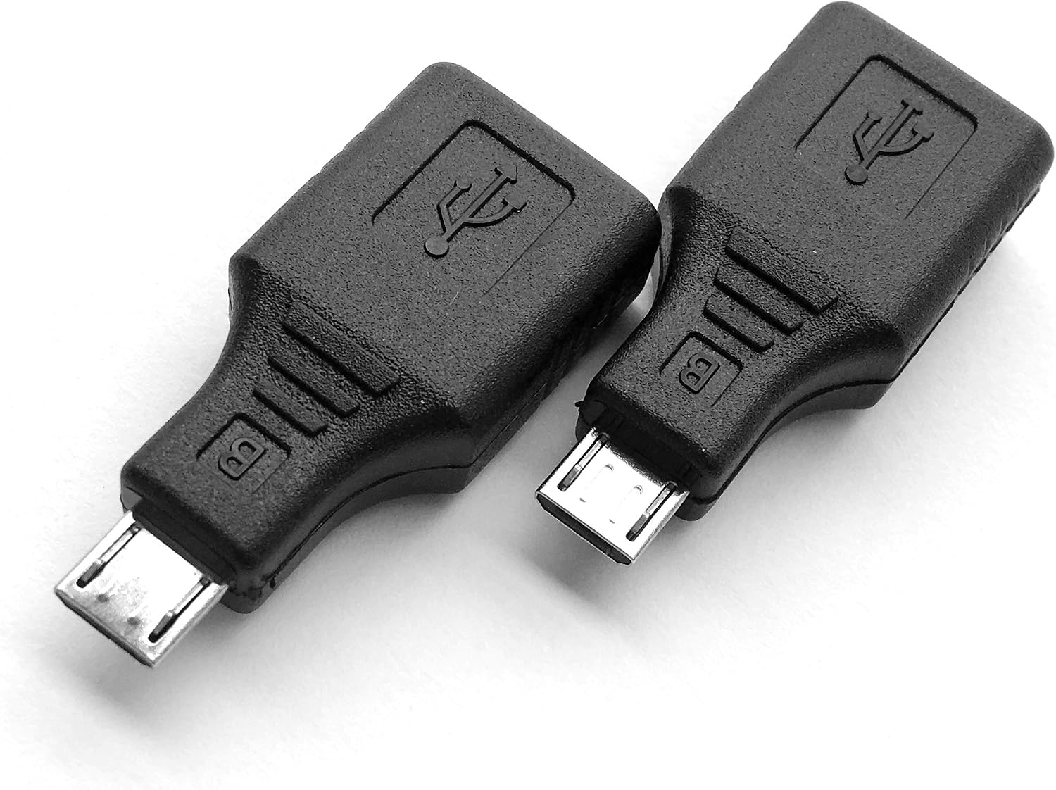

I have a couple old generic pads, used a couple of mini usb to usb adapters with a usb to av adapter...
The results are decent, but, of course, they are asking how I connected it all and are now interested, so I want to engage them in getting a better sound.... introduce a dac. I'm investigating. The system now works pretty good, but I think cheap new Fires to replace the junked up ones are in our future, so then each will have their old "cleaned" Fires as their "delivery" device dedicated to the stereo.

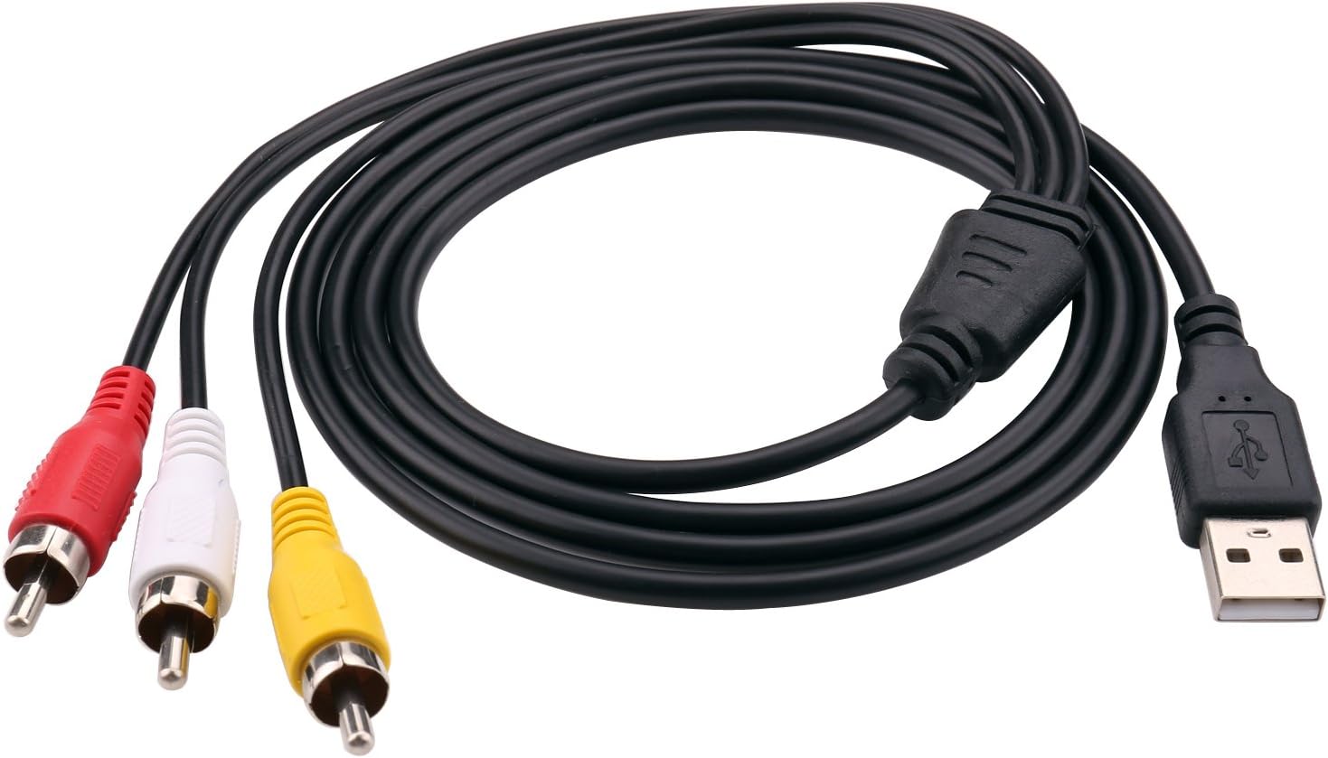

My first question would be specific to my daughter. We're putting together a Fisher 295 with a couple of nice Polks. She doesn't want LP's, she might want CD's at some point, but she has a Fire we need to connect now...
I'm thinking a
...to a...
...and then typical rca into the AUX of the Fisher. This setup would allow either the Fire or her phone to connect via the headphone jack. I've had them using the VLC player for years, so they know that interface for things downloaded, but Spotify and YouTube are where they are headed now.
Thoughts?
If your coming right out of the source device's headphone jack, there's no need for a DAC, as it's already analog. A 3.5mm to stereo RCA will suffice.
I'm thinking a
...to a...
Thoughts?
I think the 1st cable most likely isn't what you want. At least I can't think of a purpose for it with the other items pictured.
