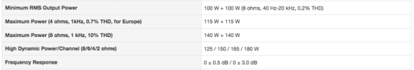

The second line in amplifier specs is the only one that is meaningful -- this measurement (with distortion and FR) is omitted on the receiver I posted earlier to make that receiver look better than it is. Few people will notice that they are giving meaningless stats on the Yamaha page.
If you follow the 3 examples below, the "specs games" are quite evident. You would expect any manufacturer to at least provide uniform stats across its models, but there is no consistency whatsoever and games are being played to make performance look far better than it is.

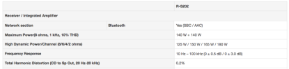

This is the R-S202 receiver stats -- performance is totally obscured (it suggests FR is 10-100khz, more likely 40-20khz at best, power output is totally obscured, only shows peak output with 1khz signal at 10% distortion:
