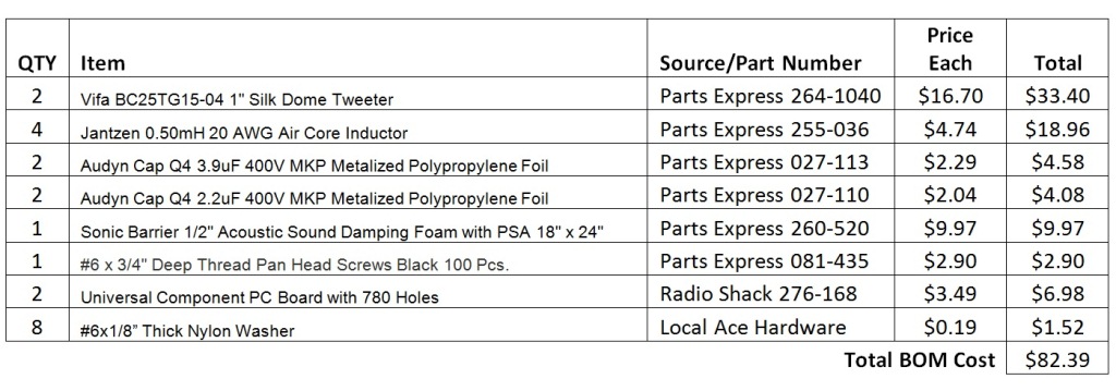

You will need the following materials to perform these modifications to your stock Pioneer SP-BS2-LR speakers:
Bill of Materials: Dennis Murphy Modifications for Pioneer SP-BS22-LR
Photo 1. The BOM Components
As shown in the table, most of the parts are available from Parts Express. The prices shown are current as of July, 2014 and are subject to change. These are single quantity pricing and do not represent any discounts (in other words, the most you will pay at the time of this article). I actually paid less as I bought my items when Parts Express was having a 20% off sale, and I also purchased enough materials to modify four speakers. So, I got additional quantity discounts on some items. The cost of the Jantzen 0.5mH air core inductor has also gone up since I made my purchase. One sheet of Sonic Barrier was enough for four speakers and the 100 pack of #6x3/4” pan head screws is enough to modify eight speakers. So, after all discounts and free shipping my total materials cost came out to $115.97 for the parts required to modify four speakers. That’s $57.99 per pair. Since I paid $79.99 and $65.00 for my two pair of speakers, that makes my total net cost $260.96 for four speakers, or $130.48 per pair after modifications. That’s only $0.49/pair more than the $129.99 MSRP for the stock speakers.

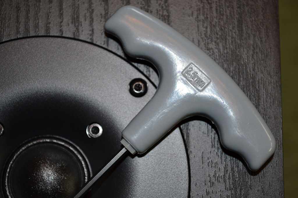

Photo 2. 2.5mm Hex Key for Removing Driver Mounting Screws
Using a 2.5mm hex key, remove the screws holding the tweeter and woofer in the cabinet. You MUST use the correct 2.5mm hex key. If you don’t, you will strip out the hex sockets in the head of the screws. As simple as this step sounds, it is susceptible to risk. The stock mounting screws are very low quality made from very soft metal. They were intended to be screwed in once, for the life of the product, not repeatedly removed and re-installed by an ambitious Do-It-Yourselfer. For this reason, I recommend throwing these screws away and not attempting to reuse them. Use the #6 x ¾” Phillips pan head screws instead. Remove the drivers from the cabinet. Unhook the wires from the back of the drivers (to do so, slide the clear plastic insulators back from the terminals and press down on the small retention tabs with your fingernail). Set aside the woofer for later use.

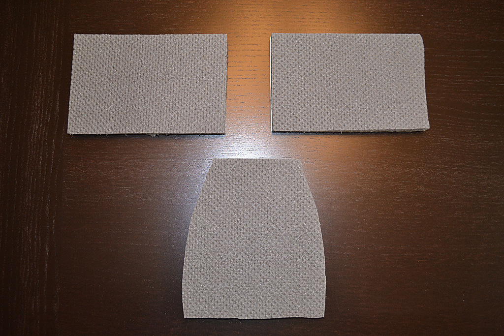

Cut four pieces of the Sonic Barrier acoustic foam to install in the bottom half of the cabinet. The two side pieces are 7” x 4 ½”. I recommend making a template for the bottom piece. If you plan your cuts carefully, you will actually have enough for four speakers.
Photo 4. Sonic Barrier for Sides and Bottom of Cabinet
Install the Sonic Barrier in the cabinet.
Photo 5. The Sonic Barrier Installed in the Cabinet

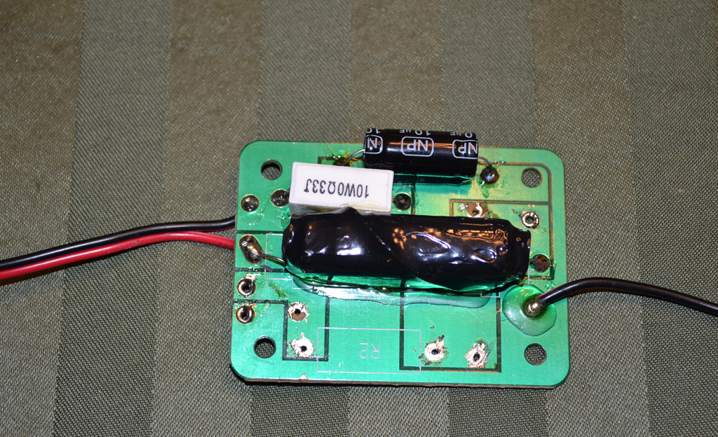

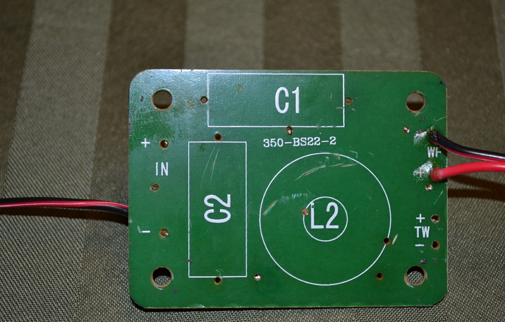

Start by removing the following components from the original crossover PCB:
• C1 - 10uF NP – Top Side, Retain for Reuse
• C2 – 2.2 uF – Top Side, Retain for Reuse
• L2 – 0.4mH Air Core – Top Side - Discard
• R2 – 6.8 Ohm, 10W – Bottom Side, Retain for Reuse
Use the soldering iron and desoldering braid to unsolder the components from the board. The components are also adhered to the board using some type of hot glue or rubber cement. I recommend removing this glue residue from the board with your fingernail and then cleaning the board with something like Goo Gone. You don’t want to get that stuff on your soldering iron. It will gum up the tip. Same for the black silicon adhesive that was globbed over the mounting screws at the corners of the board.
Inductor L2, the 0.4mH air core is the hardest to get off the board. You can use a screw driver in the center hole to help pry it off the board. Take your time and make sure you get all the solder off the component leads before trying to remove them. Other than the 0.4mH air core inductor, you will be reusing all the other components. So, you don’t want to damage them.
Remove the tweeter wires (TW+ and TW-) from the stock crossover. Remove the adhesive over the solder connections BEFORE attempting to unsolder these wires. Set the wires aside for reuse. You will also need to remove the IN+ lead (red wire) from the PCB and pull it apart from the IN- lead. Set it aside for reuse.
At this point, the only items remaining attached to the original crossover PCB are L1, R1 the W+/W- leads and the IN- lead.
Photo 6. The Stock Crossover PCB, Top Side View, after Removing Components and Wires
Photo 7. The Stock Crossover PCB, Bottom Side View, after Removing Components and Wires
Install 10uF NP electrolytic cap C1 on the bottom side of the original crossover PCB. Moving this large capacitor to the bottom side of the PCB is necessary to allow the new Radio Shack PC board to be sandwiched on top of the original PCB. Don’t worry about the cap polarity, this is a non-polarized electrolytic capacitor (unlike the polarized electrolytics used as decoupling caps in DC power supply circuits).
Note: When mounting this, and all other components on the original crossover PCB and the new Radio Shack PC Board, use the glue gun and hot glue to firmly adhere the components on the circuit board. This provides a solid mechanical connection between the component and circuit board.
Photo 8. 10uF Non-Polarized Electrolytic Capacitor L1 Installed on the Bottom Side of the Original Crossover PCB

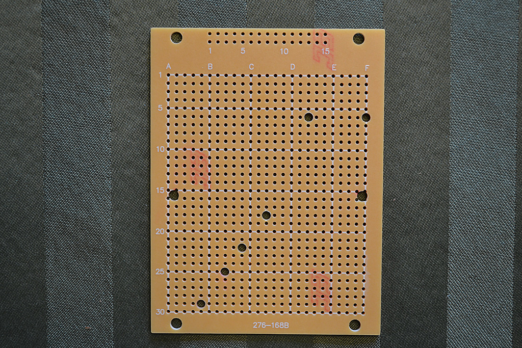

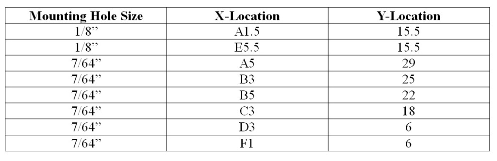

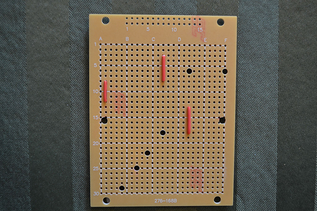

It’s now time to drill the mounting holes in the new Radio Shack PC Board. This PC Board is laid out in a grid with the x-axis numbered A1 – A5, B1 - B5, C1 – C5, D1 – D5, E1 – E5, F1 and the y-axis numbered 1 – 30. There are silk screened lines located at five hole intervals in both the horizontal and vertical axes. There are two types of mounting holes: 1/8” holes for attaching the new Radio Shack PC Board to the original crossover PCB and the terminal cup standoffs; 7/64” for the wire ties that will be used to mechanically restrain the two 0.5mH air core inductors. You will use the two of the factory drilled mounting holes at the bottom left and bottom right corners of the PC Board. So, only two new 1/8’ mounting holes are required. There will be a total of six 7/64” mounting holes, four for inductor L2 and two for inductor L3.
Table 1. Mounting Hole Locations
I used 7/64” mounting holes for the small wire ties I used to attach the inductors to the PC Board. If you have different size wire ties, or don’t have a 7/64” drill bit, you can use a 1/8” drill bit for all mounting holes.
Be careful when drilling the 1/8” mounting hole at location A1.5, 15.5. You don’t want to completely sever the copper trace on the back side of the PC Board at location A1. This is the GND trace. If you do completely sever this trace, you can install a jumper wire to bridge the gap.
Photo 9. The New Radio Shack PC Board with all Mounting Holes Drilled

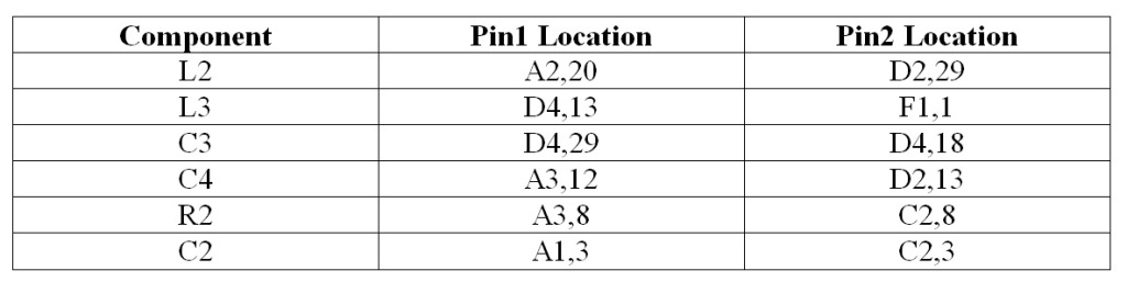

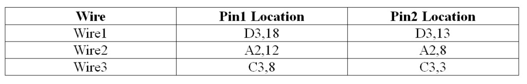

Install 22 AWG jumper wires between the following locations:
Table 2. Jumper Wire Locations
Solder all wires in place on the back side of the PC Board. After soldering, trim all leads as short as possible on the back side of the PCB. There will only be a 1/8” gap between the new PC Board and the original crossover PCB. The leads should be clipped short enough to prevent creating a short circuit between the two PCBs.
Photo 10. The New Radio Shack PC Board with Jumper Wires Installed

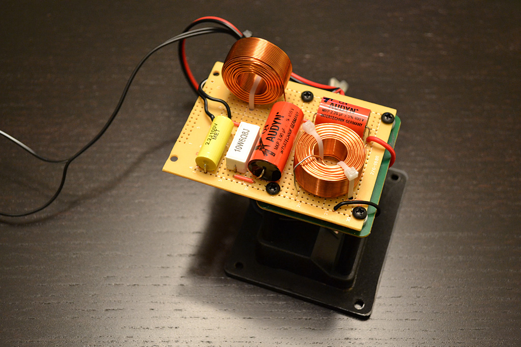

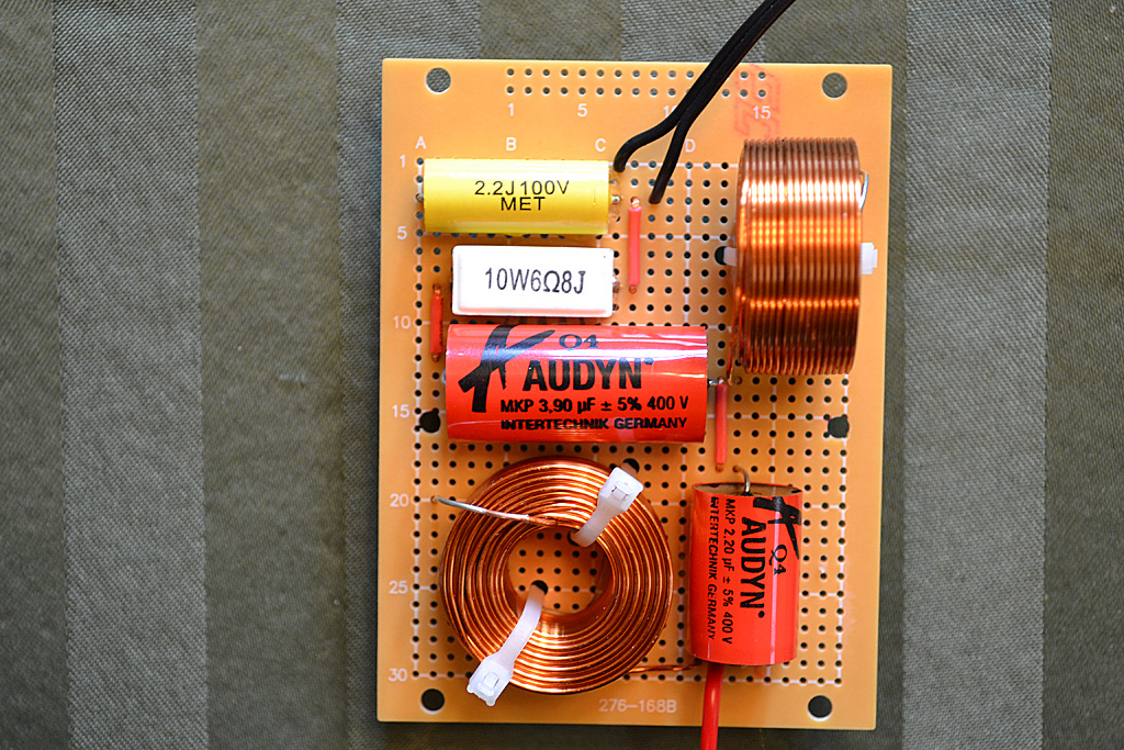

Install crossover components L2, L3, C2, C3, C5 and R2 on the PC Board at the following locations:
Table 3. Crossover Component Locations
Use a generous amount of hot glue to attach these components to the PC Board. Install wire ties to help mechanically restrain the inductors and cut off the excess length of the wire ties. Solder all leads to the back side of the PCB and trim all leads, except L2, Pin1 as short as possible. Leave the L2, Pin1 lead longer (See Photo12: anything between ½: and 1” is fine for now). This lead will also be soldered to the original crossover PCB when sandwiching the two boards together.

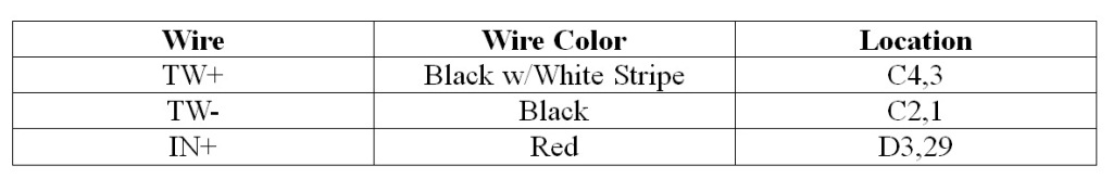

Solder the tweeter lead wires and input lead wire IN+ at the following locations:
Table 4. Lead Wire Locations
Photo 11. The New Radio Shack PC Board with All Components Installed
Photo 12. The New Radio Shack PC Board with all Leads Trimmed – Except for L2 Lead at Location A2, 20

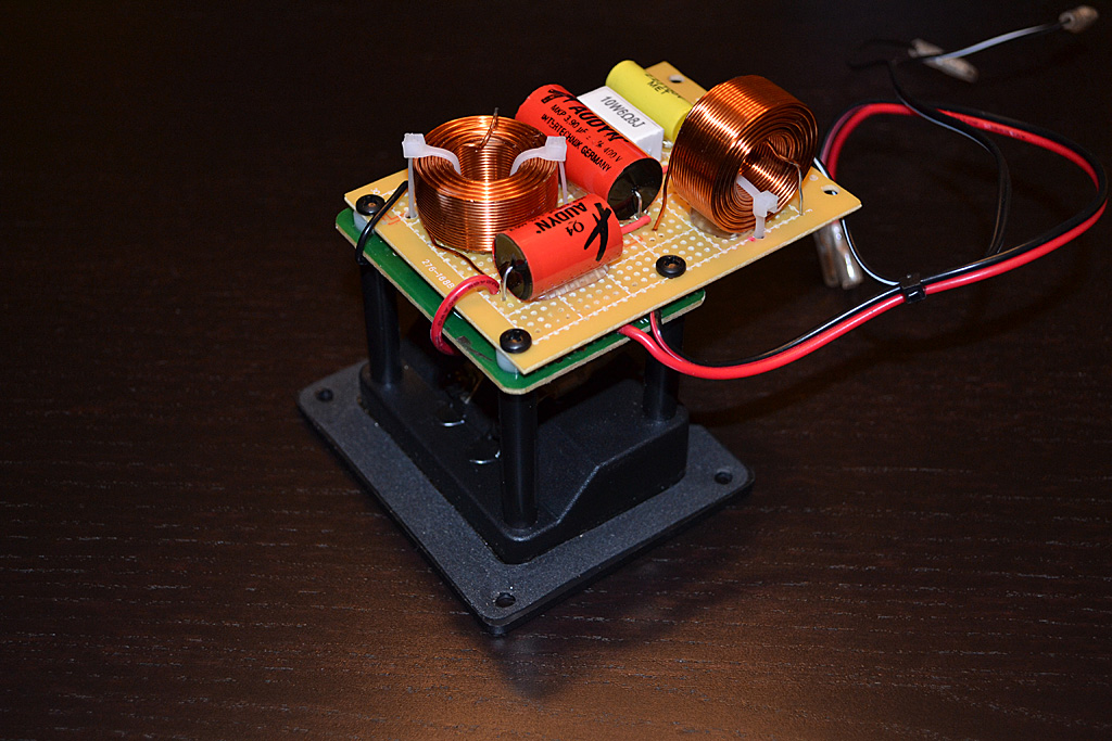

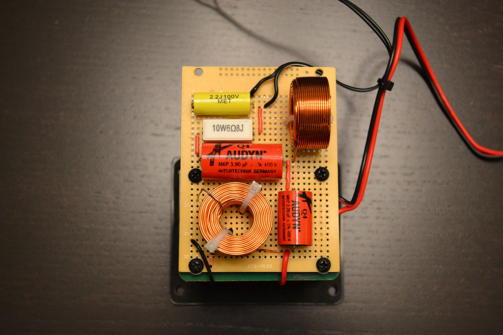

It’s now time to sandwich the old, original crossover board and the new Radio Shack PC Board together. You will need to install one short jumper wire to connect the GND signals of the two boards. This wire connects to the IN- location on the original crossover and the ground trace on the Radio Shack PC Board. I connected this wired to location A1, 27 on my boards, but it can be connected to any A1 location. I looped this wire around the bottom of the boards, rather than the side, to make it easier to get the new crossover through the terminal cup opening when reinstalling it into the cabinet. This is the black wire shown near the bottom left of the board in Photos 13, 14 and 15.
Sandwich the two boards together, with the 1/8” nylon spacers between them. Doing so will require the long inductor L2 lead to pass through the IN+ via on the original crossover board. Solder this lead to the bottom side of the via and then trim the excess lead as short as possible. Connect the IN+ and IN- leads to the appropriate terminals on the terminal cup.
That completes the electrical assembly of the new crossover. It’s now time to complete the mechanical assembly. Again with the 1/8” nylon spacers between the two boards, install #6 x ¾” mounting screws at the four 1/8” mounting hole locations. Using the #2 Phillips screwdriver, drive these screws into the four plastic mounting posts on the terminal cup. Once these screws are tightened the mechanical assembly of the crossover network is complete and your crossover should look similar to the one shown in Photos 13, 14 and 15.
Photo 13. The Assembled Crossover – Top View
Photo 14. The Assembled Crossover – Left ¾ View
Photo 15. The Assembled Crossover – Right ¾ View
