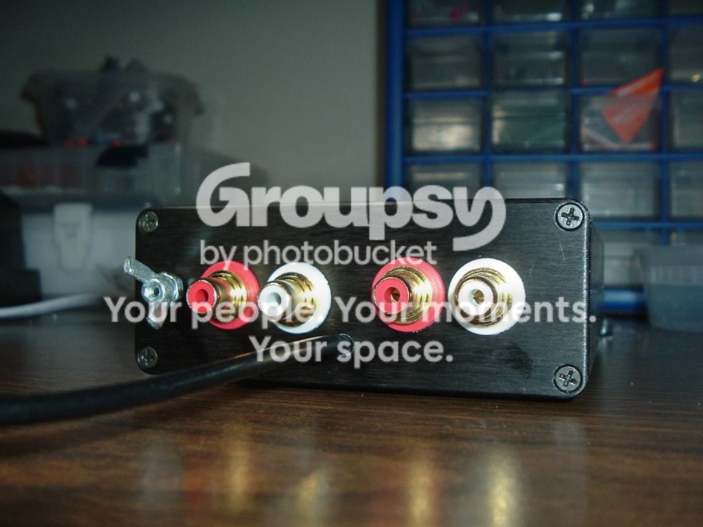

I pulled the RCA's and power leads off last evening as I bought a nice case for it at Fry's. I have all the RCA's, switch, LED and ground screw installed. Just need to put the board in this evening and wire it up.
I am going for the 4 x 6v lantern batteries which will be in another box out of sight, I got some 3 pin molex connectors on the cable at the battery end.
I told myself I am not going to mess with other components and op amps and will leave it as is. Well that's what I told myself.:D

Pics of the case I bought at Frys, it turned out quite well, not as professional as some but my first attempt at putting something I made in a proper case.
I used some plastic plugs for the stand offs, I just drilled holes in the bottom of the case and used short screws to secure them in place. The board just clips on and off. I am using 4 x 6v lantern battery's to give it +12v, 0, -12v so it should go for a long time. I think it sounds slightly better than the twin 9v's, which is amazing to say the least.
I used some plastic plugs for the stand offs, I just drilled holes in the bottom of the case and used short screws to secure them in place. The board just clips on and off. I am using 4 x 6v lantern battery's to give it +12v, 0, -12v so it should go for a long time. I think it sounds slightly better than the twin 9v's, which is amazing to say the least....

Would a Pyramid PS-3KX work as a power supply with this phono stage?
It would power it but I am not sure about the noise, when you use lomc carts you need a well filtered quiet supply to avoid noise and hum.
I prefer batteries for this reason as you have both low noise and no hum, but that's just me.
I have one that I'm using with a V-LPS, I may try it, and if it's noisy I'll go with batteries.
