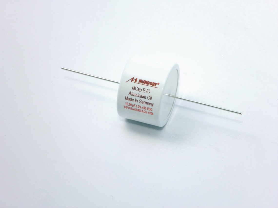

I've experimented with a number of different capacitor brands, and I agree 100% with @homebrew, capacitor differences are real and audible. Sometimes subtle, and other times very obvious, depending on the person or the system. Of the brands I've tried, I like Mundorf the best. Their EVO Oil caps are very transparent and open in sound, with an expansive soundstage.
