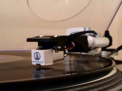

I have a new turntable that doesn't have antiskate setting option (the antiskate is pre-set for the included Audio-Technica AT3600L stylus/cartridge)
I replaced the default AT3600L with a Audio-Technica AT-VM95SH
The Audio-Technica AT-VM95SH vertical tracking force is rated at 1.8 - 2.2 grams
To prevent skating outwards it seems I have to set it to about 3 grams
Is this too much?

High tracking force will not damage a record if the cartridge/stylus are designed for it.
High tracking force may damage your records if the cartridge/stylus were not designed for it.
Using higher than the maximum recommended tracking force may also damage the stylus suspension.
It sounds like your tonearm bearings may not be sensitive enough to track at lighter tracking forces. I would put the original cartridge back and set it to the max recommended.
It's an Argon Audio TT Mk2 turntable
I guess it's a rebranded Pro-Ject Debut Carbon EVO
It doesn't have antiskate setting and was calibrated for the AT3600L that was on from the shop
The AT-VM95SH should be about same weight tho, I think
I may be setting the baseline (zero) weight wrongly though..
When finding and setting the 0 should the tonearm float freely a lot above the holder or just slightly above but still "on it"?
Confused by skating outwards. Skating is an inward force. Not sure what you are describing. The VM95SH should track fine at about 2 grams. The anti skate on a shibata is normally higher than a conical or eliptical at the same tracking force. It is okay to have lower anti skate.
Do you have the manual? All the Argon and Pro0ject tables I looked at have antiskate adjustments - Hanging weight type and manual shows how to adjust it.
The tone arm is setup by rotating the weight until it is balanced, then moving the plastic scale to zero, and the tonearm should still be balanced. Then rotate the whole counterweight to the desired weight.
The antiskate is a hanging weight, and should hang over a rod with notches on it. Again, explained in manual. Pro-ject even has a setup video.
AI thought it was a "rebranded Pro-Ject Debut Carbon EVO". It's not
And it doesn't have anti-skate user setting possibility. So it's fixed to 3-4 grams (for the included stylus AT3600L) and 2 grams is not good, so the VM95SH cannot be used
Now I'm back on the included AT3600L and it sounds fine
I'd sell the AT-VM95 and then buy a cheap new AT3600L and mount it. They can be had for around $20USD (or less). That record player is specifically engineered for the AT3600L cartridge and presumably uses anti-skate preset for that cartridge. This would explain the arm wanting to move out when trying to set lower VTF for the AT-VM95.
Also, the AT3600L is a conical and conicals can track at much higher VTFs without damaging records. Also, many of us prefer the conical sound. I personally have chosen to run an AT-91, a lighter tracking version of the AT3600L also with a conical tip, on my main turntable even though I have multiple other cartridges in a drawer here, including an AT-VM95SH.
You'll come out dollars ahead and gain proper function and great sound by simply reverting back to the AT3600L set to 3-3.5g. It's a great sounding cartridge and one of the few genuine bargains left in HiFi.

The OP's Argon Audio TT MK2 does not have the thread and weight antiskate system that the prior Argon TT had. The older model actually included a protractor to help set up a different cartridge should the owner wish to do so, but the MK2's manual has a note saying, "While it is possible to replace the cartridge, it is not recommended. The turntable comes configured with a standard cartridge, and using other cartridges might result in improper functionality."
