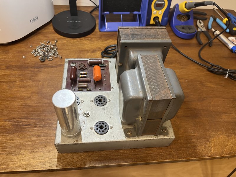

This is what I'll be working with (or at least one of them):

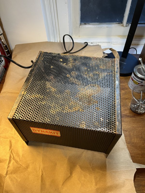

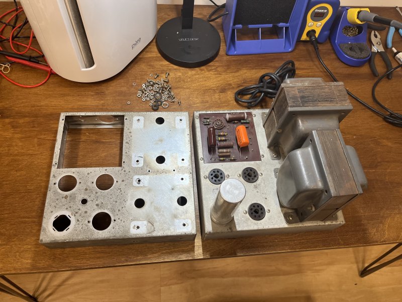

Here we have a side-by-side after I stripped one of the units of all its components:
Nothing much to look at from the back:

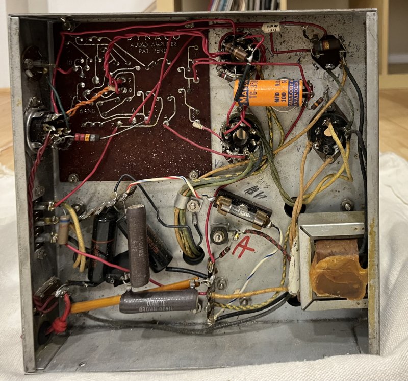

The inside of one unit (with a choke); notice the choke placement is on the side, which is different from what you normally see in a Mark III unit:

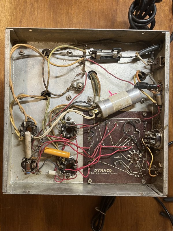

And the inside of the other unit (currently without a choke):
Finally, one of the bottoms:

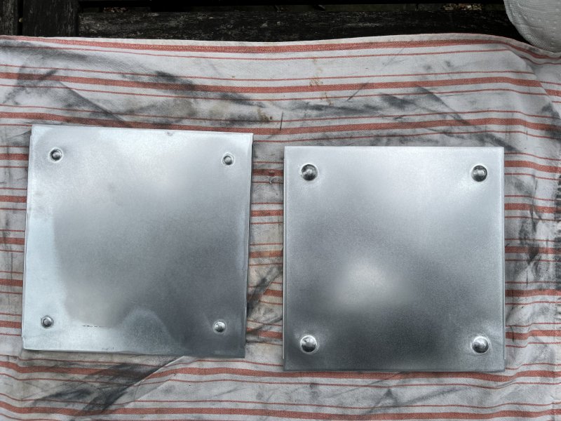

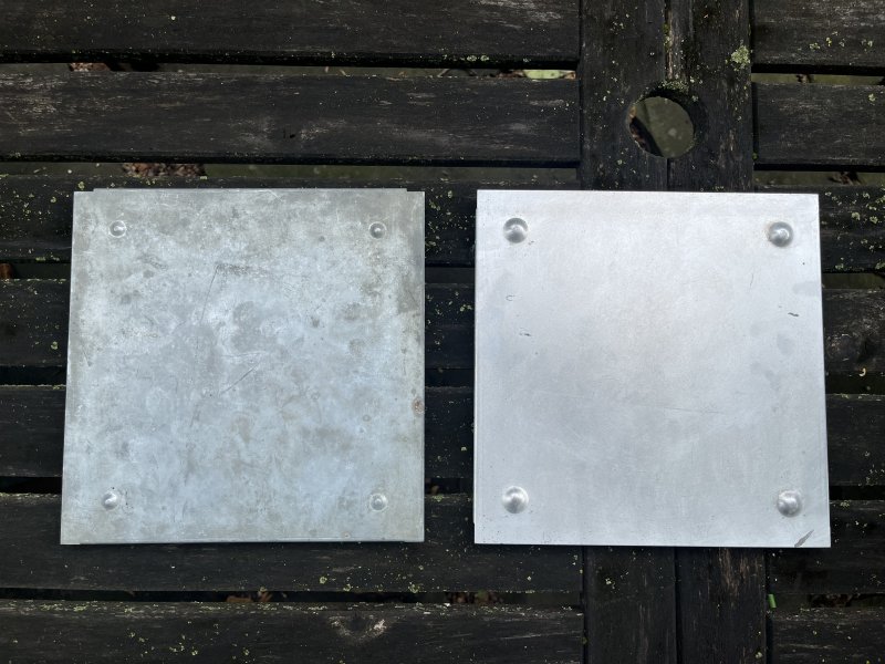

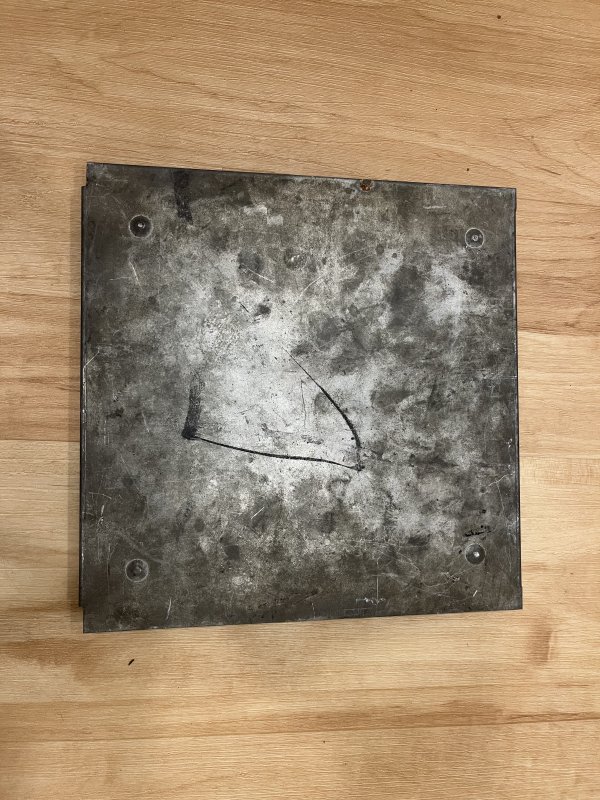

I initially thought that the chassis was stainless steel. Thinking that, I first soaked the bottom plate covers in a sink with dish detergent and scrubbed off the surface dirt and grime. I followed that with a deeper clean using Barkeeper's Friend. The bottom covers still had a lot of work needed so I took out my sander and gradually progressed from 240 grit sandpaper, to 320, 400, 600, and finally to 800.
The photo compares a washed (soap + Barkeeper's Friend) bottom plate cover on the left, with a sanded one on the right:
And here's a side-by-side after I finished sanding both:
I soon realized that I was working with galvanized steel rather than stainless steel and the blemishes are areas that still had the original zinc plating or where it had eroded over time (or I had sanded off).
Having realized that these were zinc plated, I have decided to take them to a local electroplating service provider near me. I should be getting those back in a week or two.

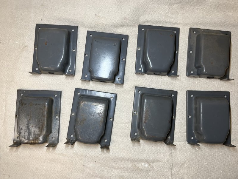

Transformer End Bells (Covers)
Up next we have the transformer end bells, or covers.

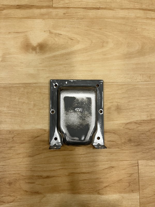

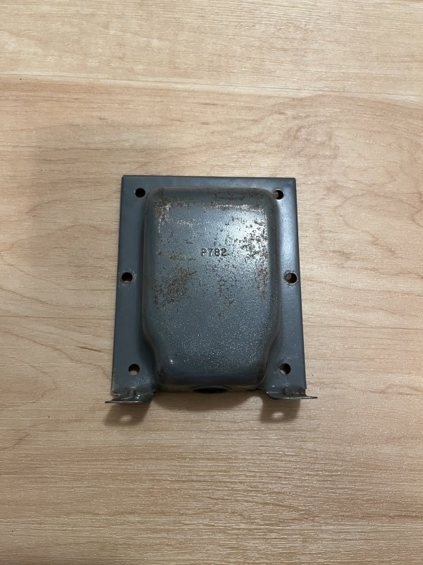

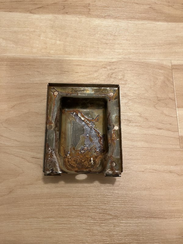

Here is what they looked like on the outside:

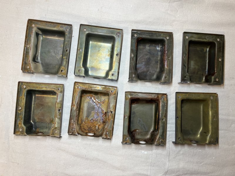

And from the inside:

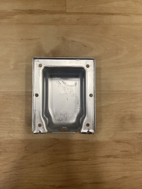

Here's a close up of the gnarliest looking on:

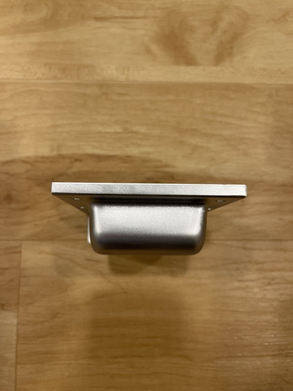

My plan here is to paint them a metallic (anodized) blue, specifically Dupli-Color's MC201 Blue Metalcast. I have a 3-year-old who loves tinkering and helping me with electronics. I asked him if he'd wanted to have these in his house one day and he emphatically said "Yes!", so I've let him pick out the color.
To get good results with Dupli-Color's metalcast paints, you need either a shiny or chrome finished surface. I opted for the latter and spray painted these end bells with Rust-Oleum's Metallic Silver finish (#340648):
Outside:
Inside:

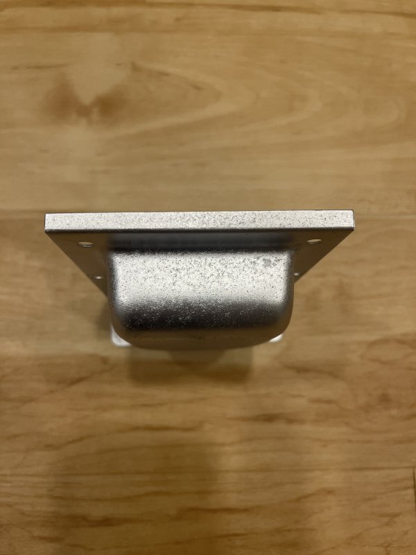

I tried to take a shortcut and didn't bother sanding these down. Big mistake, especially when seeing these from the top:
So I took out the sander and gave each of them a quick pass:
And then re-applied the Rust-Oleum Metallic Silver:
Huge improvement (as one should have assumed)!
Next up on the to-do list for these is to apply the Dupli-Color metalcast paint. Stay tuned.

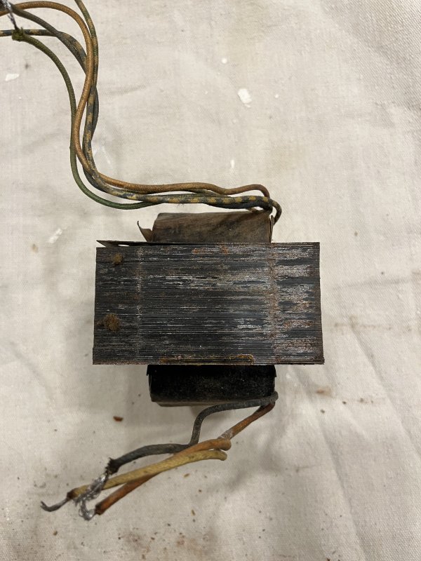

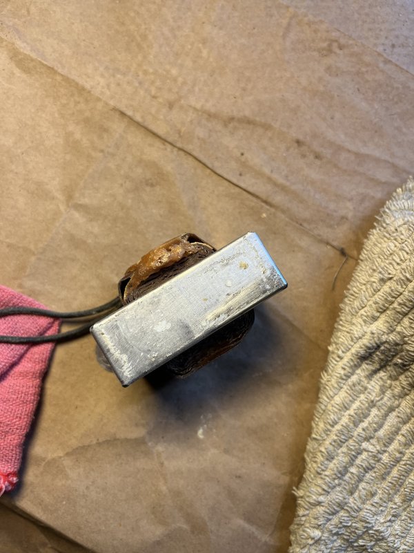

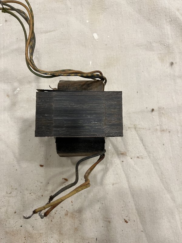

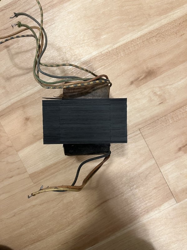

Some of the transformers looked better than others, so I decided to give these a touch up while the end bells were off. Here's an example of one of them:
Before:
After a quick wire brush:
After applying Rust-Oleum's Flat Black Protective Enamel (#7776730).
I opted for this oil-based paint as it was at my local hardware store and others had recommended it for transformer touch-ups. However, the label says not to apply to surfaces that exceed 200°F, so hopefully that'll never be the case with these transformers.

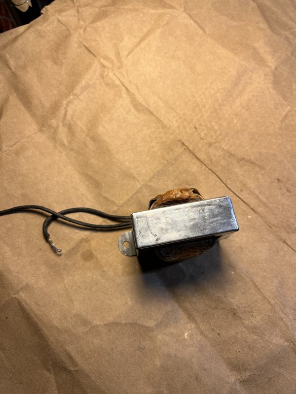

I also touched up the existing choke. Didn't really capture good photos of this but here you go:
Before:
After:

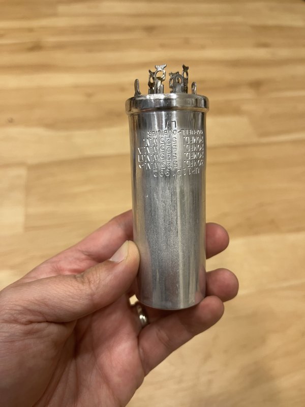

And since I'll be keeping the quad can capacitors mounted on the units, I did a quick polish of these using my Dremel and Parker & Bailey's Stainless Steel Polish. You can see the difference here in the small area at the top of the photo (...bottom of the cap).
That sums up where I am so far. I'll update this thread as I make more progress. However, have a baby on the way in a matter of weeks so it may get quiet for a spell between parenthood and the gradual purchase of components.
I'll be installing Triode Electronics' SDS Labs power supply boards.
However, I haven't yet decided what to do about the driver boards. The PCBs are original and look to be in pretty good condition.
Is my money better spent on recapping the original PCBs with higher quality components (e.g., Mundorfs), or am I better off (sonically and money wise) moving to Triode Electronics' modern capacitor board (their stock resistors as well as the upgraded Solen caps)?

Looks like at least one of your amps is a Mk2 rather than a 3. One of the pictures shows only 3 terminals for speaker connections. The Mk2 only had 8 and 16 ohm speaker connections. Looks like it may be the early version with the larger circuit board. I have a pair of these, one of which has the larger PC board. I made closure strips to allow for use of the modern size boards. Can't see the output transformer part numbers in your pictures. Nice start so far. What are you planning for the chassis finish?
Very nice resto so far. I would use good quality caps such as Orange Drops, or good metallized film Panasonics, etc. I would not spend excessive money on boutique caps. Many rebuilds have had excellent results with "normal" parts.
Thanks for the feedback. Will keep this in mind.
Correct, one of the units was orginally built as a MKII (hence, no choke).

Looks like they both have the earlier and wider PC boards. My pair is one each so I closed up the wider opening so I could use the same boards in both. I used a shim of the same material on the right to keep the board level.
The Mk ll also used EL34s rather than KT88s, which will typically perform better than 6550s.
