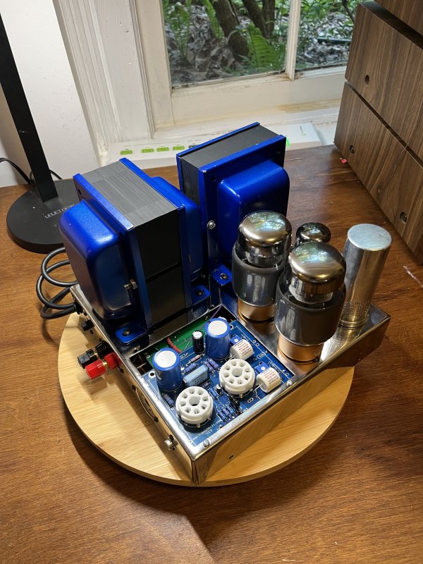

The blue bell caps have won me over with time. They have a nice pop to them. Here's a photo of a partly built unit:

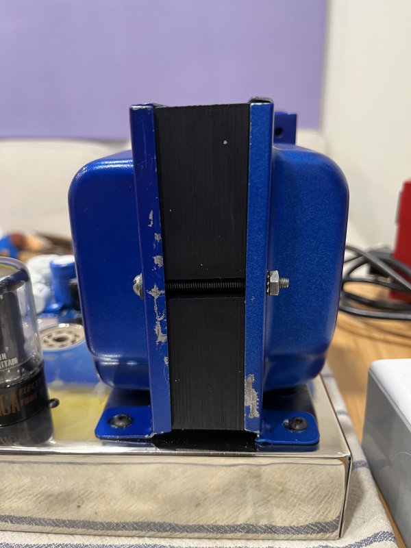

I probably should have sprayed additional layers of a clear protective coat. The Dupli-Color Blue Metalcast hasn't been very robust. It's chipped away on the top of the units just from handling it as I move it on my workbench. The side of this one didn't stand up too well against the protective cage:
Minor aesthetic annoyances that I don't be bothered correcting at this time.
Bit of a bummer but I still have a few issues to work out.

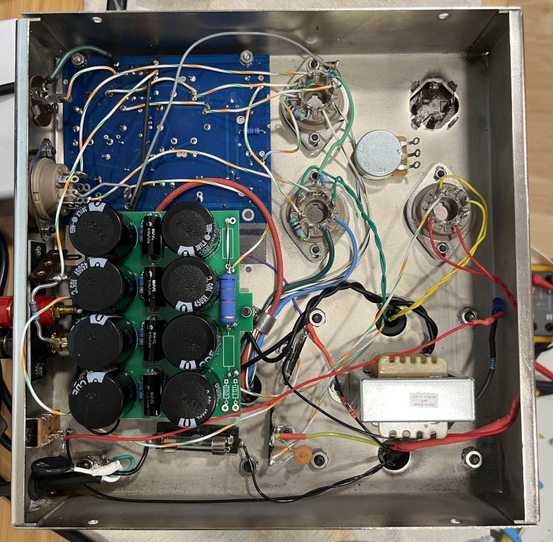

When hooked up to a variac + dim bulb tester, the bulb becomes very bright when I hit 70 vac. Need to figure out where a short circuit might be.
If anyone has put together a recent tubes4hifi 6SN7 board with an SDS Labs power board (or is just far more knowledgeable than I am), feel free to offer any suggestions.
I think I have an unnecessary jumper on the PCB (between the two 6SN7 sockets), though I don't think that would be the issue.

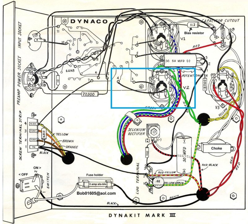

I'm also a bit unclear on v2 pin 4. The original layout had a connection between Pin #4 on the PCB and V2 Pin #4. I'm guessing the 6SN7 driver board doesn't need this connection but there's no explicit instruction on this in the notes I received from tubes4hifi. Highlighted this on this diagram:
And here's a recent photo of the interior connections:

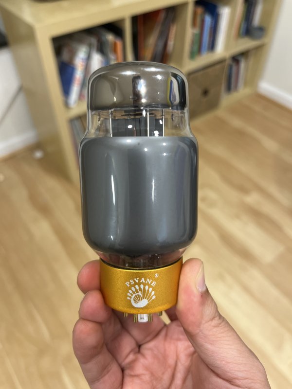

For the KT88s, I went with their newer KT88, i-T series:

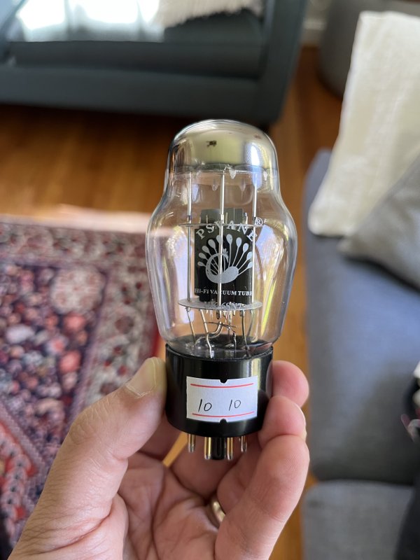

I went with the UK series 6SN7 tubes:

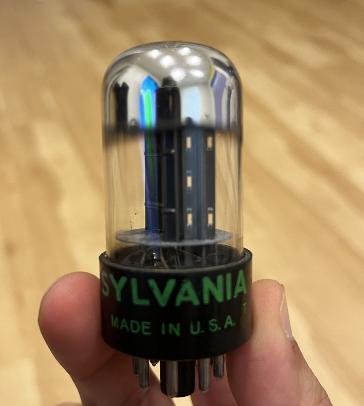

Unfortunately, it didn't occur to me to measure the spacing on the new driver board. The shouldered glass means they can't sit side-by-side on the PCB. Oops! I ultimately ended up buying a lot of well maintained Sylvania. Nothing fancy, but at least functional.
