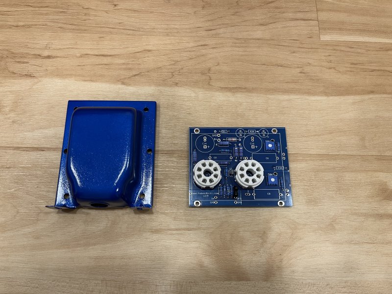

My plan here is to paint them a metallic (anodized) blue, specifically Dupli-Color's MC201 Blue Metalcast. I have a 3-year-old ... I've let him pick out the color.
pe
To get good results with Dupli-Color's metalcast paints, you need either a shiny or chrome finished surface. I opted for the latter and spray painted these end bells with Rust-Oleum's Metallic Silver finish (#340648):
And then re-applied the Rust-Oleum Metallic Silver:
Next up on the to-do list for these is to apply the Dupli-Color metalcast paint. Stay tuned.
Finally got around to applying the Dupli-Color Blue Metalcast. Can't say I love the color (at least right now) but my son does.
I ended up going with tubes4HiFi for the driver board. While not a perfect match, they certainly complement one another.

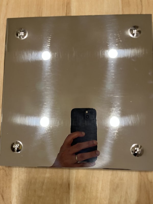

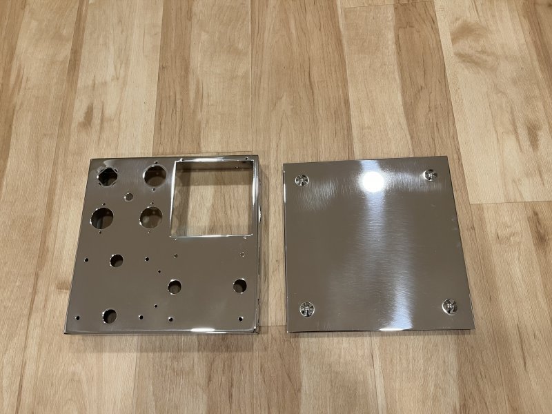

Quick update:
I got the two chassis back from the replating service. Really pleased with how they came out.
Before:
After:
Thanks for sharing and looking forward to the finished product along with an assessment of how they sound.
