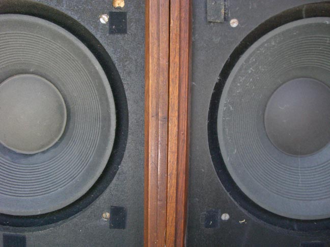

Possible to post a closeup pic of both surrounds?? My 60E's are not ported and have rubber surrounds that are 2-3 times as thick as on my Infinity Qe woofer, or any other rubber surrounds that I've seen.

Here you go. Pic on left is unsealed. Pic on right is sealed. It's easy to see the difference. You can see right through the unsealed surround and I imagine air passes easily through it. The sealed surround looks like a factory applied sealant and doesn't appear to be porous much at all.
I'd be inclined to go ahead and seal the one that isn't sealed already. Just use something that stays very flexible.
I can see that equalizing the difference between the woofers. A leaky surround can act to upset port tuning... it'll raise the effective port frequency, which will cause a midbass peak and a low bass rolloff at too high of a frequency...
It's as if they neglected to seal it.
Both of mine are the unsealed surround. A penciled date of 1/63 and a few other notations is on the back of each cone, near the surround.

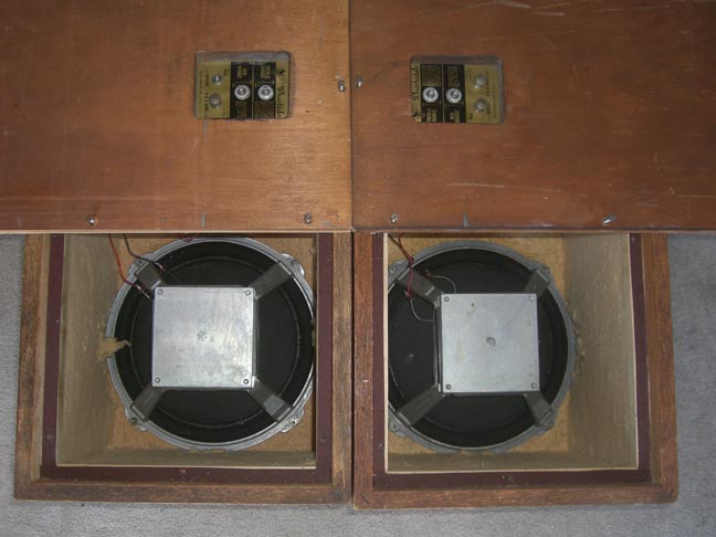

I have some Wharfedale W60's or 70's (not sure which) I could pull the woofers from and photograph for you tonight for comparison if that would be helpful.
HI, Wiredguy!
Yes, the surrounds up close and a rear view of the basket and magnet, particularly, and whether the boxes are closed or ported.... :thmbsp:

I remember one time Zilch telling me that even vented cabinets need to be well sealed because you want all the air displaced by the woofer going through the vent tubes. It just didn't make sense to me that having one Wharfedale woofer with a sealed surround and one that was unsealed would not make a difference in frequency response between the two speakers.
So.......I sealed the unsealed woofer surround with Elmers Rubber Cement and let it dry for 12 hours. The graphs showing the FR for the two woofers are shown below. The first is a comparison of the unsealed woofer and sealed woofers. The second is both woofers with sealed surrounds.
Red trace is the formerly unsealed surround, magenta trace is the factory sealed surround in both graphs.
FYI - the factory sealed surround woofer measures 1 dB less efficient using pink noise.
Unseadled vs sealed surround results in the first graph show a 3-15 dB difference in the bass response curves. Sealing the unsealed surround reduced the bass FR response difference to ~0-2 dB. :banana: :banana:

Most excellent! :thmbsp: I wonder why the one surround wasn't sealed? Was it a replacement or mistake from the factory?

Don't think it was a mistake. The two speakers were not exact matches. One was a 2-way, the other a 3-way. That was the only difference. Think the early woofers may have just not been sealed. Harvey/GA has two with unsealed surrounds.
Wharfedale W60 Model D, 3 way, closed box, inverted cloth surrounds
