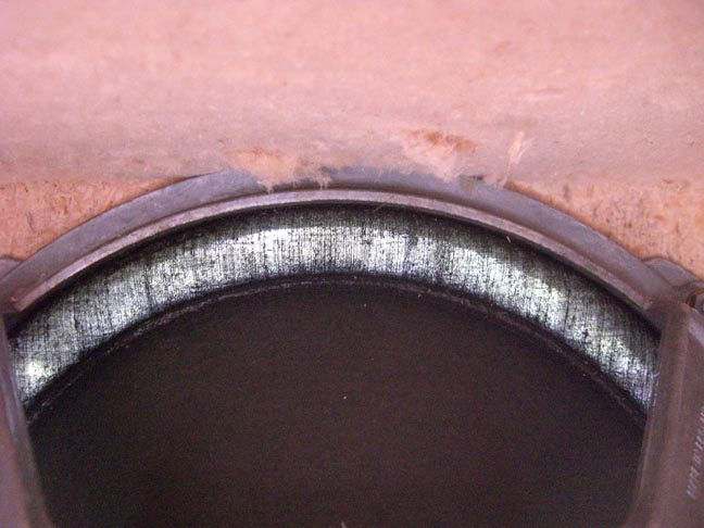

Upon further inspection, I can see the treeline directly through the surrounds. Perhaps a sealant of some kind could help these put out proper bass?
That's light shining through, not a reflection from a flash.
If I hold JBL cloth accordian surround woofers to the light, even with bitumenous goop sealing them, I can see light through.
We know that a "perfect" seal is unnecessary, even with closed-box acoustic suspension designs.
Measurements may provide an unequivocal determination... :dunno:

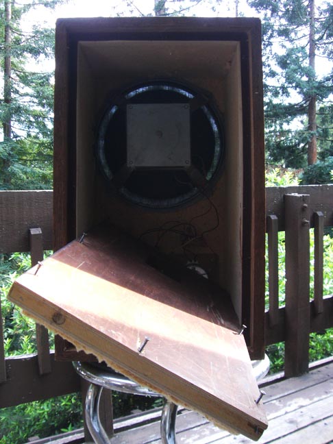

Wharfedale W60 Model D, 3 way, closed box, inverted cloth surrounds
Hmmm...you say they're open cloth surrounds on the woofers??
The woofs on my 60E have the square magnet motors, but very thick (compared to most rubber surrounds) surrounds with an inside roll like some L/Advents have.
I've recapped them with Dayton Polys and sealed the woofer rim with the speaker caulk and they sound great!! 'Course, I only have the Advents and Infinity RS 2001 (and a lone Qe) to compare them to. :tears:

I just thought I would mention that I read somewhere, I believe it was on "Toups's" Wharfedale information at his home site, that Mr Briggs, the founder of Wharfedale, actually preferred to leave the surrounds partially unsealed in many cases.
The fact that there are two different situations here, suggests that Mr Briggs applied this to one form of the W60s, and sealed them on the other.
And since BmWr75 wound up getting a pair of mixed up W60s from the seller, who originally had four, I'm guessing that the acoustic suspension example(W60E and above) had the unsealed surrounds, in order to help the system breathe more. And while the earlier W60s were vented, there was no need for him to leave them unsealed.
That's just my thoughts though, but it makes sense to me, since we should know that Briggs purposefully left many of his driver's surrounds only partially sealed.
