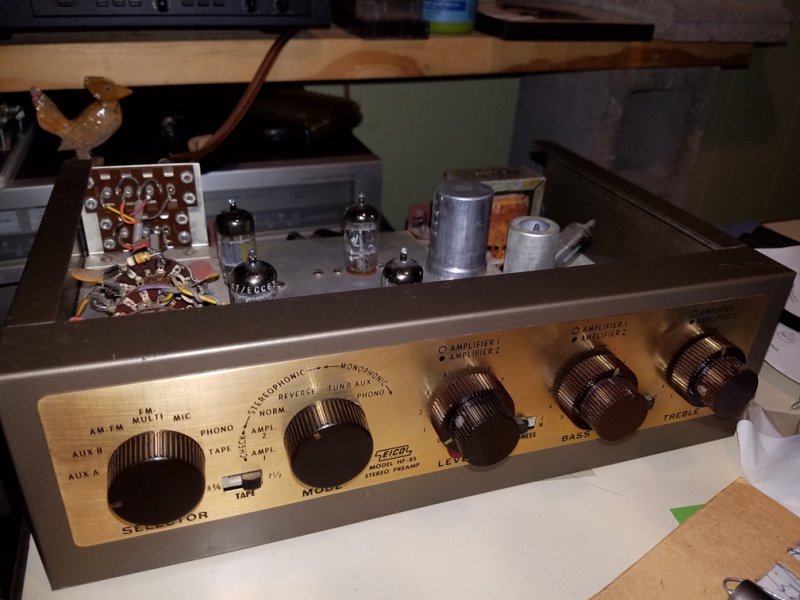

I've got a HF85 pre I rebuilt with all new parts and did some improvements, and 2 HF12 mono integ. amps 6bq5 PP.
A 3rd HF12 waiting for me to attack it.
My HF-81
