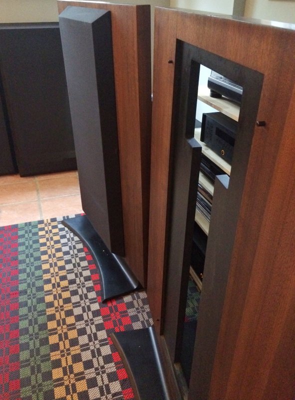

GOOD:
  • Cabinets are pretty danged good; veneer isn't showpiece, but very solid
  • Stands seem pretty good, but one leans back more than the other (I'm a perfectionist)
  • Came with all four wood-framed grilles (three with cloth)
  • Came with RCA cable wire that leads from mid-frequency AMT to high-frequency AMT
  • One mid-frequency AMT is perfect vertical movement, one is very good, needs slight adjustment
NEEDS WORK:
  • Did not come with Heil AMT (I have brand new AMTs for my ESS AMT-1a pyramid rebuild)
  • Did not come with Heil AMT brackets

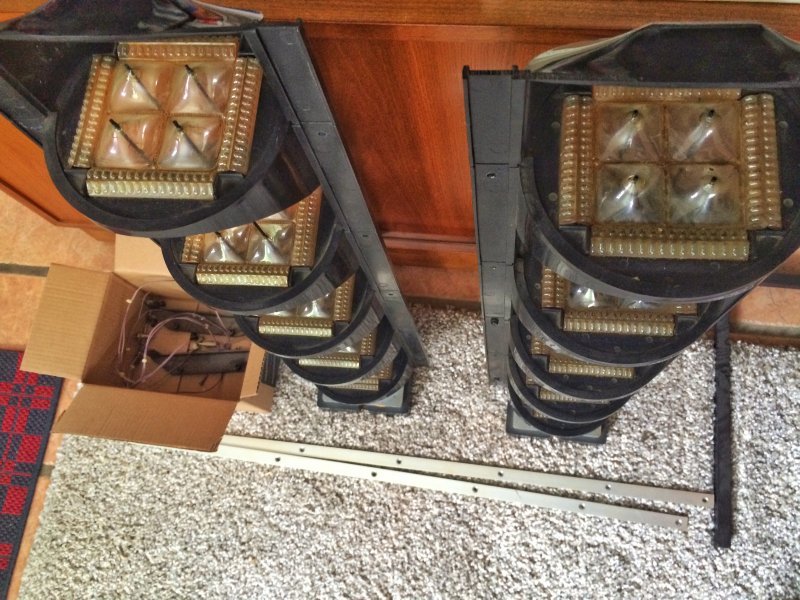

  • The mid-frequency AMT (center, vertical array) is missing some mounting screws
  • The mid-frequency AMT (center, vertical array) is missing two silver, vertical metal mounting strips
  • Did not come with two 5-pin XLR connectors
  • Did not come with Transar/atd crossover
  • Did not come with Transar/atd amplifier(s)
  • Did not come with separate Transar "subwoofer"

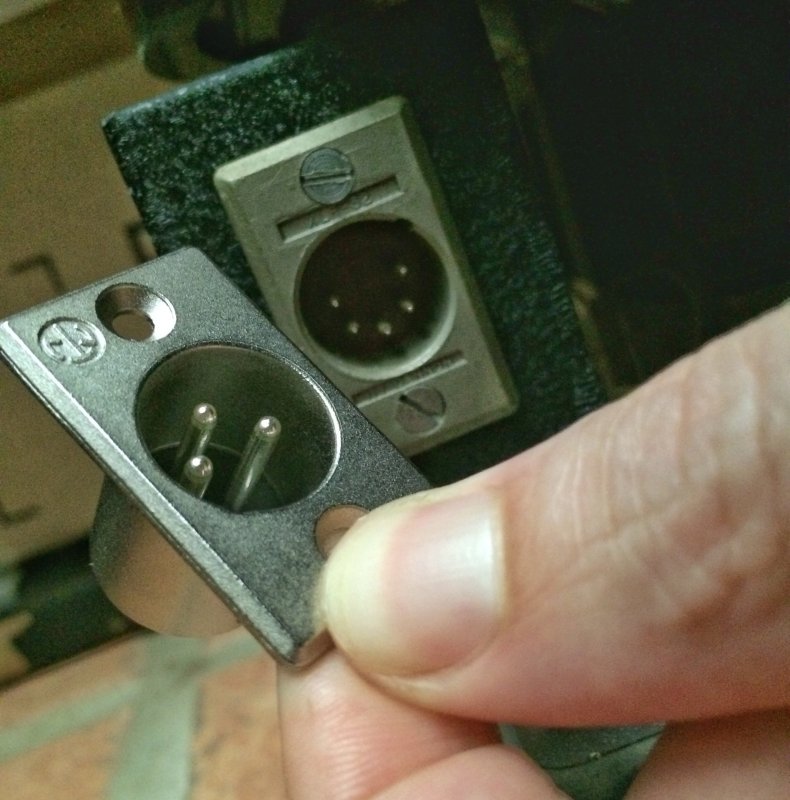

  • Change Transar 5-pin male XLR to 3-pin male XLR
  • Buy two female XLR-to-RCA cables

I am friendly with ESS' CEO. We've talked many times since I bought these. I've just purchased the 3-pin XLR connectors and XLR-to-RCA cables. This time next weekend I *may* be able to produce sound. We'll see.

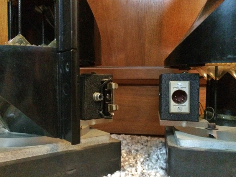

The mid-freq, vertical transar AMT and the Heil AMT are connected via a male RCA cable. The other end of the RCA cable are two small leads, the familiar blue and pink wires that plug into the back of the AMT (the one we all know and love). So, I cannot individually power just the high freqs and just the mid freqs with an active crossover like I wanted (my ESS Eclipse which is fixed at 800hz, or something like a DBX). Nor is there a regular, passive crossover. I can only amplify the unit together, which comprises the frequency range from 150hz-20,000khz. Add in an active subwoofer, controlled by XSP-1 pre-amp, and I have full range.
Now, what about all the 5-pin wire hoopla?

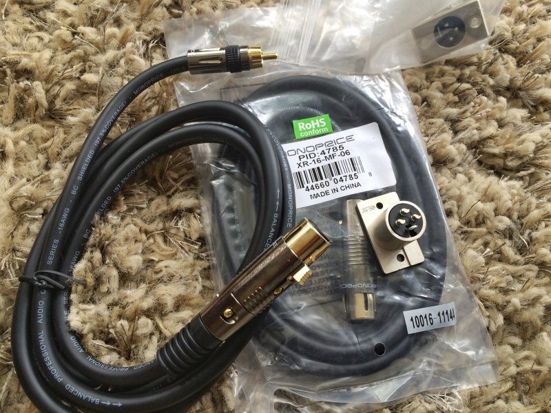

Connectors and wires came yesterday. I spent $27 including S/H.

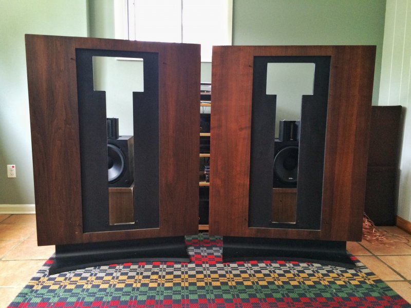

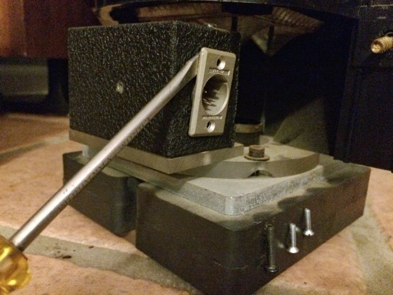

Here's what it looks like now (these are two Transars, the front of one, and the back of another, showing one side of each):

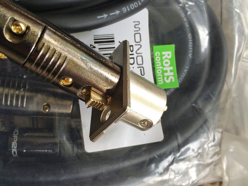

Here is the 3-pin XLR connector (this connector is upside down, two pins up top, third down bottom) that I will solder in place of the 5-pin:
Here is the XLR connector to the XLR-side of the new cable:
Here are the XLR-to-RCA cables + XLR connectors:
One potential change? Now that I don't need to plug into a crossover, I don't need the RCA-end of the cables. I may as well just buy a new set of XLR-to-XLR cables since my XSP-1 will accept them.
OK, what am I missing?
If the Transar and the Heil are paralleled together, what protects the Heil from the sub-750Hz material going to the Transar? They either have to be separated and fed the appropriate material via an active crossover OR there needs to be a minimal passive crossover, like a capacitor in series with the Heil.
Also, if you're converting a 5-pin canon plug to a 3-pin canon plug, what's to become of the extra two wires? What were those extra two wires? I understand the demotion of a balanced XLR connection to an unbalanced RCA plug - the system can survive quite well without that extra "balancing" cable, but what do all five wires in this setup go to?
Also, if you're converting a 5-pin canon plug to a 3-pin canon plug, what's to become of the extra two wires? What were those extra two wires? ...but what do all five wires in this setup go to?
I'm on a bad assumption perhaps. My research prior to purchasing the connectors and cables was that the 5-pin XLR cable doesn't actually have five wires. Tried to pull the connector off last night, but it's pretty taut and I don't want to snap the solder joints behind the connector. Looks like I'm gonna have to disassemble the Transar mounts to gain access to the metal cover over the connector on top of the magnet structure. Took one of the three screws out of the metal cover, but can't get to the other two...

I'm still a bit lost on the 5-pin connector. The only way that makes sense is that at least two of the five pins are soldered to wires that go to the positive and negative terminals of the transar, if it's wired up like a conventional speaker. Two more pins would have to be soldered to wires that go to the Heil's pink and bluie terminals, so the should be separate.
This would make perfect sense with the amp below. The amp would actively sort the highs and mids and distribute it to the pins in the xlr connector accordingly. You would simply plug the XLR female cables into the amp and run them to their respective (Left/Right) speakers

This isn't the page I found two weeks ago, but it says the same thing re: 5-pin conversion to 3-pin. Of course, that concerns lighting. I'm no electrician. But then, wouldn't this also work?
I'll take some more photos tonight of the entire mid-freq Transar AMT, show how it's wired.
