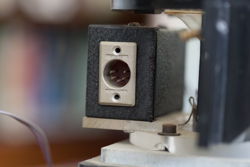

I wonder if they "got a deal" on the 5 pin xlr's and used them. Can you determine how the pins are wired?

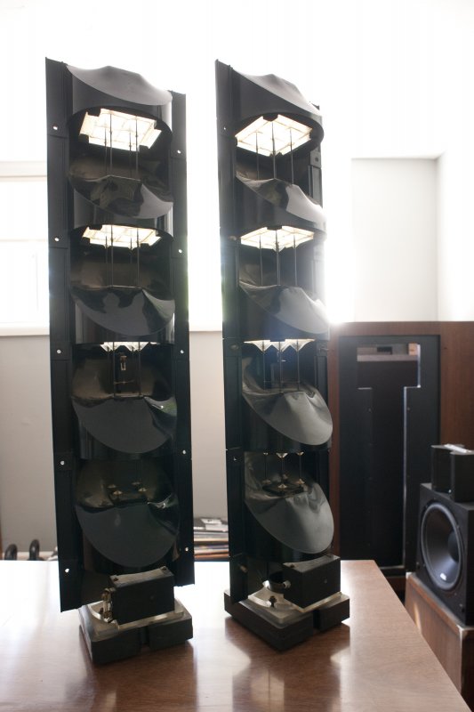

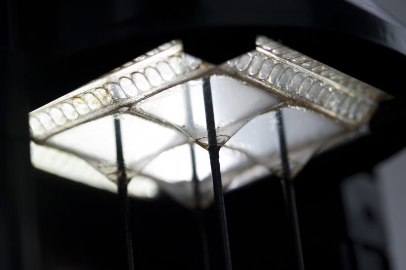

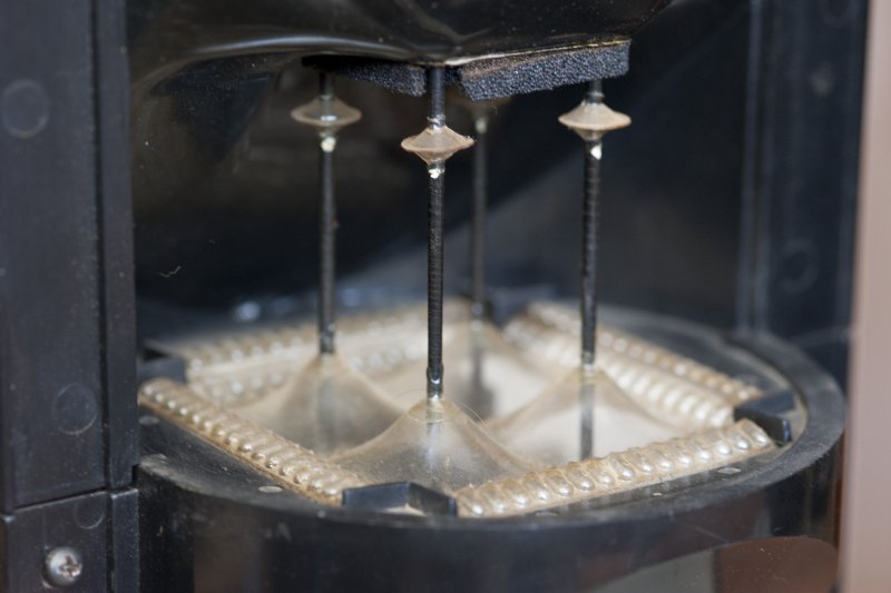

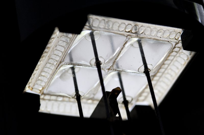

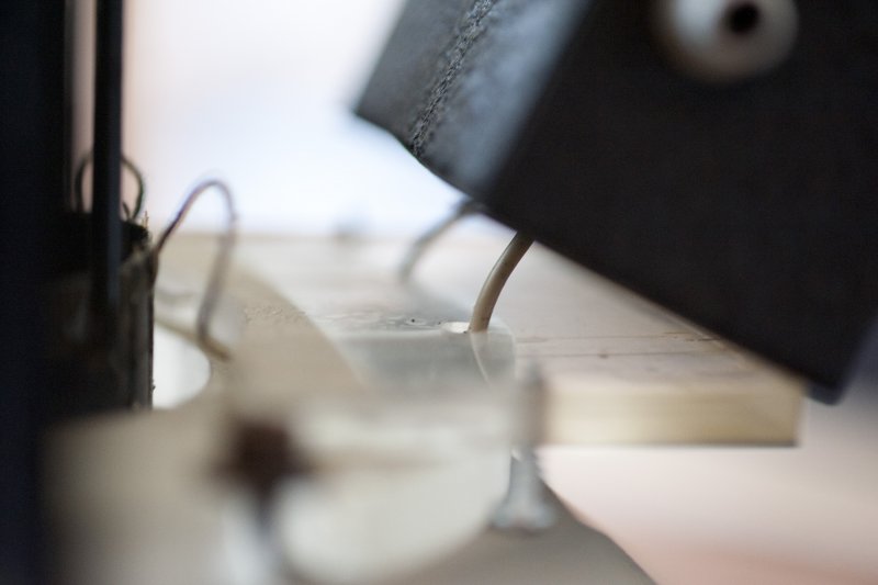

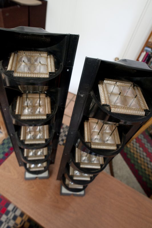

Porkloin will be happy to see these Transar AMTs are wearing some concealed protection... Apologies in advance. I busted out the D700 and macro lens, but had to keep the ISO high while handheld. Then I got the tripod out, which helped, but forgot to change the ISO back to something prettier. I shoot small, medium, and large format film, so it's been a while since I shot digital. Also, AK cropped the photos from my 3000x2000 to 800 on the long side. So, quality should be better...
Front: Back: Dirty: Clean: Clean:

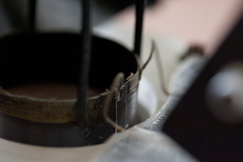

Voice coil:

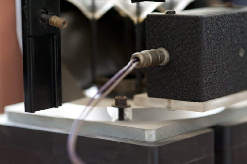

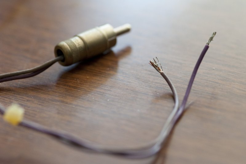

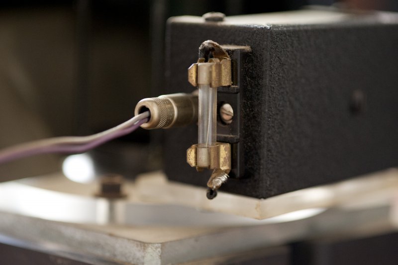

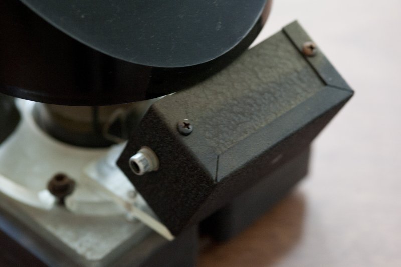

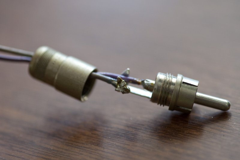

This one has a fuse??? RCA cable from Transar to Heil AMT: If you know the Heil AMT, these colors are familiar to you:

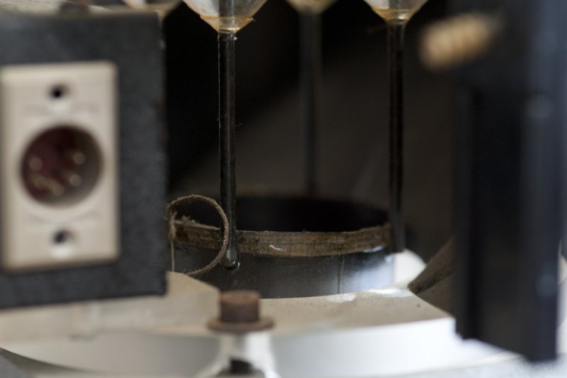

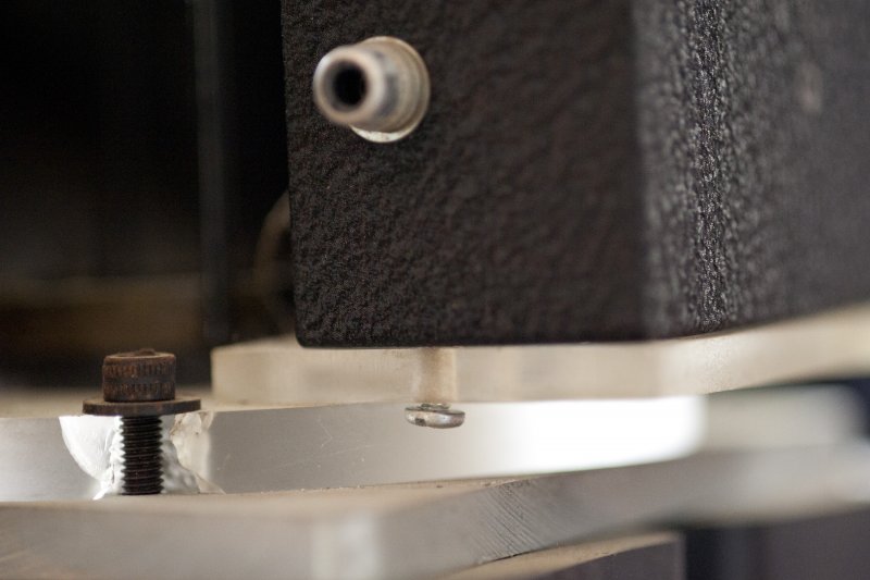

I had to pop out this screw on bottom, one on each side, to slide the box off the pedestal on top the magnet assembly

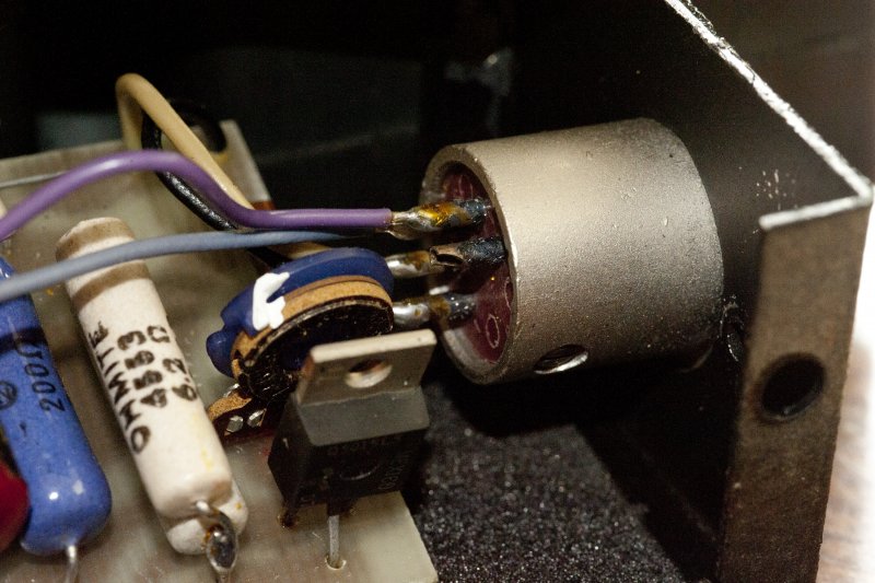

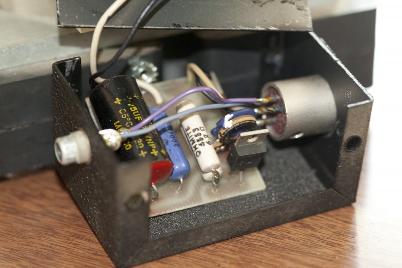

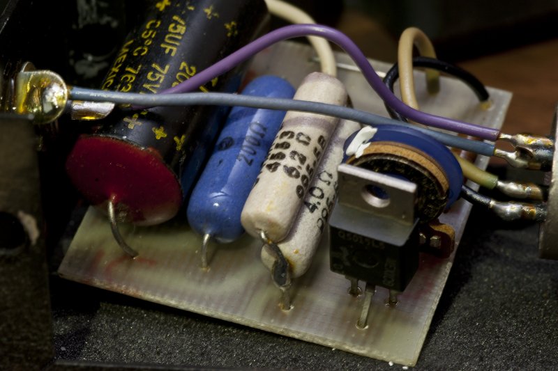

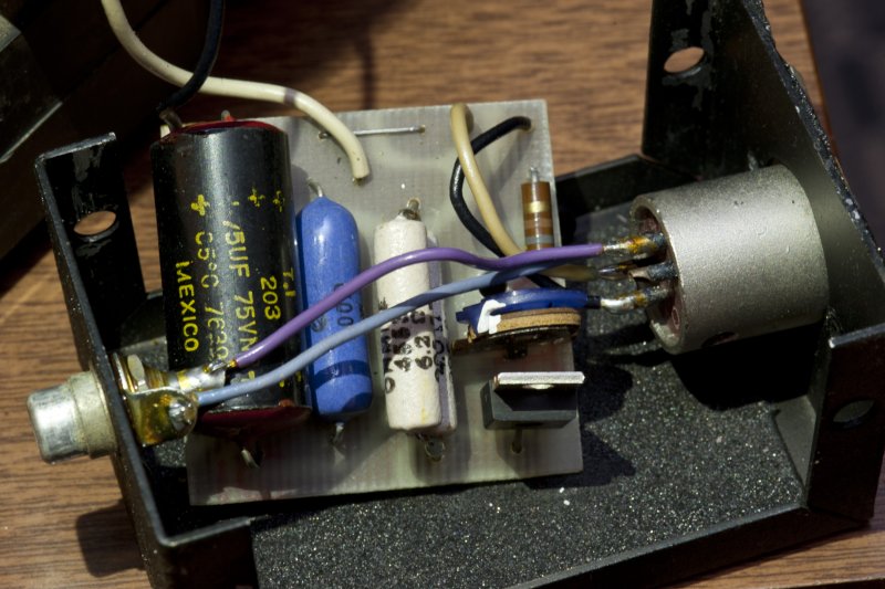

And finally, WHAT'S IN THE BOX?!
There are only four wires connected to the 5-pin XLR.
So, let's recap what Porkloin said:
"I'm still a bit lost on the 5-pin connector. The only way that makes sense is that at least two of the five pins are soldered to wires that go to the positive and negative terminals of the transar, if it's wired up like a conventional speaker. Two more pins would have to be soldered to wires that go to the Heil's pink and bluie terminals, so the should be separate. This would make perfect sense with the amp below. The amp would actively sort the highs and mids and distribute it to the pins in the xlr connector accordingly. You would simply plug the XLR female cables into the amp and run them to their respective (Left/Right) speakers."
Now what?
  1. Those red-ended Mexican caps have got to go... might as well redo the entire board... orrrrrrr, maybe a larger, custom external board?
  2. Still need to figure out XLR connectors and cables
  3. Do I still need the Transar crossover if these passive crossovers are in place?
  4. I'm looking for an affordable sub(s) that plays up to 150hz, budget about $80-100 (Craigslist)
Do yourself a favor and completely ignore anything related to DMX when it comes to XLR. DMX XLR is made to carry digital signals.
That's the problem. I can't tell the difference between DMX, XLR, and DIN. They're all the same. And since I don't have the original 5-pin cables, I can't look on the cable to see if it says "audio" or "data." All I know is that the Transar has a 5-pin connector built into the box that sits on the magnet assembly. Is that a DMX? Is it an XLR? Is it a DIN?
It looks like I need to carry two positive and two negative wires in each cable: a black and yellow, and a blue and pink/purple:
If it's a 5-pin male XLR, then I should be able to use this connector. Then I'd simply get a regular 3-pin XLR cable.

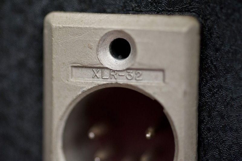

It says XLR-32:
If it's a DMX, then I should...?
Trust me. They are NOT data/DMX. DMX is ONLY used to control lighting, lasers, fog machines, and motor controllers. DMX cables are much higher resistance in order to effectively terminate the signal without having to use terminators at the ends of daisy chains. DMX512 only uses 3 pin cables.
DIN has become a generic term for almost any round connector with radially oriented pins, be it 3, 5, 7, or what have you. Before USB, and before "PS2" connectors, keyboards used to connect to computers using a 7 pin DIN often called a "PC/AT" connector. DIN gets called XLR when it's stage and music related.
OK, so they're not DMX. DIN doesn't matter. But the connectors ARE 5-pin male XLR.
So, how do I convert 5-pin female XLR to 3-pin female XLR?

If I had to guess:
1. The purple and blue wires pass directly from the DIN/XLR/Canon plug to the composites/RCA plug on the other side of the box. I'm betting that it forwards a properly crossed over, amplified signal from the upper of the two black boxes pictured in my last post.
2. Without seeing where the other two wires go in relation to the cap, the resistor, the semiconductor and the two blue things, or their relationship to one another, it's a wild guess that these components provide the last bit of ju-ju needed for the Transar. The above-mentioned black box would provide some crossover action as there's not enough components there to provide full bandpass.
3. Without a complete knowledge of where each of the four contacts leads to, as revealed in a full schematic, it would be impossible to adapt to a 3-pin connector if the Transar and Heil legs of the circuit cannot share a common ground. I doubt that they could as someone on the ESS design team would've figured that out and used a 3-pin connector.
4. Without a knowledge of the pinout on the 5 pin connector, and the two circuits involved could share a common ground, a premade adapter cable stands an extremely slim chance (3125 to 1) of working.
5. Without a complete knowledge of the function of that little black box with the passive looking components in it, you'd be guessing as to the use of the more conventional methods of active and passive crossovers. The whole picture looks like a hybrid of both.
6. Without a complete knowledge of the function of the big amplifier that originally came with these, use of more conventional components would be a stab in the dark.
7. As these speakers are rare as hen's teeth, information on the internet won't be too plentiful, to understate a point. If ESS is still stocking and selling the Transars, would it be in Ricky's interest to let loose of that information to you?
8. Even armed with all of the technical information on all of the components, it will take a big step out of the "replacing like for like" modus operandi to accomplish making these speakers sound worth a damn.
9. I'd say stick with "like for like" - replace those passive components in the little black box, get the drivers attached to the "enclosure". Spend your computer time looking for and purchasing the correct ESS amplifier. If nothing else, it would be good for maintaining collector/resale value just in case you need to sell them to get some pacifying jewelry for Mrs. Loss.

I apologize for being dense... but are you saying this can't be figured out? I mean, I'm obviously no electrical wizard, but there's five pins and only four are used. Pins 2 and 3 are for the Heil AMT "tweeter." Those two (blue and purple/pink) bypass the caps in the PCB and go straight to the RCA cable. The RCA cable leads to a Euro connector to meet up with the back of the AMT, just like on the Monitor, AMT3, and AMT1/a/B/C/D speakers. Wires to pins 4 and 5 are yellow and black. From the pins, the wires lead into the PCB. Out of the PCB, they retain the same yellow and black colors and lead directly to the vertical Transar AMT's voice coil.
So, there's four wires. We know that two wires, a positive and a negative, go to HF, and two wires, a positive (yellow?) and a negative (black?), go to MF. On the back of the Heil AMT, is blue the positive, or is the pink/purple positive? The other is negative.
If we know this information, then we should be able to construct a custom cable, right?

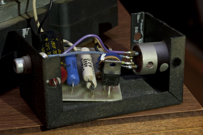

Some better photos of the box. I don't think I can get a picture of the bottom of the PCB w/o clipping wires, and I'm not doing that yet.
I would kill for a schematic.
Well, maybe I'd speak some harsh words for a schematic.
I'll run this idea up "The Flagpole" and see if anyone salutes it.
The RCA jack on the Xo unit is for the 2 wires to the Heil.
The 5 pin Cannon plug is a speaker level 4 wire connector from that ESS amp #1, that I thought belonged to Mr. Stoploss.

The odd thing is that there's no crossover function at the little black box for the AMT's - the purple and blue wires pass through. So, you figure that it would be handled internally by the big black box that El Stoppo doesn't have. Therefore, why doesn't the big black box handle all of the crossover function internally for the Transar as well? Why is there what appears to be a passive first order crossover that would theoretically cross it over at 530 (highpass) (without taking those resistors and semiconductor into account)? Why wouldn't that be handled internally by the prodigal box as well?
I'd be surprised if anyone other than the original designers at ESS hand any idea about the relationship between the Transars, the AMT, the little black box and the big black amp/crossover.
I suppose if these things must sing come hell or high water and I were in Stoploss' shoes, I'd build a passive second order high pass crossover for the AMT at 1500 and send it a signal via the the XMA-2 from the UPS-1 preamp full output crossed over at 250 (to be safe - it can always be lowered with the twist of a knob).
