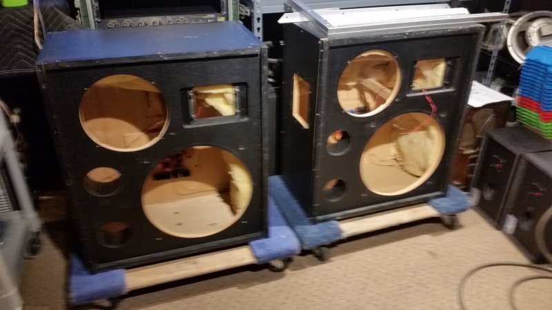

Hello all this is my first post on AK, I don't know what took me so long. :)
I have a pair of EV S15-3’s for about 15 years now that I just love and fell in love with when I was a kid back in the early 80's. Well I plan to bring them back to life and make them my new listening room speakers. I know that these are not "audiophile" but do have the bones to make a very nice musical presentation.
The EVM-15L and the VMR's are original and work perfectly but one tweeter needs service. I think I may have a EV original replacement diaphragm. My pair was made in 1982.
My plan is to do a refurbishment to them by cleaning up and re-finishing the cabinets, re-building the cross-overs with new caps, re-seal the speaker cone edges, replace all the stock 24awg speaker wire with 14awg & replace stock 1/4” speaker jack's with heavy duty binding post’s.

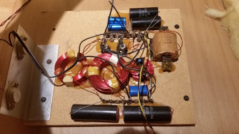

Here is a picture of the crossover network for the S15-3. The unit on the left in the picture is the Tweeter protection device witch is simply 2 diodes back to back and a big power resistor. These are the weird TO-3 style diodes, but standard diodes would work just the same. The idea is when the power going to the tweeter exceeds it's maximum rating the extra power is dumped into the resistor. Some think these devices have an effect on the sound of the tweeter but it should be basically invisible to the tweeter unless you drive the hell out of the tweeter. I will do some tests later to see if the protection device has any effect on the fidelity of the tweeter and decide if I want to leave it in circuit.
On another note I found the caps to be quite a bit off value and even found the ESR to be as high as 2.5 ohms!
So it time to change out the caps.
The blue polyester cap however did test perfect so that one stays.
And as you can see the stock wire used is just 24awg. I will replace all internal wire with 14awg copper stranded, Most likely won't sound any better but it will make me feel better:)LOL
I just wonder if the S15-3 is the same internal dimensions as the TL606? Or is it something else? I will have to take some time and measure the inside dimensions of the cabinets and the ports.

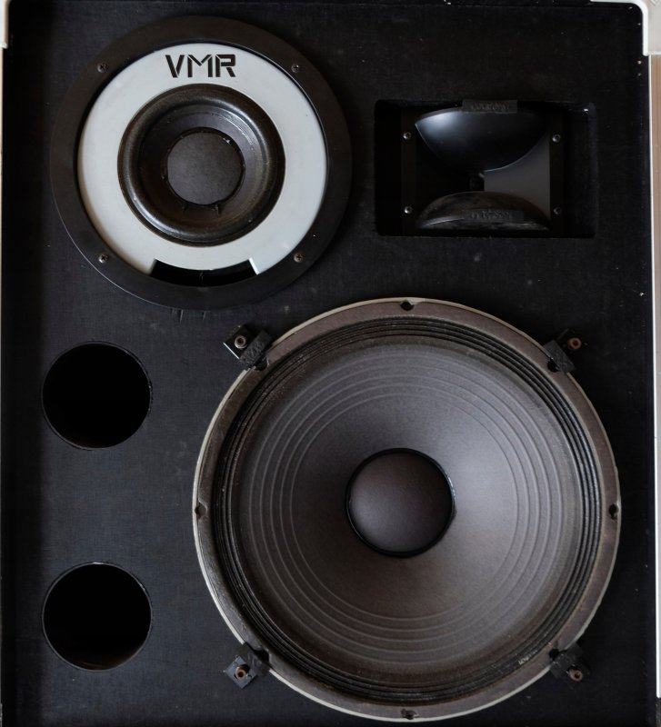

Had a chance to take some measurements here are the S15-3's inside box dimensions including ports:
26.5" Tall
22.75" Wide
11.25" Deep
That seems to work out to 3.9 CU.FT (The TL606 is 3.2)
However the S15-3 has 2 port tubes and the TL606 has cutouts so there is some more math there but that's too complicated for me to add into the whole formula. :(
PORTS X 2:
4" Diameter x 3.5" Long

Well lucky me, I just found 2 new old stock EV T350 tweeter diaphragm's and 2 more VMR's in storage that I forgot about ! WOT WOT!
Great news with the NOS diaphragm's one of my tweeters was not working correctly anyway so now I can replace both at the same time.
NOTE:I noticed that the original and replacement EV diaphragm's have a darker brown color whereas the replacements you get these days are a much lighter color. I don't know if it matters but I thought I would just mention it.

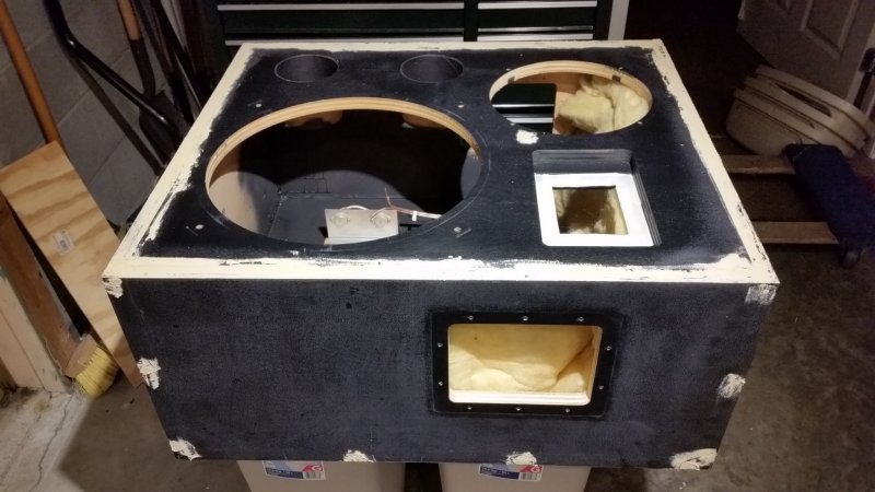

After careful consideration since these speakers are going to be my main music speakers and they are never going to be “on the road again” I decided to update the look of the speakers to suit my taste.
The cabinets are solid as a rock and are in great condition for there age (37 years old made in 1982) but do have some nicks and bumps and the aluminum frame is fairly rough, Soooo….
I have decided to apply a Dura-Tex coating to the cabinets, I like the look and that it hides small imperfections well, durable easy to apply and Non-Toxic also it will give the speakers a sort of an aggressive modern industrial look witch I like.
I will remove the grille and mounting cleats as well as eliminate the aluminum frame and maybe make a more elegant speaker grille in the future.

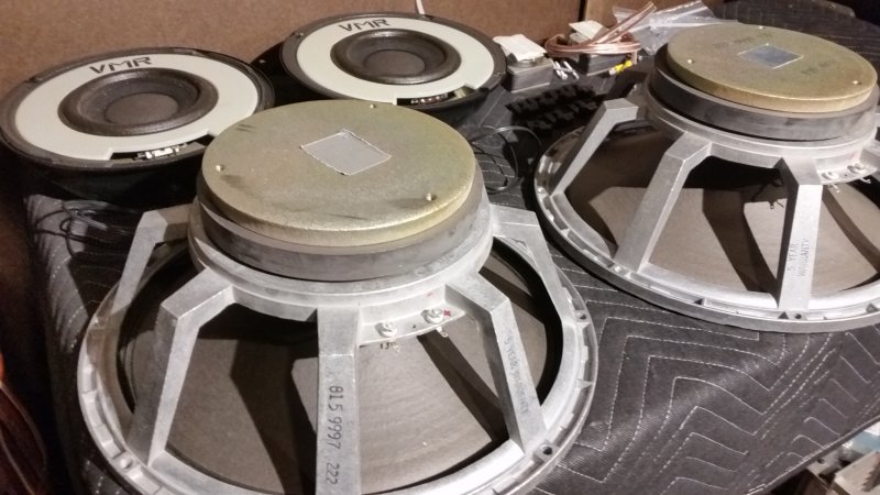

So while I'm waiting for some parts I thought I would give the drivers some attention.
One tweeter is bad but lucky for me I found 2 new old stock EV diaphragm's in my storage.
Replace both tweeter diaphragm's with NOS.

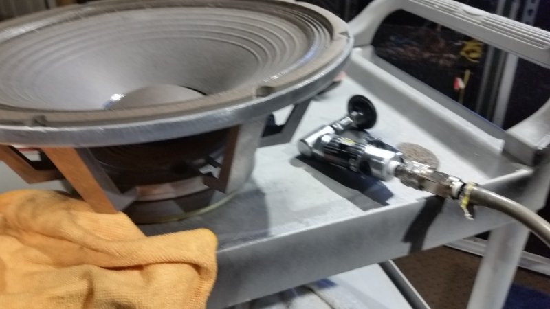

The woofers and VMR's work perfect but they need the cone edges re-doped.
The woofer basket edges look gray and tarnished so I use a gentle Scotch-Brite pad on my air tool to polish them back to the new shinny aluminum.
I will also upgrade the speaker terminals to spring loaded type.
I will also upgrade the VMR wire from 24awg to 14awg and replace seals.
I keep tape over the woofer pole vents to avoid any debris from getting into the magnet during the restoration.
