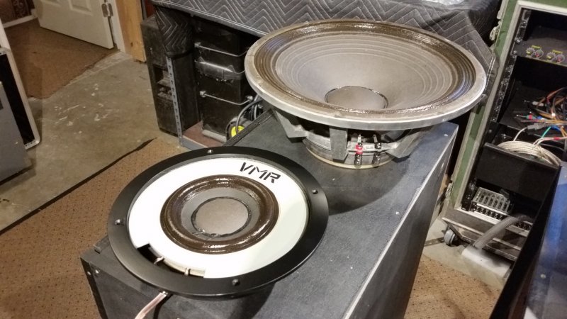

I acquired a set of these which has been installed in a church, and the crossovers had been previously repaired, but blown again, so they discarded them. The cabinets were pretty rough, so I tossed them out (they were surprisingly flimsy in fact on the PI15-3 version which were never meant for the rigors of gigging or moving about) but the drivers are all intact and impressive. I was planning to just sell the components, but now, since I love building, I might just design new cabinets and build new crossovers to make them sing again. I found a schematic for the 12-2 crossover, but (foolishly) tossed out the trashed crossovers so I don't have that to work with. If anyone that's done a crossover rebuild can provide a schematic and values, that would be greatly appreciated. It might be worthwhile to attenuate those peak areas in the midrange while I'm at it.....

Good morning! I posted above in 2019 with photos of my late father’s S15-3’s I use as my main reference system in home use. I’d recommend building a cabinet of the same volume, with the same vent size and depth, but in a stacked configuration. Like a 15” loaded tower. Were it not for the sentimental value of mine, I would have already done this to better time-align the channels when listening in the nearfield sweet spot.
Regarding xover, I would love information on them as well, as I too have only ever found an S12-2 schematic. I’ll be repairing one of mine soon and can post cap values for you when I’m in there, but have not been able to find anywhere with frequency values for the air core inductors. If I could find those frequencies, you better believe I’d be rebuilding a nice new set from scratch. I agree that a resistor on the VMR may assist in flattening out the response curve, but doing it with a five-band EQ has always been easier for me.
