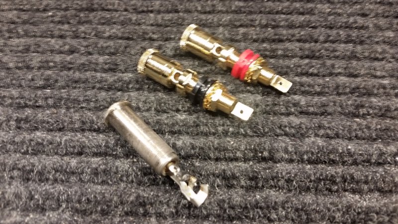

These are the BIG binding posts I am replacing the stock wimpy 1/4 phone jacks with.
Look at how thin and flimsy that 1/4" jack is, It's a good thing the speaker was only rated at 150W. What's even more crazy is the speaker allows for dasy chaining multiple cabinets together. What could go wrong, But hey those were the days before speakon connectors.;)
The new binding posts will give both a much better electrical connection but will also provide a better mechanical connection as well, Besides if I am going to go through all this work to fix-up these speakers I can't leave a crappy 1/4" jack on there:)
As I like to say "Small Improvements Along The Way Lead To A Big Finish At The End Of The Day"

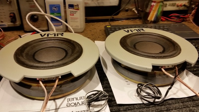

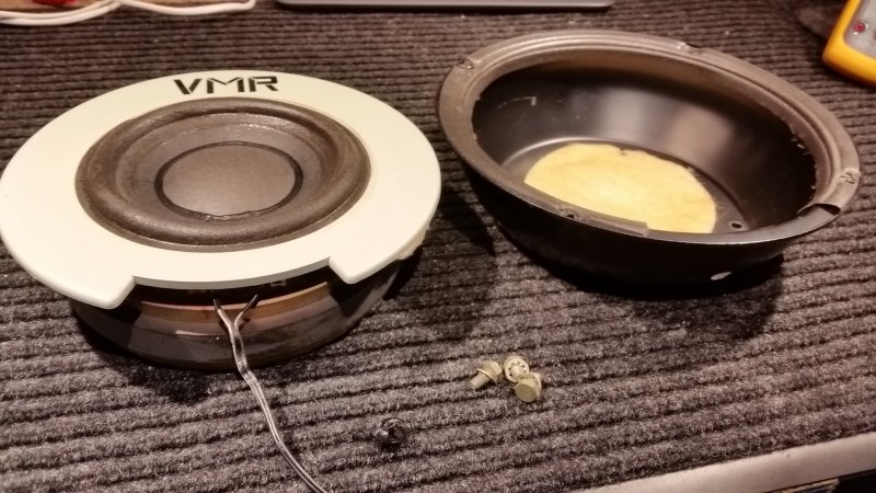

Today I decided to work on the VMR mid-ranges. My VMR's work perfect but do need the cone edges re-doped.
So one of the things that I wanted to do was upgrade the wire going to the VMR. The stock wire is just 24awg witch is generally fine but remember each small improvement adds up.
WARNING:So first I will say I don't recommend messing with your VMR as it is easy to damage. Some VMR's drivers won't come out of the metal housing so easy or may even be glued together. The plastic face can break easy and then you are screwed.
In my case I have 2 spare VMR's so I do have back up if something were to go wrong.
First I remove the strain relief holding the wire to the VMR with pliers, then remove the bolts on the back of the VMR. I use 2 small blocks of wood to lay the VMR facedown without damaging the cone.
Then I carefully lift the housing up and away from the driver, not easy because of the housing is steel and wants to stay on that magnet. If yours is glued I would say stop and just leave it alone.
I clipped off the old wire noting the polarity of the speaker.
I soldered new 14awg wire to the drivers terminals.
Then enlarged the hole for the strain relief and replaced the strain relief with larger one to allow for the bigger wire.
Then feed the new wire back through the housing and re-assemble.
There are 2 pieces of fiberglass insulation inside the VMR, one is a 1" X 1" X 8" strip wrapped around the gap between the faceplate and magnet structure.
The other is 4" in diameter by 1/2" thick.
I will be replacing the Fiberglass with Poly-Fill.
There is also a rubber seal between faceplate and housing. I will replace and use new butyl rubber.
Here are before and after pictures of the work done.

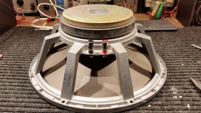

BTW look at the size of those magnets they are bigger than the speaker cone! EV was not playing around when they created the VMR.

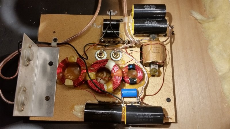

The Crossover Network Rebuild.
So I spent some time over the past few weeks try to decide what components I was going to use to rebuild the crossover. Was I going to use some fancy exotic caps or not but in the end I decided that it is just not worth that level of investment in these speakers as the improvement would not justify the cost.
However I was NOT going to put some cheap unknown quality capacitors off eBay in these speakers.
What I decided on was the Dayton Audio 5% Metalized Polypropylene Audio Grade Crossover Capacitors from Parts Express. These are very good quality capacitors, these are not cheep caps the cost was $195, but that's not nearly as much as an Auracap, Mundorf or some other exotic caps would have cost;)
The stock tubular capacitors in the EV S15-3 are just basic low cost caps. In fact they have a wide 15% tolerance and are only rated for 70V! fine for PA work but not so much for serious listening.
The new caps are 5% so right off a 10% increase in accuracy, That's a huge improvement, however when I measured the new caps they measure better than their stated 5% they are closer to 2% and these are also rated for 250V! a 180V increase from stock!!!
So no matter what there is going to be a BIG improvement in Imaging, Openness, Clarity and musical articulation.
And remember when I measured the old caps some of the values were far off and some of them had very high ESR acting more like a resistor instead of a capacitor so clearly these speakers sounded very tired and these new caps are really going to bring these speakers alive better than new.
There is no need to Re-Invent the wheel here the original crossover design was/is great and is one of the things that gives these speakers a little of their magic. So I stuck to the original Capacitance values and design.
I Upgraded the wires from 24awg to bigger 14awg.
Added also new heavy duty binding posts to replace the stock 1/4 phone speaker jacks.
I will decide later if I will remove the tweeter protection device once I can verify if it has any effect on tweeter fidelity.
I don't really need it anyway as I will never be playing them at that loud of a level to blow them but if it does not have any negative effect of the sound of the tweeter it's nice to know it there just in case.
Here is the before and after.
You can see the new caps are much larger and almost don't fit on the board.

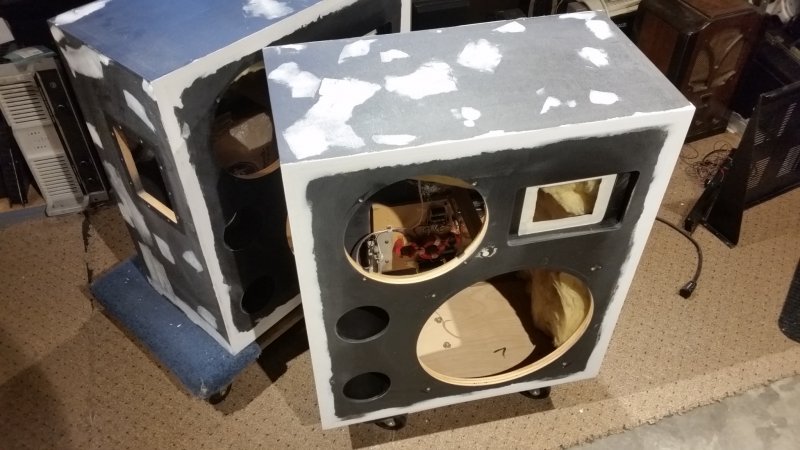

The cabinet work is coming along nicely I am spending extra preparation time on the cabinet. I want to make sure I fill and smooth every inch of the box so when I put on the coating it will look as good as possible.
I'm also working on a few personal cosmetic touches of my own more on that later.
I am just waiting for the materials to arrive and also the weather to get better so I can work outside.

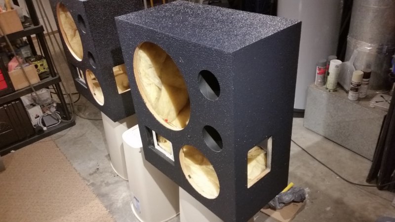

After many days of filling and sanding to achieve very smooth box.
Here is a picture of the first coat of Duratex while it's still drying.
So far it looks very nice using the stock foam rollers.
Well a few more days of drying and then it will be time to put the finishing touches on the speakers.
