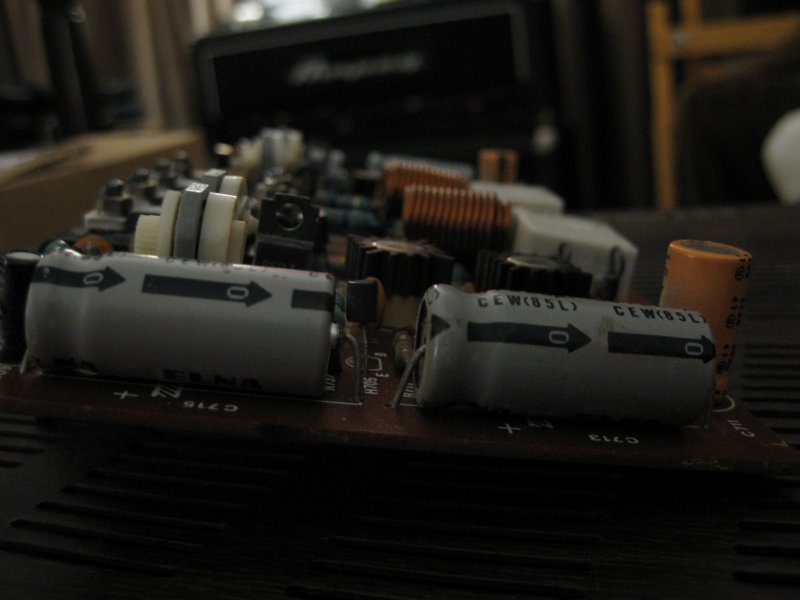

Hi Everyone,

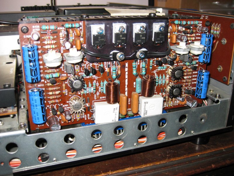

Starting with the right P700 that has physical component damage. This may be a silly question but, any component I replace on the damaged side needs to be mirrored on the other channel on the same board AND both channels on the other P700 board correct?
On the left side of the board as installed the possible damaged components are:
H708-2SC627-plastic riser is yellowed but Hfe was within spec. The one transistor I don’t see a direct replacement for, hoping it survived. These are marked Fujitsu.
H711-2SC458B-shorted B to C. Transistor tester thinks it’s a 0.56ohm resistor.
H713-2SD357-B Leg is open. Transistor tester can’t detect it.
H714-2SB527-Shorted B to C to E. Transistor tester thinks it’s two resistors, B-C: 1.27ohm, C-E: 87.0ohm.
H717-2SC945-shorted B to C to E. Transistor tester thinks it’s two resistors, B-C: 1.59ohm, C-E: 16.8ohm.

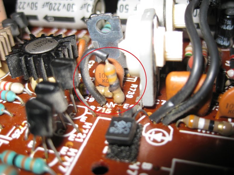

R715-33ohm-burnt. For some reason the Service Manual doesn’t list resistors R715 & R716 but based on the Orange/Orange/Black/Gold banding I think it should be 33ohm. Even though it is cooked it still reads 33.5ohms, will be replacing it.
R745-100ohm-burnt.
Should I replace every transistor on the board, well maybe with the exception of the four 2SC627’s or check for shorts between legs? I figured if I have to remove to test then why subject them to more heat stress, just replace with modern equivalents.
After I get both P700’s back to spec I need to replace the output transistors. I fried two of them too. :(
The bottom pair of power transistors on the large heat sink (2SA745/2SC1403), my transistor tester thinks A745 is two resistors in parallel, does not detect it as a PNP transistor. C1403 is shorted between B and C.
Regarding 2SA745/2SC1403, is the consensus to replace it with MJ21193/MJ21194? Do I need to worry about Hfe and Ft being that off? Are there substitutes that are not a TO-3 form factor that might be closer spec wise to the originals?

Here is the phantom resistor R715 with a nice burnt ring on it.
This picture is before I de-soldered all the connections on the power supply board. The solder lug on the far left was broken in two right where it entered the board, held on just by solder.

On the question of what components to replace on the two amp boards -- I would recommend doing the minimum it takes to get the bad board to work first. Replace what you know is bad and try it with a DBT. Troubleshoot and repair until it works, then decide if you want to mirror the replacements on the good board. My personal philosophy is not to do wholesale transistor replacement. I like the old boys if they aren't blown or noisy.
Steven,
Thanks for the suggestion. Can I pull both amp cards out of their sockets and power the unit on with the DBT to check the other circuits? Possibly plug a set of headphones into it to check the preamp?
The service manual states 45w @ idle, owners manual says 60w at idle, which one is correct? Just built my first DBT, would a 60w bulb be the correct choice?

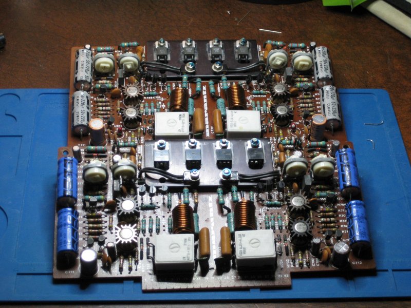

Just an update, replaced all the bad components on the P700 power amp board. Still need to recap the other P700 board after I DBT the unit. Might get to that this weekend.

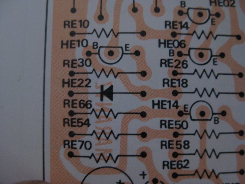

Big Question. My PE01: Buffer & Preamplifier Board is incorrectly silk screened at all four VD1212 locations. I'm unsure which direction to install the 1N4148's, does the dot on a VD1212 diode indicate the cathode?
The board is marked RE22-RE25 with a resistor symbol.
The service manual skips RE22-RE25 in the parts listing and matches what I am seeing on the bench.

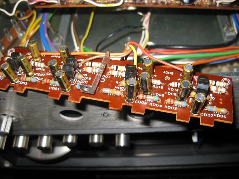

Made some progress with the other boards.
PD01 Tone Amplifier Board is recapped with Nichi UFG's.

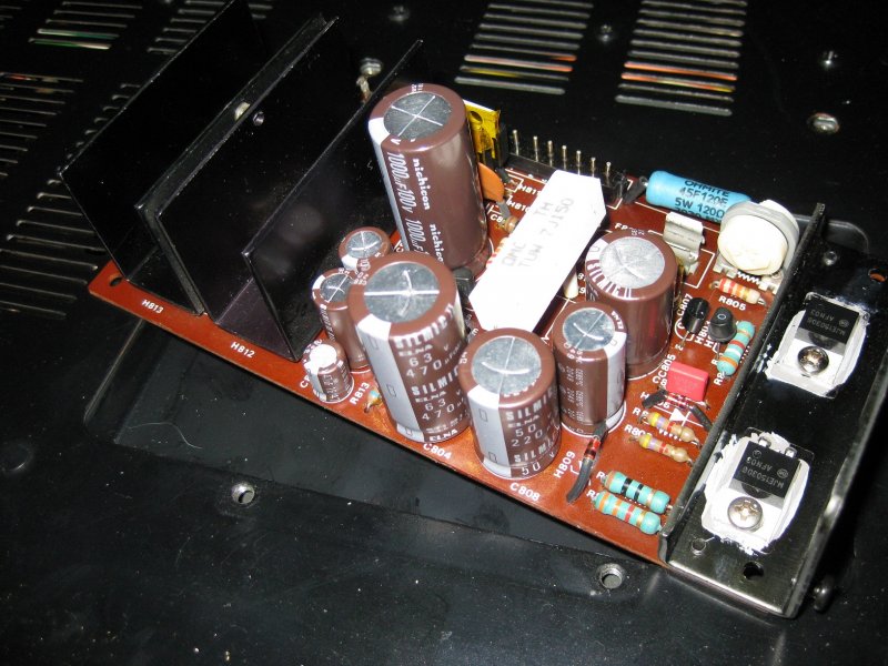

P800 Power Supply Board is finished too. I decided on Silmic II's before reading that HUGE post about which caps work best in the PS, mainly because they were the exact size as the originals.
P700 Amplifier Card is installed, waiting for me to finish up the preamp to DBT test.

The dot is the cathode. To verify, use your diode test function on your DMM. With red/black in one configuration, you will read OL. In the other, you will read about 0.6V drop. In that configuration, the black lead is on the cathode.
