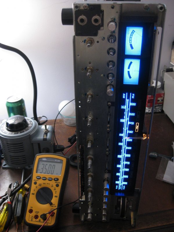

Little update.
Replaced the two lower two (FL) output transistors, A745 and C1403 on the left heat sink, and the four transistors @ H713-H716, as well as the two C458’s @ H711 & H712, and the resistor at R745. Plugged it back into the DBT and thankfully no shorts.
Was able to set bias and offset via R739/R740 (12mV) and R721/R722 (0V) on this side.
I ran into an issue on the original bad P700. I can’t set the left side of the card to 12mV, I only get 0V between pins 11(+) and 9(-). I can achieve an offset of 0V between pins 13(+) and 15(-) on this side of the card and am able to set the right side with no issues.
Where do I test from here? Solder pads all look good no bridges that I can see under a lens. Did I screw something up in the preamp?

Still pulling and measuring everything on the left side of the right P700 board. I started to remove the massive heat sink to see if the lower output transistors weren't making good contact but I had to stop and eat lunch. While eating lunch I searched for marantz zero bias and spent more time browsing then actually eating. Didn't find any posts that jumped out at me except for one which basically said the problem is right under my nose and I'm looking past it. Damn if it wasn't right, R739 the trim pot is open between B and E on the bias transistor H711. It would also explain why I'm getting different readings when the transistors are soldered in place but the same when they're removed. :idea:
The parts book calls for a 1K ohm (B). Does B mean linear taper in this instance? Thanks.

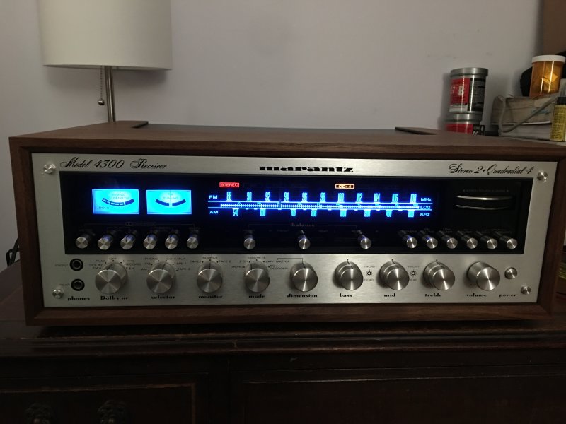

Isn't that a beautiful thing?
While I'm waiting for the last trim pot to arrive I decided to put it in its wooden box to protect it from weekend visitors. I spent half the day with headphones on listening to pretty much every genre and man does it sound good. I listened to some music I remember hearing when I was a kid through it and it felt like I took a trip back in time. That smooth punchy sound is there in every thing I listened to, can't wait for the caps to break in, can it get any better? Unfortunately the cap kit from Falcon UK is stuck in Chicago somewhere in Customs, going on three weeks, hopefully it will make it here before the end of June for the big reveal.
Haven't been on the site for a while. That looks awesome and congrats on finding the issue. It always seems like such a simple problem once you find it but it's miserable until then. My 4300 had one channel that hardly had sound and I was pulling my out hair trying to figure it out. It ended up being a broken ground on the shielded signal cable coming from the PM01 Phase Converter board to the P700 Power amp board. The break was hidden so it was a pain to find. Sounds awesome now. Just waiting for a late FedEx shipment with the last transistors and caps to finish off the unit.
Going to use it for playing music at my daughter's wedding coming up. Hope to have it all broken in by then.

The KEF's have been recapped and after 100 hours of break in they will finally be paired up with this 4300.
Thank you. Thank you. Thank you to Steven Tate, MikeRam, catrafter, EastPoint, & USMC Spike for taking the time to read my posts and point me in the right direction. It would still be sitting in a box in my attic if it weren't for your guidance.
