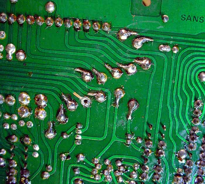

If you've seen my last post, I accidentally cracked the PCB of my Pioneer SX-50 in a bonehead move. Luckily, only a few traces were damaged, and it looks like an easy fix to me. I'm going to go as slow as I can to ensure I do a proper job on this. However, call me paranoid, but should I worry about a possible loss in performance/quality by repairing the traces with jumper wire?
if its the power supply board, I don't see any problems. Some things have critical layout that must be just so in order for it to work right, but thats more when you're talking radio circuits or very high gain circuits where noise might be a problem.

Mostly I'd be worried about lifting traces. Make sure the copper is good and clean, and use a hot iron. I pre-tin both the trace and wire, then line things up and hit the iron just long enough to flow the solder that's already there. I'll also dip the wire in flux after heating it a bit just for the best possible flow. Wouldn't try any of this with a cheap low watt pencil iron though.
PS - lots of experience with that, and that's only with one restoration. My QRX-9001 needed 50 patches like you're talking to bridge failing pass through joints on a double sided board. I blunted the end of an ex-acto knife to just more than the width of the traces, and used that to scrape the board to bare copper where needed. Strip the wire and bend that to match the trace before applying. Solder station was set to 725F.
Here's a pic ... the one bare "terminal to nowhere" in the middle shows the trace ready for a jumper.
Note that small pieces of wire will "stick" to solder on the iron and lift off! Very annoying. That is one reason I made mine with insulated wire and fairly long. Was also trying to prevent shorts, those traces are small. Board was split so I couldn't just wipe solder over the crack, in some places the traces were lifted quite a bit.
I second the idea of tinning both and just applying the iron enough to melt the junction. More solder on the trace and less on the wire is good. I did this for most of my jumpers.
On signal traces you want to keep the jumpers as short as possible to prevent any stray interference from doubled wires (which may act as an antenna), but if you follow the trace with the wire and tack it down with some hot glue or something, you should be fine.
The hum you hear is one side of that filter cap not making contact, make sure you have both sides connected to the appropriate trace. Snapping the board can also crack adjacent solder joints from the shock wave generated by the board breaking. I had to touch up every single joint anywhere near that break on mine before it would stay out of protection.

If you proceed:
---any track/pad that you solder to needs to be scraped down to clean copper then tinned before attaching a wire
---wires need to be tinned before joining to a track
---if you can take advantage of a component leg sticking through the board, you can j-hook your jumper wire around that leg to add stability to the joint
---use small, solid core copper wire. The wire should be insulated unless it is very short such that there is no chance of contacting other tracks, solder joints, or anything metal.
---flux is your friend, especially so for novice solderers. The flux that is in the core of solder burns off quickly, but flux is essential for making a strong joint. Get some additional flux and use it generously...then clean it off after the joint cools.
---be aware of what type of components that you are soldering near. What is on the other side of the board where your iron tip is? Small diodes, transistors, and especially polystyrene capacitors, can be damaged by too much or prolonged solder iron heat

Also, for the soldering, I'm going to be doing point to point wiring. Running jumper wires from one end of the trace to the other, as it's the easiest way for the small traces. Assuming I do this right, will heat expansion and contraction still be a possible issue for this unit?
I don't know how much of an issue it will be. That is the point. I don't know, you don't know. Physical materials do expand and contract with temperature changes, some more than others. It is the differing rates of expansion/contraction among different materials that can create issues...but this typically happens over a longer (possibly very long) time frame so it is often ignored in these types of discussions.The PCB broke in the area of the main filter caps, right? Will those big caps still mount solidly? Are there cracks under the main filter caps...or running between the leads of one of those caps? It might never be an issue. Or it might be an issue. That unknown is one of the reasons that I personally would not do this repair. At some point you may need a power switch or a pot or some no-longer-available transistor, etc. for your working SX-50.
But this is a leaning experience...whichever way you go. If you do the fix, it will likely say fixed for quite a while, possibly "forever" (relatively speaking). And you do have lots of willing people here to assist you, some of them very knowledgeable like petehall347, sKiZo, gadget73, et al. If you do the project, do it because you truly want to.
That makes a lot of sense, thank you. The filter caps do mount solidly to the board, it's just that the crack split the negative trace for one of the caps so there's no longer proper contact. If this unit does fail after a while, at least I learned a few things about stereo repair for the future. :)
