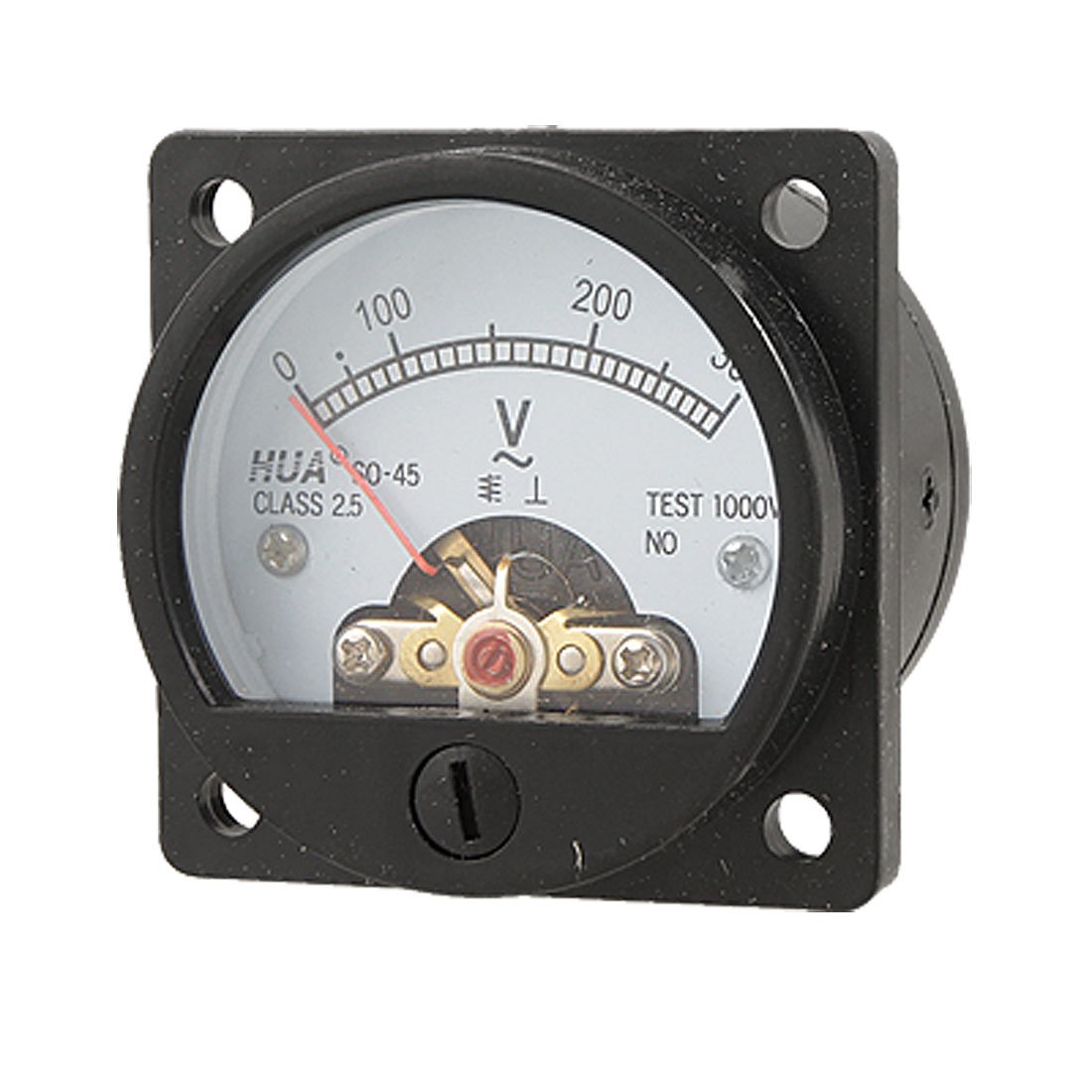

You would have to think about the aesthetic, money and time, but a front bezel could be made to stand off the chassis mounts giving you room for anything you want. A machine shop or old school body shop could fold the metal and weld the seams for you inc cutting any holes you want. Or the existing bezel could be built up on the sides etc...Its a project for sure.
There are also front mount digital meters that eliminate the whole issue, they are in the youtube video I posted earlier
There are also meters that cold be mounted on the front of the bezel, as to the aesthetic, you would have to decide. You could also take another chasis and create a remote meter unit for a kick, companies did sell them with the large analog meters.
Obviously this one does Volts, there must be watt meters out there. The circuitry and pick ups are another story.
This one is $8.00 for just the meter.
