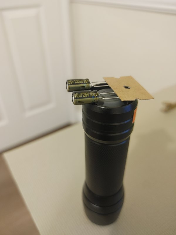

Wima film caps, CDE, Nichicon, and alot of caps that are blue with a gold stripe down the side and blue with like a greenish gold, but no name on them.
Thinking maybe write down all the parts i bought in the kit and buy new ones on my own but all top notch ?, seems to be some good parts in the kit.
The orange Epcos Sikorel caps are fine.
The small ones look like Nichicon, but the color is off though. If your worried about the small greenish caps, you could re-order different ones to be sure. But all the other brands you mentioned and the orange Sikorel caps should be good to go.
