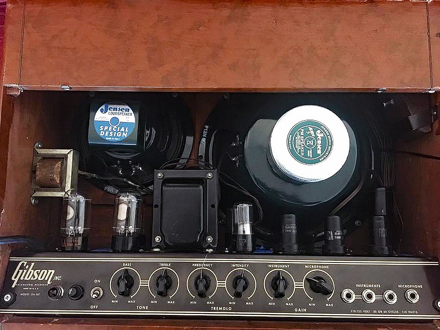

@EastPoint @gadget73. Thank you for clarifying. The more I think about this, there is no "vintage" sound for this one because it is a jumble of parts from different eras anyway. I'd originally noted this is most of the tubes are original except the mismatched output tubes, by manufacturer not by type.
Still need to trace the part paths to see what I really have "under the hood" before I start swapping parts out.
Mod questions on going all in ...
  1. When I go to replace wires, is there any reason to use shielded line like in the center section repair previously mentioned in #6 above, or will simple plastic sheathed wire do? I don't know how sensitive these are to field coupling.
  2. Any reason not to replace with grounded 3-wire plug? The original power wire + plug is two-prong + ground wire alligator clip. The alligator ground wire was clipped or separated at the plug. Still with the unit, just not attached. I am not aware of a reason but figured to ask because ground design can have implications to circuit operation.
  3. A Desktop Reference of Hip Vintage Guitar Amps by Weber on pg 117 indicates the old Jensen speakers have dropped voice coils due to the animal glue deteriorating over time. Anyone encountered this? It triggers the P12R not available alternate debate, but I know this thing made sound when it was previously plugged in so this is more a curiosity right now.

Last week I finally got around to ordering parts for a full rebuild. I decided to trust it and play it the rebuild was necessary. I'll label and catalog the existing parts for whoever gets this in the long distant future, but I decided play ability was more important than originality (which was suspect anyway).
modifications I'll likely add backup rectifier diodes for protection, and I'm debating whether to put a 90% attenuation switch on the output with the high watt resistors mounted on a new metal plate heatsink that uses existing holes so the mod can be reverted by desoldering. I'm just playing at home so I suspect I'll like the attenuation switch addition.
Question on cathode bypass capacitance
I decided to not go stupid large, like current 150/100 uF Mallory can, and instead use 2 JJ Electronics 40/20/20/20 uF combo-caps to cover the 40 uF, 4 x 20 uF, and 3 x 10 uF circuit specification. I have questions on how to allocate it though.

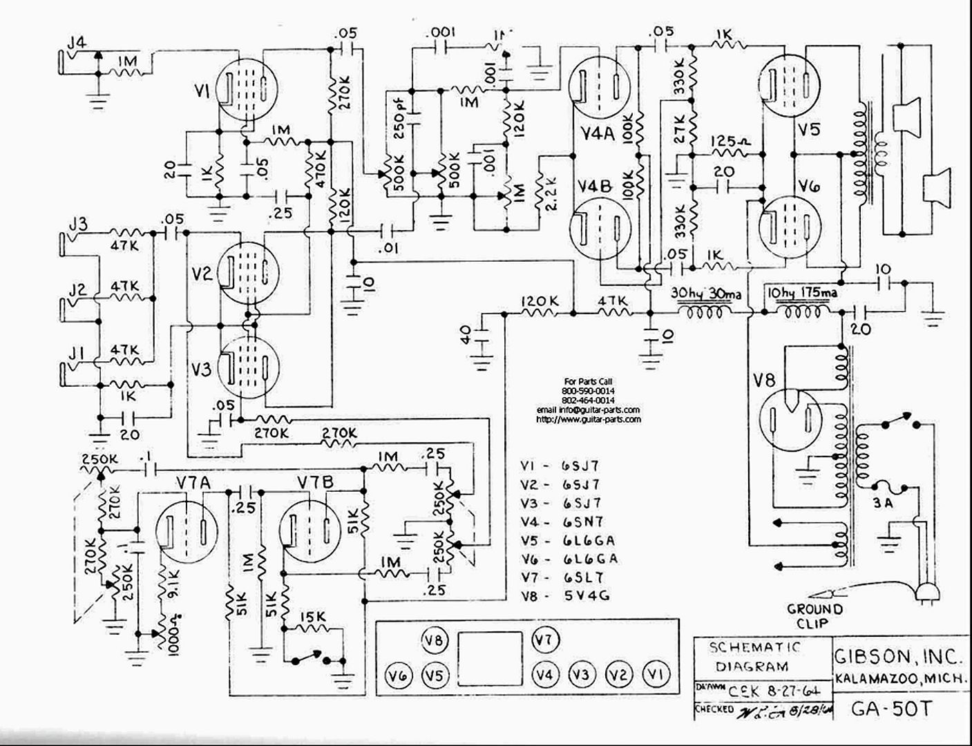

  1. Does anyone know if the combo capacitor cans have cross-talk issues that would mean I wouldn't want to mix signal and power duties?
    1. this assumes cathode bias locations impact signal more than power input stage filtering/reservoir
  2. Am I better doubling the output stage cathode bias cap from 20 uF to 40 uF or leaving it at 20 and increasing the 20 uF off the heater circuit transformer to 40?
Note: part of the reason to back away from massive multiplier of the cap values is to allow circuit to reduce bass a little, rather than pushing it all to the ancient woofers.
Here's a schematic (I believe) for your amp. Specifically, which bypass caps are we talking about?

Photo of the control panel and inputs.
No issues with cross-talk within the can caps. It was very common for multi-caps to have several high voltage sections for the power supply, and a low voltage section for the cathode cap.
No real reason to make that cathode cap bigger either. Sometimes if you do that it can cause stability problems, so I'd be careful about changing values by large amounts. Within 20% is pretty safe but doubling things may not be so good. If you absolutely have to trade a 20 for a 40 though, the cathode cap being larger is less likely to have issues. The rectifier tube is not going to like working into a 40uf cap. A 20uf is quite possibly already larger than ideal.

Some bypass cap changes may be for circuit parts that are not being used, like the mic input.
I would not change the bypass cap value in the Tremolo/Vibrato section. That can definitely lead to instabilities. This amp has a nice tube-driven oscillation circuit. These have such an excellent, deep, natural tone. And a good 6SL7GT is going to make that sound superb. I would not mess with any component value changes in the trem part. Go with good poly coupling caps if you wish. Keep the same values.
If you keep the 6L6GA tubes, keep the 20mfd bypass cap. Increasing the capacitance may cause problems with little benefit.

1949 Gibson GA-50T.

Appreciate the responses. I should have posted the component mark up that I've been using for awhile. See image below.
@Mr Boochie/@gadget73 - see below green label marks for the different large value capacitors. I was trying to describe the difference between:
  1. change C25 rectifier input in power section to 40; change C24 and C23 in power to 20, change C7 to 20
    1. this means 1 of the 40 uF caps in a 40/20/20/20 can must share with C1, C3, C21 20 uF sections
  2. split power and "signal" multi-caps
    1. C22 as 40 and C23, C24, C25 as 20
    2. C21 as 40 (changed from 20), C3, C7 and C1 as 20
  3. in both cases C7, C23, C24 go from 10 to 20 uF.
  4. @gadget73 - appreciate the response confirming no cross talk so the choice is about circuit fit not cross-talk. I had wanted to use the multi-cans to clear up space in the amp, and admittedly to minimize cost vs individual separate electrolytics.
@gadget73 Curious why you are concern about doubling the value, either on rectifier input or cathode. I've read numerous locations recommending much larger increases up to 100 uF or more safely for the cathode in particular. The amp was working (though I didn't trust it) when I started disassembly, based on those much larger caps. Are you saying the rectifier wouldn't like the inrush current?

Specific to the rectifier, the larger the capacitor directly off the rectifier, the more inrush current the rectifier has to deal with, especially at power-up. Exceed those ratings and the rectifier will die a premature death. Here is a snippet from the tube datasheet for typical conditions. This isn't an iron-clad limit on cap size, but its usually not way off the mark. The cap value can bump with lower voltage or higher plate supply impedance.
If its already 20, I really wouldn't think its a great idea to use a 40 here.
You can generally bump caps after the first resistor or choke without causing problems but that first cap does have a practical limit if you don't want to feed your amplifier rectifiers like they are candy. Yes people sometimes install massive capacitors in the power supply, but it doesn't always mean they know what they are doing or aren't creating new problems.
as for the cathode cap, making that bigger will increase gain at low frequencies. Sometimes that causes no harm at all, sometimes it can cause low frequency stability problems. That would sound like extra flabby bass, or you might hear or see the speaker cone "breathing" a bit as the amp very mildly oscillates at a low frequency. Being a non-feedback amp its probably not going to cause you any grief but feedback amps sometimes have problems with this.
