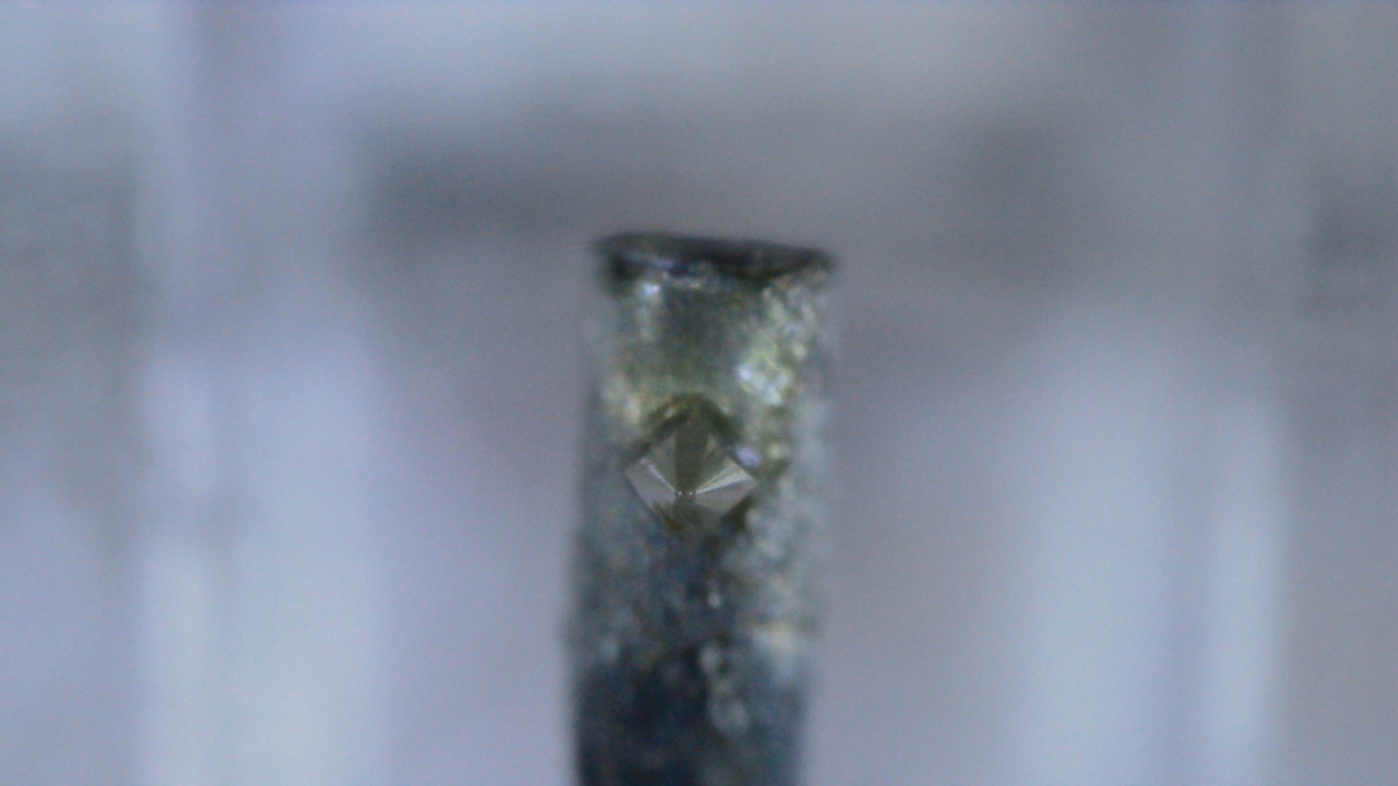

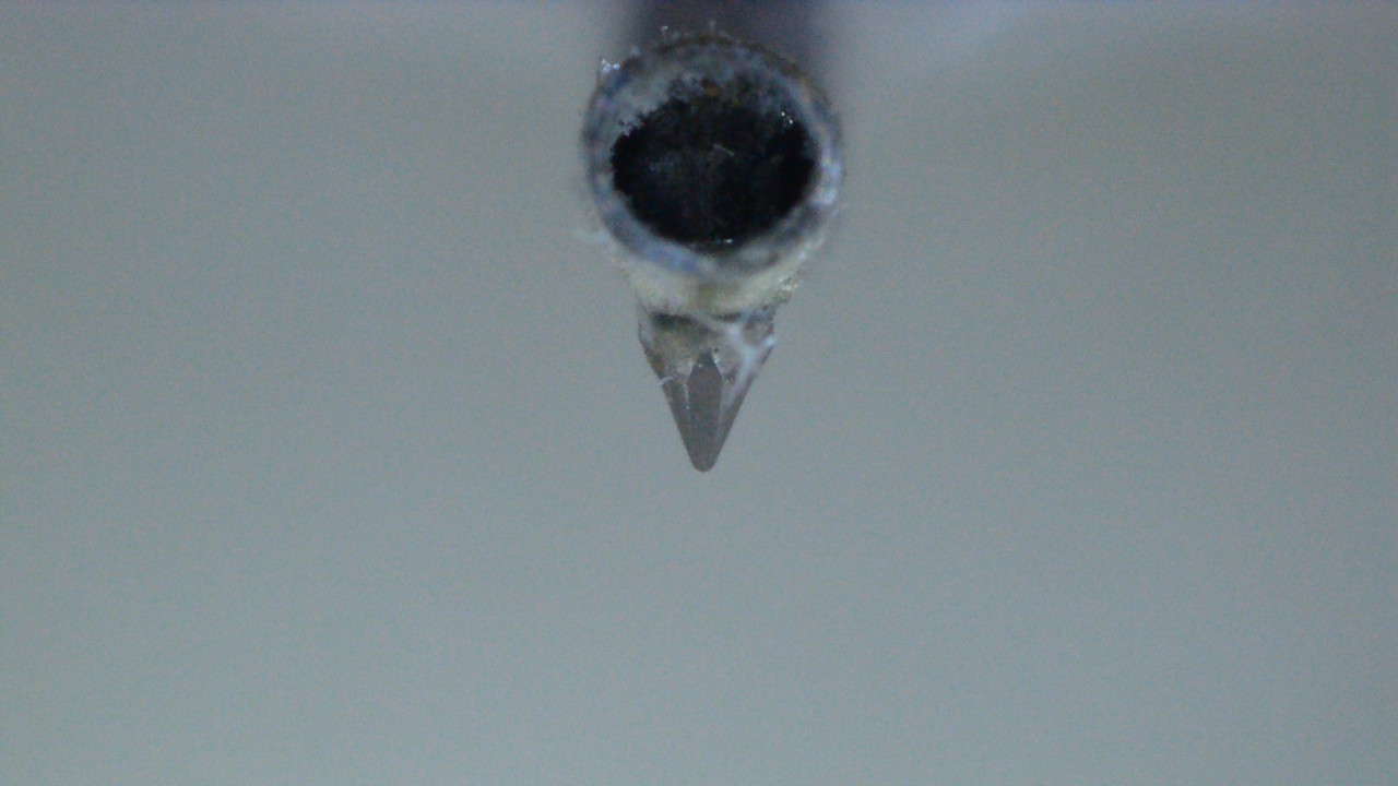

I ordered a pretty cheap one off Amazon a few years back (2021?). It's been great for my purposes of general stylus inspection. Claimed 50-1000x, 1080p. Now, this one is no longer sold so the issue has become the software. The app is no longer available/supported, so I had to find another USB microscope app to use it which somewhat limits functionality, but still lets me use it for my purposes.
As far as image quality goes, I can pretty clearly see the facets on the Shibata styli I have, and gauge the "sharpness" of a stylus tip, and see general cleanliness. I'm sure there's better scopes but if I can see all of that, this $40 scope is quite sufficient for me. I would imagine even the cheap ones have improved beyond this in the last few years as well.
USB microscopes are handy but don't have the magnification required to do serious stylus evaluation. Facets are visible but the wear spots on the stylus tips are out of reach. They are still useful though. I bought this one and added a stand with lights that can be used to show up the wear spots to some degree but it is no substitute for a true binocular stylus microscope.
These are examples of what that microscope can do. Note the two little points of light on the tip of the stylus in the first picture. Those are reflections from the wear flats. This is a new Grace luminal trace stylus.

They might not work for your purposes but as indicated by the photos posted they do work within limits. As long as a person understands what those limits are and their purpose can be achieved within them, they are quite useful.

The pictures posted above are imho not sufficient to judge stylus wear. They look great, but not enough magnification.
