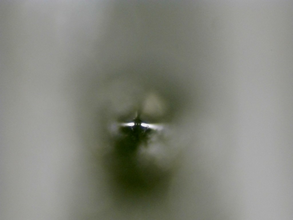

I got the microscope in. Still getting used to how it works. Currently the maximum magnification is as shown in the pictures attached. I believe the current magnification max is around 45x.

What eyepieces are in it?
Chris
10x ones, I ordered some 20x pieces and a barlow lens from AliExpress. The eye pieces have arrived (still waiting for the barlow lens) now I get this image, supposedly 90x zoom now. The barlow lens I ordered was 2 or 3x I think.
Also turn off lower lamp and illuminate from above. You can get side swan neck lamps or ring lamps off ebay
