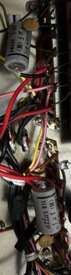

Also went back and replaced the two oil caps for new film caps. No idea what they do but the old ones are gone.
Old:
New:

Those oil filled caps are usually there to keep the power switch from arcing internally and burning up the contacts when you turn it on and off. I don't have a schematic for the 930 but depending on exactly how the caps are wired, you'll probably want to replace them with either an x or y rated 250VAC safety cap.
