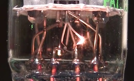

This video clearly shows the origin of the flash is in the length of uncoated filament between the pinout weld and the coated section. To me, it does not appear to be concentrated in one tiny spot (relatively speaking ) as if there were a damaged area. Instead, at the midpoint between two heat sinks, so to speak.
Roughly 4 min 3 seconds in.
Although that tech tips video is just one sample, it does suggest the level of manufacturing 'tolerance' that can occur (ie. one heater has negligible bare filament, whereas the other heater has obviously substantial bare filament).
As I see it, heater flash appears to be related to the length of uncoated filament wire between the pin terminal and where the coating starts on the filament. Manufacturing tolerance of wire diameter, length of uncoated filament, and possibly the choice of wire type (ie. temp coeff of the filament) may influence the degree of flash.
The filament current starts with a peak that then drops as the total filament resistance increases. The flash occurs during the first few seconds of applied voltage, when the current is relatively high (but decreasing).
Alumina coated filament has higher thermal mass than bare filament, so initially increases in temperature at a slower rate than uncoated filament.
As the uncoated filament rises in temperature, it cools by radiation to an effectively constant ambient temperature. The radiation transfer increases dramatically for the uncoated wire as it approaches incandescence, due to the rate being proportional to Temp to the power of 4. The reducing current, along with the increasing temperature and hence thermal transfer results in the filament temperature peaking and then subsiding within a few seconds.
Given the low number of flash events (cold turn-ons) in service life, the ability of the wire to operate at incandescent temperatures, and that normal operating temp is well below incandescence, then heater failure from that situation is anecdotally a rare event, and probably related to the small percentage of the population that are at the extremity of one side of a likely bell curve.
If there was a comparison made with the common incandescent bulb, then it would markedly differ in that the tungsten wire sublimation during operating hours would be substantially less in a valve, and so bulb failure during turn on would be substantially less as the wire thickness was not being significantly eaten away over service lifetime.
Edit: link to image of flash as it is subsiding - showing the location of hottest region of filament.

Sigh. Yes, I am familiar with this video and Carlson's excellent work documenting this problem and his simple solution (run with limited current via a resistor until the filament is hot then use a MOSFET to switch to unrestricted current).
The heater flash clearly occurs at the welds. Carlson even noted this. What is your point? That the coating prevents it? No, that's wrong.
It isn't that the problem is prevented by the heater coating, it is that the structure of the tungsten has been deformed and altered by the welds and is thus more prone to overheating probably, because the tungsten may be thinner there or be an alloy with even worse properties or both.
Making tungsten involves a difficult process of swaging and drawing, and the resulting structure is fragile and prone to damage. Tungsten is a brittle metal whose working is difficult, which is why it is primarily sintered. The Larson-Miller relation explains how the grain size alters and the filament elongates during heating and this, beyond the problems from simple metallurgy, is exacerbating problems at that weld junction.

Sigh. Say what you will, the video shows it quite well.
I was preparing my response while you posted yours.
It isn't tolerance, as I explain above, it is metallurgy. The weld has different composition and is more prone to overheating. Again, this is a disturbance in the tungsten grains and crystalline structure.
Metallurgy from the weld. Has NOTHING to do with the coating. See the thermal conductivity explanation above.
No, that's wrong. Look at the thermal conductivity. The coating doesn't slow down the heating. That's running as a function of current through the wire, and tungsten wire is known to suffer from hotspots as a result of manufacturing issues.
Ummmmm, that's what I explained. Had you ever heard of the Stefan-Boltzmann Law applied to tube heaters before I wrote about it a few pages back?

Just because it's You Tube doesn't mean it's wrong.
Guess I'm just too stubborn to give in to a "scientific beatdown" when there is something so apparently obvious right in front of the eye, caught on camera.
I've never before heard physics called a "scientific beatdown".
What is obvious is that you are ignoring the metallurgy at the weld (where the effect occurs) and the physics.
How do you explain away the physics I explained in detail?
I don't, nor was it ever my point to do so.
I'm simply suggesting the origin of the flash phenoma presents itself quite clearly in the video. And, the point of origin also appears to be coincident with the lowest thermal mass in that vicinity - the unusually long portion of uncoated filament.
Also, if this is predominately weld and heat affected zone, that doesn't seem to explain why the three other filament welds and heat affected zones thereof in the exemplar tube (that in the video) do not exhibit the flash.
The alumina is a far poorer thermal conductor than the tungsten. It simply can't do what you claim. The physics doesn't allow it. My explanation of the phenomenon is simpler and does not rely on the coating's properties which, if your explanation was correct, would contravene the laws of physics.
The heater flash is at the join to the wires exiting the tube.
