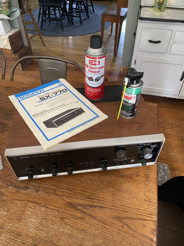

I'm a first-time poster, but long-time reader. I'm 20 years old and quite into vintage stereo equipment. After successfully recapping my JVC Ja-S22, my grandfather asked me to take a look at his old Pioneer receiver that he purchased back in 1970 while he was stationed in Germany while in the Air Force. It's a Pioneer SX-770, complete with all of the service manuals, etc. When I recapped my JVC, I had no trouble finding equal value replacement (nice ELNA and Nichicon) audio-grade caps on Mouser using a parts list from an old service manual I found online. I was quite happy to see that he had all of the original papers, so I figured this would be an easy project. Unfortunately, this was not the case... As it turns out, many of the caps listed in the manual don't seem to be manufactured anymore, at least by ELNA or Nichicon. Examples include 10uf 10VDC caps that litter the surfaces of almost all of the boards. Furthermore, other than cleaning the pots and switches with Deoxit, I wonder what really needs to be replaced and what doesn't. I have no problem buying and soldering as many parts as the stereo would need, but the manual seems to be laid out in a confusing manner.
Essentially, I want to fully-restore the SX-770 for my grandfather so he can enjoy listening to his favorite music on the stereo he enjoyed for decades prior.
It currently "works", but is riddled with many problems, such as:
- Dead Phono channel
- All lamps are dead (I'd like to find some nice LED replacements)
- Horrible, loud popping/crackling when Balance/Bass/Treb/Vol knobs are touched (at any volume)
Basically, I'd almost rather replace everything (within reason) and fully restore the entire unit, rather than spend time troubleshooting to replace a few broken components. Has anyone fully gone-over one of these units before? Would anyone be able to provide me with a complete list of capacitor values that would need to be replaced? What about Fuses, Lamps, Transistors, etc.?
I would love to hear any tips from those of you who have experience. I'm all ears Many thanks in advance!

First step is to hose down all pots & switches(if accessible to contact cleaner) to clear up the scratchiness issues. I use CRC QD electronic cleaner, since it's readily available at the big box hardware stores. Caution! not all such items are plastic-safe! Ask me how I know. After that, give a listen, then proceed if other problems show up. You may likely have to at least recap the power supply, then go from there. Shotgunning parts can lead to unwanted consequences. replace what is needed.For bulbs, the easiest thing will be new original-style incandescents, LEDs may require more work for satisfactory results, as they are sometimes more directional as to light projection and may need resistors to "light right". If bulbs are on an AC buss, stick with originals. @dgwojo can usually provide these, for cheap. So, clean all controls & proceed accordingly. Lots of coaching here to help!
Thanks, @Catmanboo!
I'll give everything a good cleaning first before messing with the soldering iron... I had really good results with LED axial lamps in other receivers, but I'll look into this more for the Pioneer. I appreciate the advice!
Hope it helps. Keep us posted on results, usually a good cleaning clears up all issues. I have several receivers I need to hit with same, always with the desired results. If you put LEDs on AC. they tend to flicker at 60 Hz, noticeable, so it sux. Incandescents react slow enough to not notice, that's why the mfgrs used them. Besides, that's all that was available then.

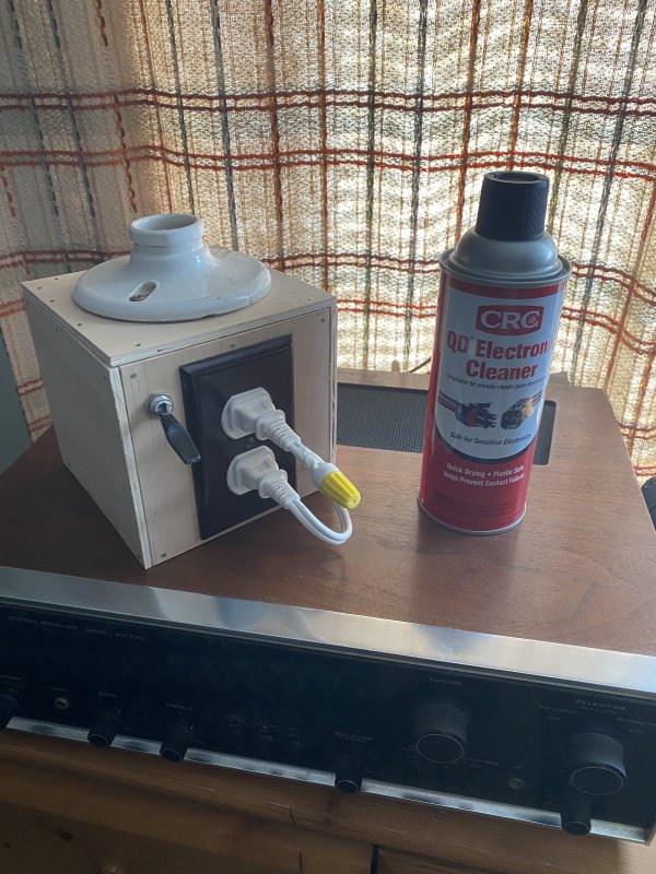

Build a DBT before you replace any components!!

DBT: Dim Bulb Tester diagram pictorial... please feel free to copy and post.
A vital piece of equipment that may save you its cost 100 times over, in blown expensive components.

Just looked into the DBT. It’s a great idea to prevent shorting and frying components. I’ve run into problems with caps not fitting (larger 3-pronged snap-in caps), but was able to find some adapters on eBay that worked quite well. I’ll have to see what I’m looking at tomorrow when I try to decipher the service manual again.

Sorry for the delay, I spent most of the day getting the DBT put together. I was actually able to find everything I needed in my grandfather’s shop. He was happy to help! The cleaning solutions also came in the mail yesterday, so today I’ll be cleaning all of the contacts. I’ll try to send some more pictures of the manual, but I like the idea of looking directly at each board individually. More to come!
A bit about cleaning switches and pots. The QD will remove any contaminants that have gotten into your controls but will not affect any corrosion, it will leave you with clean corrosion. Deoxit D5 breaks down corrosion so that exercising the switch will wipe it away. D5 cleans pots too, but also removes lubricant (so does QD), they will wear out quickly without lube. Deoxit F5 replaces the lube in the pot, protecting the resistive surface. Get some D5 as well for your switches. Switches don't need F5.
Just sprayed the switches and pots with QD. I’ll give it some time and hit it with the F5. I’ll have to pick up some D5 if the problem persists. I’ll keep everyone updated!2C822714-0C10-4FD4-B844-24606DC7A5B2.jpeg
