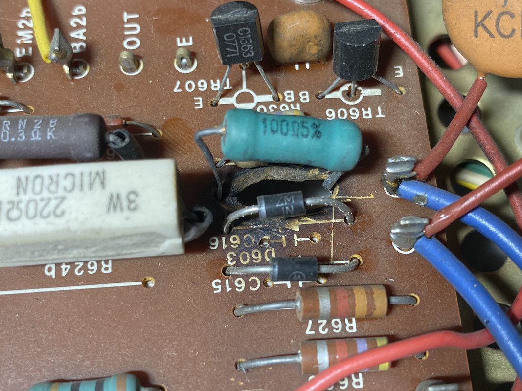

I was able to snag a cheap Sherwood 7100A after reading a ton of positive reviews about it on AK. It has a very weak left channel (seems to be common), so I decided to use that as my motivating factor to replace everything I can for my first project. Although, I've run into a few issues that I need help with.

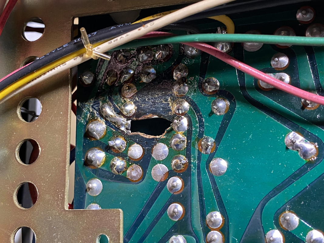

Burnt hole in circuit board
After opening it up, I noticed a hole burnt in the PCB. According to the schematic, this is power supply board territory. Multimeter shows the light blue (don't see another 100ohm one anywhere else) and two bordering resistors are not zero'd out. Unable to test diodes since they're still connected.
Should I be concerned? Any recommendations for improvement?

I am not entirely sure what "zero'd out" means in this context. Maybe that they are not 100% straightly bent and don't keep the original distance to the PCB? If that's the case I don't think this is a reason for concern. Looks to me like that resistor has plenty of space to breathe for the moment. The original resistor probably burned at some point in time leaving the PCB burnt too. Someone most likely has used an abrasive tool like an engraver / dremel or a knife to remove all of the PCB material that turned to carbon to eliminate the short circuit it creates. Afterwards the new resistor was patched on. It's also possible that the heat of the resistor, in case it gets rather warm, over time carbonated the PCB and this may have lead to the resistor failing and burning. I don't really see a problem with this repair if all carbon was indeed removed.
Hey! I'm new to this, "zero'd" out just means my multimeter showed a reading. That very well may not be an effective way to identify a shorted component.
It's good to know that it doesn't seem like a concern. Should I clean up the bottom with some 99% isopropyl alcohol?
Also I wonder: will this get worse over time? It's possible the new resistor did the trick. If not, I definitely want to prevent any further degradation if possible.

oh that got toasty. The resistor stuck through the hole is a functional fix but its never going to be pretty. Not really much you can do to make it pretty either honestly. I can't blow the schematic up enough to read and I can't grab a full res copy right now but often when this happens either something failed and caused the resistor to grossly overheat, or in some cases its just really bad design. With that big of a hole, I'm going with something failed in the past and this was the repair. If it was a design problem the replacement resistor would also be pretty cooked looking and it doesn't appear to be so.
My advice here would be to get it working first, replace only what absolutely has to be replaced in order to accomplish that. You can go whole-hog later but I prefer to introduce as few variables as I possibly can when working on stuff. Once it works, then I'll change parts for preventative maintenance reasons.

After some further digging (AK thread here), it seems this resistor is known to overheat in the Sherwood 7100A due to being severely underpowered. It looks like a metal oxide replacement (flame proof) was subbed in and has been operating properly ever since. I'm fine with "ugly," as long as everything works so I feel good about it now. Thanks for the input everyone!
Since I'm using this as my first refurb project, I plan on replacing caps and transistors anyways (for fun and practice!), so I'm confident that should resolve the weak channel issue and ensure everything runs a lot cooler. Will update!

Good point about the cooked looking resistor in case it would get rather hot.
What we (as a company) did to fix holes in burnt PCBs when we were repairing them professionally was to mask off one side of the PCB with some Tesa clear tape an then fill the hole with epoxy and fibre glass filings. Burnt traces can be fixed by wires or solder wick Sometimes. Depends on the shape of the traces / copper plane. I've also hammered flat some silver wire (tinned copper wire) in the past to fix a broken trace under some IC chip where normal wire wouldn't have worked so well.

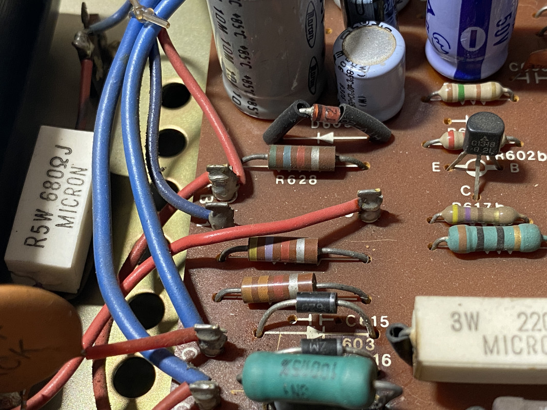

@LEECH666 comparing to a picture of someone else's unit, I was able to confirm the two black diodes have indeed been replaced as well with 1N629 diodes. I assume they were damaged by the burn.
I don't suspect any other diodes are bad, so probably best to just leave them be right? Replacing diodes and resistors don't seem to be part of a "common update," unless they're suspected/identified to be bad or historically problematic.
Yeah that sounds about right to me. Maybe some of the AK gurus can chime in. The question to me is: is the Sherwood working fine atm? Then I wouldn't replace anything besides maybe the common offenders that you've mentioned and that would be it. By far the most common update for a working unit is to replace the capacitors (minus the PSU reservoir caps, the big ones), imo.
Yeah that sounds about right to me. Maybe some of the AK gurus can chime in. The question to me is: is the Sherwood working fine atm? Then I wouldn't replace anything besides maybe the common offenders that you've mentioned and that would be it. By far the most common update imo is to replace the capacitors (minus the PSU reservoir caps, the big ones).

never seen a specific list, but those old brown square shoulder jobs look like carbon composition, and thats pretty much the entire list of resistors that are known to be problem children. Carbon film or metal film are both quieter and less prone to drift, metal film being the quieter of the two though.

Since this repair was performed before my ownership, I'm more concerned that it was done with the right parts. Soldering seems to be fine but trying to determine if large resistor (100 ohms) and diodes (original V03C) are correct. Best way to find model numbers of the replacement parts to confirm?
Btw, anyone know what kind of resistor this is? Easily dwarfs every other one on my board. Closest visual match I can make online is a metal oxide resistor which have some bulk (like this).
Not sure, was going to comment on that earlier but my "swag" (sophisticated wild ass guess) is it could be a wire-wound. It's my understanding that the large ceramic-encased power resistors like the 3 watt in your photo are wire-wound. In rf circuits this can be a concern in that wire-wound can also act as an inductor if in coil form but idk if this presents a problem in audio applications.
Ye ol' carbon resistors can last a very long time but of course heat and material degradation will have a negative effect on lifespan.
The example in your link says "Technology: Metal Oxide".

you shouldn't be "hearing" resistors especially in the power supply. If they aren't off value or causing problems you can leave them be. Any noise they add should be taken care of with the filter caps. Its the stuff on the emitter or collector of the transistors in audio circuits that you are more likely to get noise out of.
I'm not sentimental about old parts, but I'm also cheap and lazy so stuff that isn't currently and isn't likely to cause a problem I leave alone. I also do not care to feel like I'm at the beach on a windy day when trying to listen to music so noisy stuff in the signal chain can go away.
big resistor is wirewound, if you smashed open the ceramic box you'd find a core with wire wound on it, stuck in a box and packed with what is essentially tile grout to hold it all together. They basically work perfectly and stay on value, or they burn open. Not much in between so if its working and not physically falling apart I would leave it be.
unless you mean the blue-green one. That one could be wirewound or metal oxide. Both are common for high power work.

Yeah, meant the large blue-green one! I'm probably going to replace it with a modern film equivalent so I know it's right. New one will be much smaller as well.
