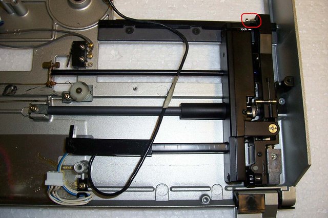

Is the plastic record size switch supposed to be loose till the cover is placed back on over it? Or is it supposed to lock in somewhere and already have resistance before that?
I think I missed the part in the SL7 manual where it shows how to replace the dust cover without breaking it. No, I did not break it I am venturing very slowly into this. I wish to preserve this turntable as best as humanly possible.
Now the plastic switch is being a pain in the ass to properly set but the other minor issue is replacing the dust cover correctly without feeling as if I am going to damage something by forcing it too quickly.

The center of the top lid, where the record stabilizer goes, has a screw with a little disc or washer. This difficults the lid to be fitted, so it's better if it's removed.
You can see it here, at the center of the image:
The part I am having the most difficulty with is aligning the plastic record size switch that is easy to get loose if not placed exactly right, and also fitting the bottom part of the top lid back.
Use masking tape or electrical tape to keep the switch in place.
The top lid needs to clear the tonearm, it helps if you move the tonearm away from the rest position, by turning the tonearm motor spindle by hand (it takes time)
Masking tape? It's suppose to have free movement though.
