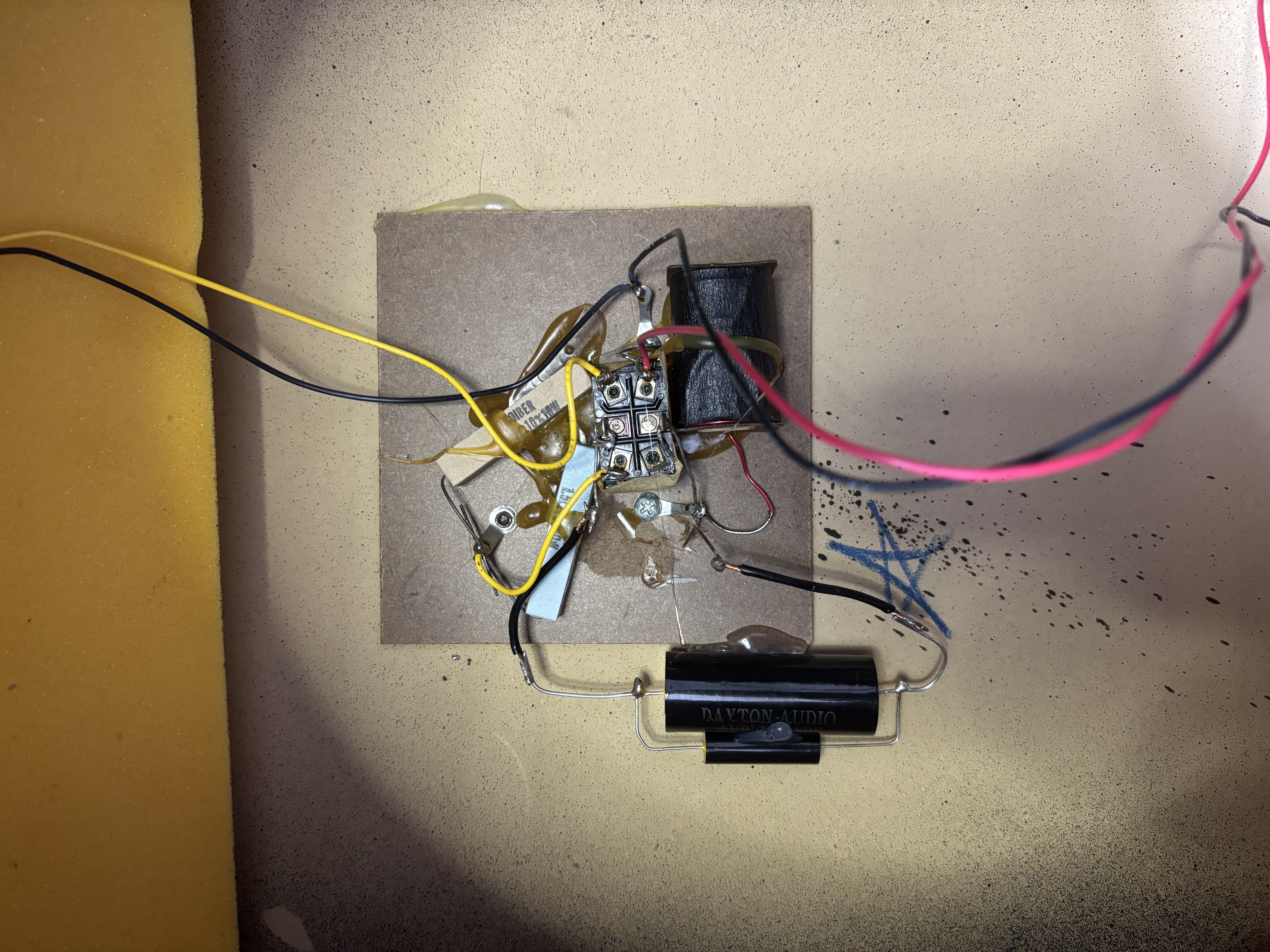

I replaced the caps and resistors in mine today... super easy job.
The old caps measured 14.5 uf and 15.8 uf, so most likely changing to the 13 uf didn't do much to the crossover point... maybe raised it 1-200 hz. I couldn't tell much of a difference between them when I tested the first one I changed compared to the original.
But the actual 'repair' is that now the switch works on each speaker due to all 4 resistors being broken (open circuit on each). The 'normal' position sounds best in my room for most music... the only position that worked prior to the repair was the enhanced, which was just a tad too much for me.

Mine are literally identical to @kmagnuss ‘s speakers. I actually don’t have a picture of the rear but again, identical so nothing different to show. Here is the front and my crossover…

@drumbum I pulled a woofer and tried to get a measurement but it won't give me one... do I need to unsolder a side to get a value like on receivers?
Technically, in both cases, the wrong surrounds were used. They should have just a 1/8' flange around the outside to just fit onto the little ledge on the frame. The outer flange should not extend up onto the angled part of the frame.
If the right sized roll is present (17mm - 18mm) it won't really make any difference as long as the outer flange is well adhered to the frame. However, the roll in both cases, again, are technically incorrect. They are too small. They appear to be only about 12mm - 13mm. Electrical/acoustic measurements would have to be taken to determine what difference, if any, there are compared to drivers with correct surrounds. The smaller roll WILL restrict cone travel.
