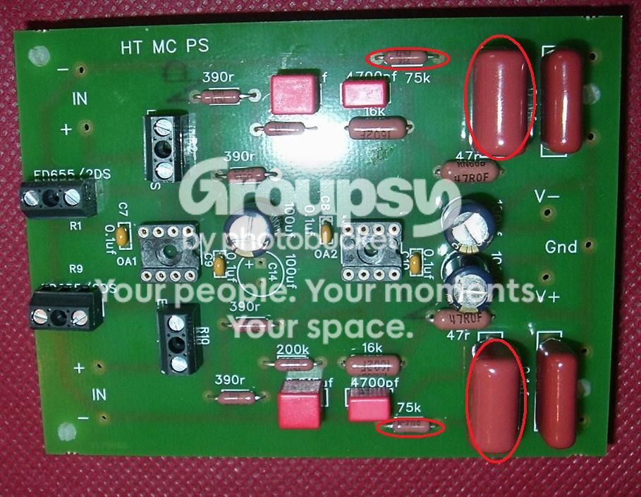

Thanks for the update! Just to clarify on the recommendations....
Cap replacement at C5 & C19 with 2.2uF and resistors at R8 & R16 to 200k, am I correct? (there seems to be no other options I guess, but better to be sure than sorry)
I have all the parts in a bag, but I will update with new parts. I will be building few boards in next couple of weeks.
Thanks again for the update
You are correct. Here is a pic with the parts to replace marked in red to make sure everyone is on the same page.
As for the terminal blocks the part numbers are marked on the PCB. ED655/2DS They are available from DigiKey but any other small twin terminal block with 7mm leg spacing will fit.
So is this the current recommendation for all HTMCPSs? C5 & C19 from 1.5uf to 2.2uf and R8 & R16 from 75K to 200K? Any other part changes before I order?
Thanks
I have HTMCPS running with latest update above by Hypnotoad with replaced value resistors & caps and it is singing nicely. Never tried with 75k resistors & 1.5uf caps, but 200k & 2.2uf set up has nice deep & low extended bass.
