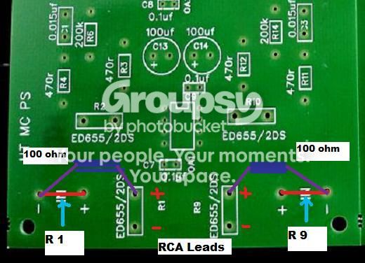

I have built this phono. Thanks to Sachin for the printed circuit board. I have a problem with it. I have very low gain when used with my cartridge which is a hybrid ie: a cross between a moving coil and a moving magnet. It is a Pickering XLZ7500. It has a resistance of 3R and an output of 0.33mV. The value of R1/R9 is 3R and that of R2/R10 68R. I am at a loss to understand why this phono and cartridge combination does not output appropriate gain. The volume of my amp must be fully up and then the sound is noisy sshhh and low. I do not understand why it will not work satisfactorily. The cartridge presents a voltage output, just as a moving coil cartridge does. The cartridge also has an impedance, just as a moving coil cartridge has. To my mind it should work.
Has anybody else tried this combination and what were their results?
Any help in resolving my problem here would be gratefully appreciated.
Incidentally I have played around with the gain of the first stage by trying various different values of resistance in the feedback loop, but to no avail.

This cart will not work with the HTMCPS as it's a low output MM design not MC.
Thinking out loud about this though, if you are using the terminal blocks for R1/R9, it might work if you were to remove resistors R1/R9 and remove the leads from the input RCA's. Connect the RCA input leads with the positive on the connection closest to the opamp positive input and the negative lead on the furthest connection.
Then place resistors R1/R9 between where the positive and negative RCA inputs used to be. You will need some resistors for impedance loading say 100ohms placed as shown, you can solder them to the underneath of the PCB.
You would be in effect converting into a regular preamp input instead of the transimpedance design. It should work fine but I can't guarantee how much noise you will get.
It should work fine in theory, but no guarantees. You will of course have an inverting design so it will be out of phase but there are a lot of preamps out there that do this, and people don't even notice it.

Thank you for this. I tried it this afternoon. Gain was good, sound was good, but unfortunately the background shhhhh, as expected was too much. Anyway back to the drawing board. As it is a regular preamp now, could I reduce the gain of the first stage and then use this phono for a moving magnet cartridge? The input impedance would need to be changed too.
Most of the opamp phono circuits I have seen are not of an inverting design, so it could be quiet interesting, if feasible to see how this would compare to the more common non inverting designs.

That's what I figured, you would probably be better off building a CNC and keeping the HTMCPS in case you get a moving coil cart.
But if you want to use it as a regular MM stage increase the value of the 100ohm impedance resistors you put in, try the standard 47k for a start.
And as you figured you will have to decrease the gain a lot though.
You should try R2/R10 at 2k ohms, R1/R9 at 100ohms this would decrease the gain and noise of the first stage to around the correct MM levels.
This is for a regular MM cart and not the one you have.

Thank you again, yes I have built the CNC, but I am just curious to see how the HTMCPS would sound with a regular MM cartridge. It would be no problem to reverse it back to a MC cartridge phono, if I ever get a moving coil.
I will let you know the sonic results when I have changed the components you mentioned.
