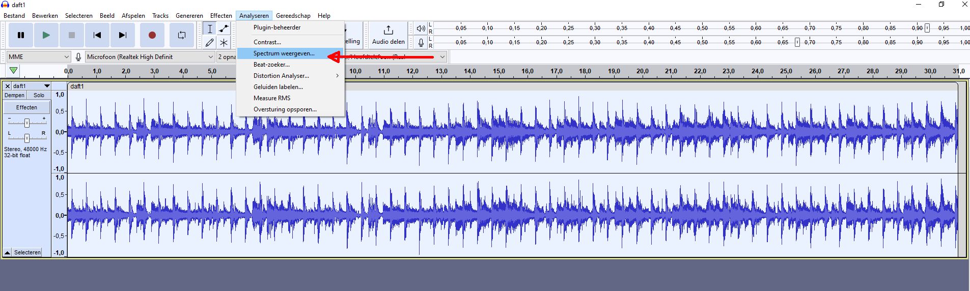

So you have to make a recording with a line in. A microphone won't work. Some modern higher end laptops have a 3,5mm jack that can sense what kind of 3,5mm plug is inserted and when it's a stereo plug it asks if it's a headphone or line in. Most other laptops have a combo jack but that is purely suited for a headset. So a microphone plus headphones, no line in.
But if you manage to get a recording by line in, this is what you have to do:
So this is a screenshot in my mothers tongue, but I guess you'll understand. You make the recording (the wave pattern you see). make it at least 1 minute, and select the track (ctrl+a). Some versions have a select limit of little over 2min, so any recording under 2min is ideal.
Then go to analyze->display spectrum.

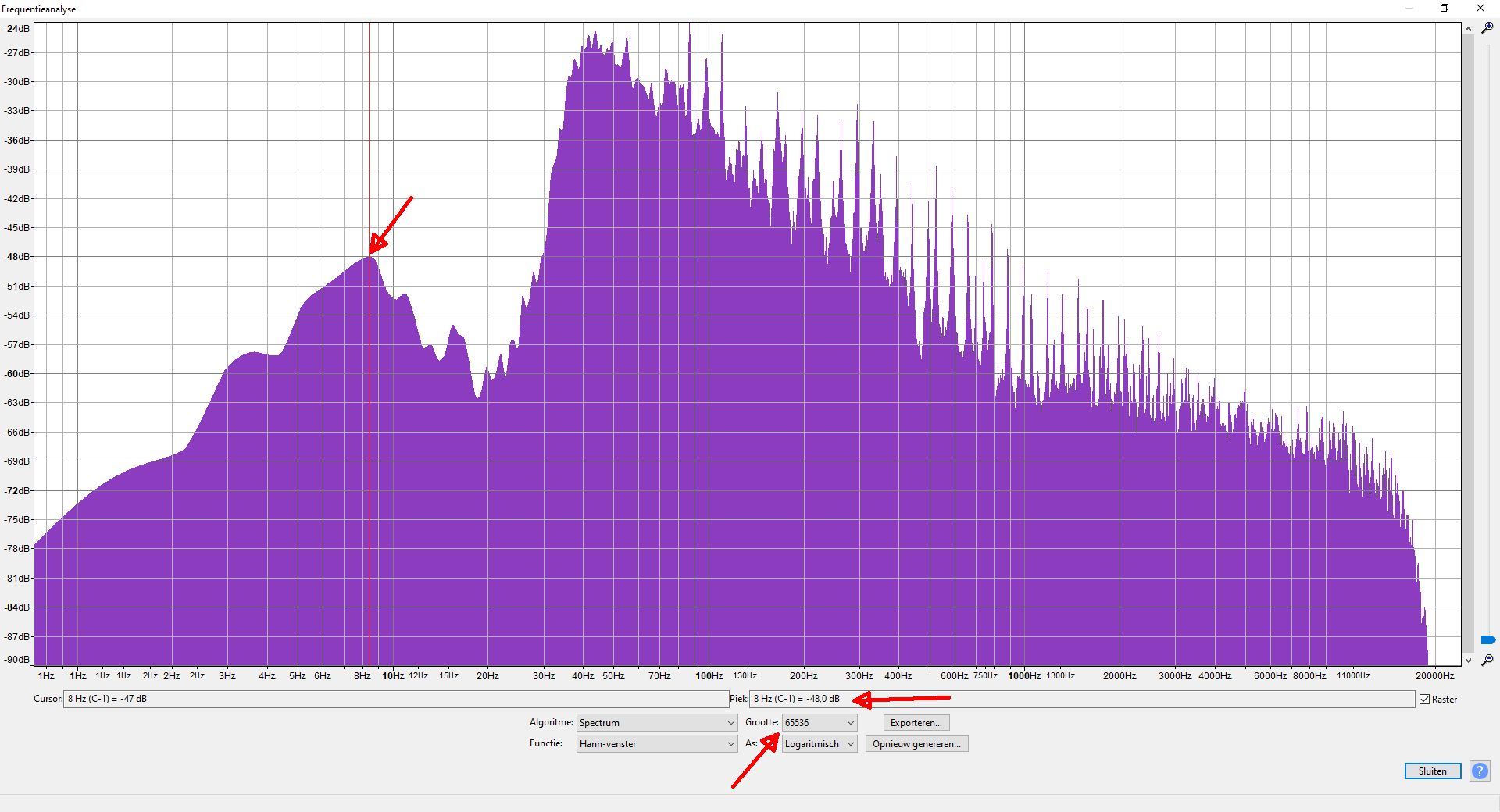

Then you get this:
Set the sample size to 65536 (bottom arrow; higher numbers gives too much information)
put your cursor on the highest peak in the low frequencies (red arrow), so there will be a distinct peak, around 4-12Hz.
The peak will give the frequency in the bottom (other red arrow). This is a rounded value, in the graph you can see that the actual peak is somewhere between 8 and 9Hz (the red line), but who's counting.
Then you get this:

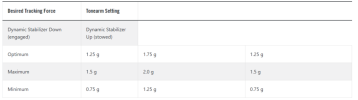

Also If you want to get into things you are not even correct as the user guide for the m97xe says to use anywhere from 1.25 to 2.0 grams with the stylus guard engaged.
2.0 is too heavy. 1.25 is too light. Manufacturer give a range, and we know how ridiculous “ranges” can be for styli. Don’t we? Ridiculous ranges date back decades; just read the 3rd party testing results in the major audio magazines. I just don’t see the utility of testing for resonance at VTFs outside of the competent tracking range of a stylus. You may get a 10 Hz resonance, but what good is that if the stylus is mistracking? SMH

Your sytem effective mass is high (30,7 g), so you're in for a very low compliance cartridge - 8 µm/mN for 10 Hz, which may be difficult.
On the other hand...take a peak.
So conclusion, get a lighter headshell and find something medium to low compliance or if it's high compliance it needs to have a brush ? Any recommendations for low compliance carts in the 500 usd range in that case?
