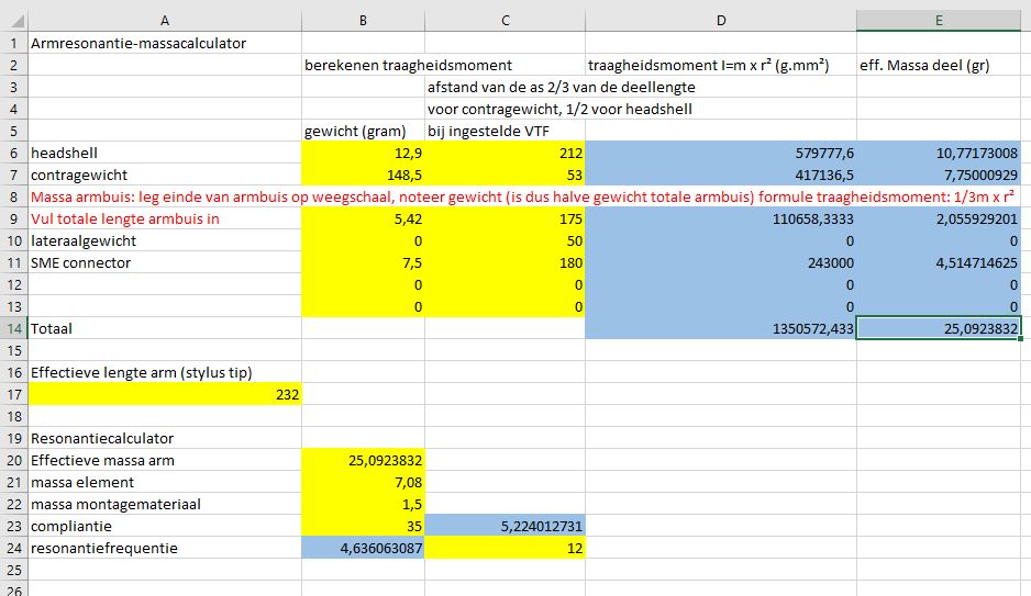

Ok so here are the results:
Arm wand weight = 12.92 grams :
Arm wand to fulcrum +-=18.7 cm
Headshell weight = 11.92 grams :
Wire weight = 0.98 grams:
Screw weight = 1.53 grams:
Shure cartridge weight = 7.08 grams:
The screws, bolts, washers and the wires being right around 2.5 grams would make up the missing 2 grams though the headshell weighing +- 0.58 grams less than advertised seems fairly weird, maybe the weight advertised is with the wires?
Headshell weight is always with wires, but without screws.
Your screws are probably stainless steel as they weigh 1,5gr. Aluminium screws typically weigh 0,5gr. So you can save 1 gram with that.
My effective mass calculation of your arm is 25 grams.
There are some assumptions, like how much the sme connector in your arm weighs. They can be anywere between 6 and 11 grams, but in the end that difference might effect the calculation by only 2 grams or so. It's not gonna turn this arm in a medium or light arm. It's a heavy arm.
(I took 7,5 grams for that connector, so the armwand itself is therefore about 11gr).
For this arm, a low compliance cartridge is optimal.

Normally, the tonearm's effective mass is including headshell. How can you tell? if it's below 13g, it's virtually impossible to come to that eff. mass with an SME style headshell.
Best way is to actually weigh as much parts as possible and do the calculation yourself. Lots of tonearms have quoted eff. mass, or eff. mass written all over the internet from which I'm sure that that isn't correct.
Looking for low compliance cartridges is pretty difficult, most of them are MC and if you want one with a more advanced stylus and cantilever, they usually start at around €500
And a lot of them are still fairly high compliant.
The most difficult aspect is that with most japanese cartridges, the compliance is given at 100Hz. That is a measure for how well it tracks, and has nothing to do with the 10Hz resonance. There is also no real conversion factor, despite what most people on the internet will tell you.
As for the required resonance frequency, most sources will tell you that the target value is between 8Hz and 12Hz.
That said I'd rather have 8Hz than 12Hz, and I think you can go little below 8Hz.
The higher value is a value so that the resonance can't be excited by the lowest notes in music (typically ~16-20Hz).
The low resonance value (8Hz) is chosen so that warps in the record can't excite the low resonance.
However, if you have less warped records, the problem is also less.
Typically, warps have a frequency between 1 and 4Hz I guess.
So if you're close to that, say 5Hz, chances are the stylus will loose contact more easily when going over a warp (or becoming less stable on the warp, resulting in a big shift in balance from left to right in the music) than cartridges that have a higher resonance in your arm.
But it's not only the resonance frequency that determines that. Damping is another factor. This is a parameter that is not specified by cartridge manufacturers.

I also did a rough calculation and got to a resonant frequency of -+ 6.6Hz so excluding calculation errors it seems to line up. Now, I wanted to ask a few things if you do not mind.
1: Do these spectrums look natural? My previous attempted measurements had some weird things in the lower frequencies, is that still present here?
2: Is a resonant frequency of 6 Hz a possible cause of an emphasized low end? Or would the only real result be worse tracking performance?
Thank you.

1. Both spectrums look normal. There's a clear peak. It's normal that you sometimes see some smaller sub peaks. A number of these lower peaks are also the result of the calculationmethod used and there will undoubtedly be some smaller resonances on different frequencies. But the main peak here is ~10dB louder so it's clear where the main resonance is.
2. No, the resonance frequency has nothing to do with a low end. What we call low end is ~25Hz to 50Hz or somewhat in that frequency. The 6Hz is totally inaudible.
If you have a resonance frequency that is too low, you could get effects like if you have a warp, you hear a shift in the pitch in mid tones (500-2500Hz, where the ear is very sensitive). That kind of things. And if you have wooden floors and walk etc you could hear it too. But it'll always be something like a tremor in the mid tones.
So would a 6Hz resonant frequency be acceptable? I just did some experimenting with a lighter headshell (really cheap but weighs around 7 grams with wires, screws weigh 0.5 grams) and I barely got to 7 Hz. The spectrum looks like this:
The peak is at 7Hz but for some reason there is also a peak at 6 Hz. No clue why that happens.
I tried it with an extra weight on the headshell of around 0.9 grams (and adjusted the counter weight) and it was at 6 Hz again:
Seeing this, is there even a point in using a lighter headshell when the resonant frequency with this particular cartridge stays at 6 Hz from 8-12 grams atleast? I understand that that is probably going from like 6.4 to 5.6 but as mentioned earlier in this thread the jelco hs-25 is a much nicer headshell. I ordered a jelco hs-50 mk2 which is supposed to be around 2-3 grams lighter than the hs-25 (and as far as I am aware the hs-50 is the original headshell for the ts-350 regardless) so I will likely be using that when it arrives. I just want to figure out whether using this cartridge even makes sense. I did pay quite a bit of money for it and while I can probably resell it for the same amount, I'd prefer not to deal with the hassle of doing that and finding a different cartridge to use. Ofcourse if it is truly just not a great match I'd do it, but from what I could find online 6Hz seems to be right on the edge of what is 'reasonable'. I understand that 6Hz is not low end, my speakers don't even go below 40Hz. I will also be picking up an oem version of a sa-250 arm later today which supposedly came shipped with an ortofon 2m black from the company it was sold by. From what I learned in this thread and the specs I found online this should result in a resonant frequency of around 6 Hz as well (13.39 effective mass without headshell, shipped with what looks like a rebranded hs-25 which would be +- 12 grams, cartridge weight of 7.2 grams and 22 um compliance) which results in +- 5.94 Hz. Is this just negligence by the transrotor (the company that sold the arm and cartridge combo) or does this have to do with the characteristics of the cartridge? Or Am I doing something wrong, I do want to note that using this same calculation the resonant frequency of my current setup should be 6.8 so chances are the resonant frequency of the ortofon black setup will be more in the 5Hz range.
So seeing all these results the conclusions I would draw are that 1 tracking force in this instance doesn't really affect the resonant frequency much and 2 the brush does infact get the resonant frequency within an acceptable range. However without the brush the 5 Hz doesn't seem to be that far off from what is acceptable. If anyone could help me make sense of what I could do with this information and also why the brushless stanton results are kinda messy (unless that's just due to cartridge issues) that would be fantastic. All these measurements where done using the same headshell as discussed earlier.
It all makes sense to me.
You have a heavy headshell, with the cartridge and headshell alone the combination is a high mass one (21gr). The M97xE is a rather high compliance cartridge, 5Hz sans-brush is not surprising. The Shure brush acts a hydraulic damper -because it does have silicon fluid on the bushings- and thus changes the results. The Stanton brush has no silicone fluid, it is there just for cleaning the record.
Although it sounds reasonable, I still got a problem, beacuse I can't pinpoint the ~0,7 Hz difference compared with your measurments of ~5 Hz. What bothers me the most, ist that the compliance stated is static, which to my "knowledge", is at 0 Hz. Of course, nobody knows a conversion ratio to 10 Hz either. The difference could as well be accounted to aging suspension or to production tolerances...or all of them reasons.
All of these formulas for compliance are questionable and shouldn't be relied upon, because of many reasons, one reason is that cartridge suspensions are different and some have narrower (high) Q-factors other have low Q-factors.
There are other reasons and the best explanation and tests are here in the Korf Blog. Required reading!!
