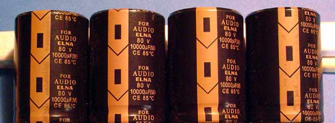

Looks pretty good. :thumbsup: Though personally, I would be changing out the 2 main filter caps too, and go the next step higher in voltage. They look like 63v (hard to see) so 80v would be the next step up. If they are 12,000uf you could probably safely go to 15,000uf which might help out the bottom end some at higher listening levels.
I thought about upping the capacitance, but this thing has bass that can be felt even at low volume, at higher volumes it is really good too, so I didn't want to unbalance it and have too much bass.
It really wouldn't be an issue with "too much" bass, but rather not having the rail voltage sag under higher draw of the bass/low frequency range. But then there does come the point of diminishing returns. The stock value apparently provides plenty of headroom. :rockon:

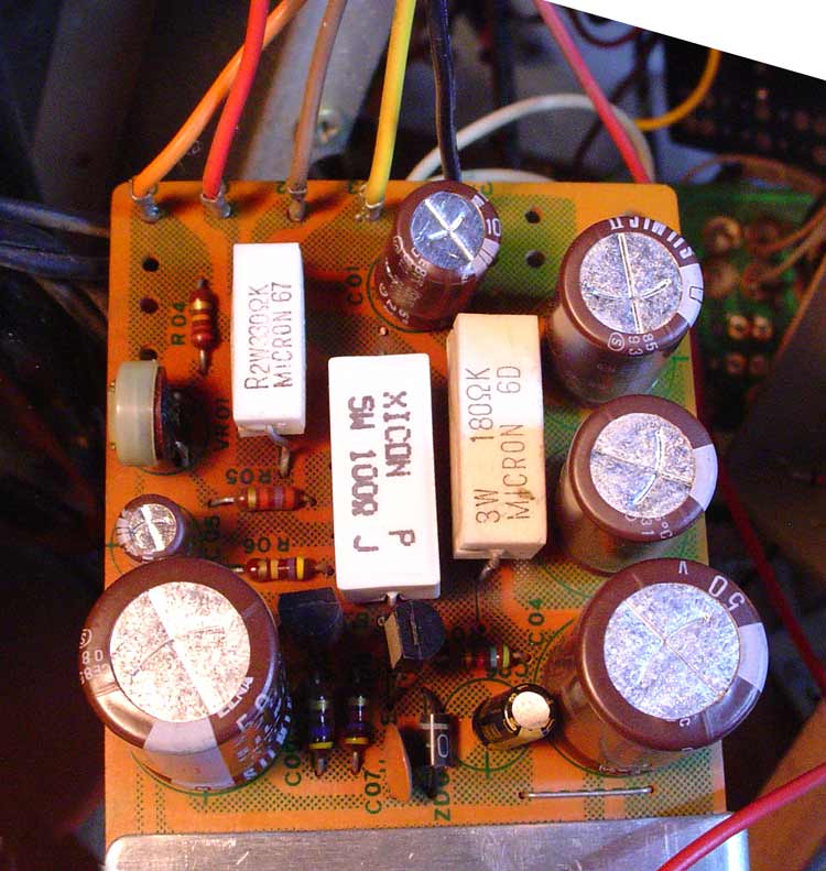

Considering my amp does not have a dedicated psu pcb, what cap values are generally considered to be "power" caps in a circuit? There were some 470mf 16v, 25v, and 35v caps. Two 220mf 35v caps, and the rest were 47mf, 22mf, 10mf, and a lot of 1mf caps.

The schematic is your friend. :D
The filter caps are those 2 big black cans mounted by the power transformer. I think any caps that are used to generate your main rail voltages can be considered "power" caps. In tube gears it's simple because power caps are all 350 wvdc or higher. At least in everything I've ever worked on.
In tube gear, pretty much every electrolytic cap will be for the power supply. In solid state, there are numerous power circuits beyond the main power rail supply to power other sections such as preamp, tone board, phono, power amp/driver, etc.
