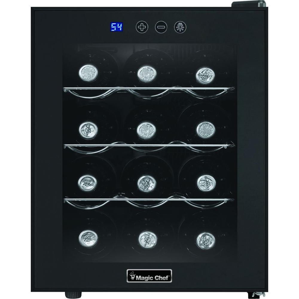

repaired one similar to this with a recap.. Wine cooler
