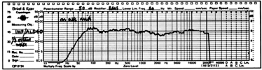

The published frequency response curve for the IMF ALS 40 is shown below. It is relatively flat, but does have some variation here and there. There is a broad dip in response between 1.2kHz and 5kHz.

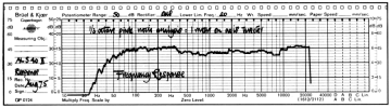

The published frequency response curve of the IMF ALS 40 Mk II is shown below. It is a bit flatter in the region between 400Hz and 10kHz. The bass response has been raised about 2dB in a shelf-like manner. It also has a more rounded and gradual roll-off in the low frequencies.
