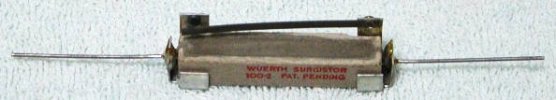

My understanding is that the metal piece stays warm enough because of current flow through it to keep the contact closed. It only opens again once power is cut and it completely cools. Would be pretty useless to have it just open and close constantly.
Thing is, just from looking at the picture of the device, it looks like the metal piece is completely disconnected when it is open, so there appears to be no current flowing through it to keep it warm. I may be missing something, though.

when open it uses resistor heat to close it, once closed it relies on current flow through the metal piece to keep it shut.
I remember seeing the name "Surgistor," but don't think I ever saw the device itself. This is TV junk. Those Amperite delay relays OTOH were used in quite a bit of commercial transmission equipment and ham gear in order to pre-heat MV rectifiers. Failure rates were pretty low, especially when they were used in tandem with a relay to handle the brunt of the current.

I think the most well-known use of the surgistor was in the Heathkit W-5M as an official update to alleviate the initial high-voltage surge and perhaps related power transformer failures.
Did they actually use the type shown in the earlier photo? I would have thought that would be way below Heathkit standards.
I think the one in the Heathkit is this style, but functionally the same sort of device. There is an Eico amp that uses this too but I don't remember which one.
Given the contact closes without the initial surge current (from transformer in-rush and cold heater loading), and is in parallel with its heater element when additional load starts up softly through the 5R4 rectifier, it gets a relatively easy life for a mains contact.

"back in the day" there was an even lower tech solution for this. The heat from the resistor would close the bi-metal contact and current flow through the contacts kept it shut to bypass the resistor. Somehow I can't help but wonder about the long term reliability of this thing, and of course all the exposed mains voltage.
I recall seeing them I television sets, mainly series string heaters iirc.
