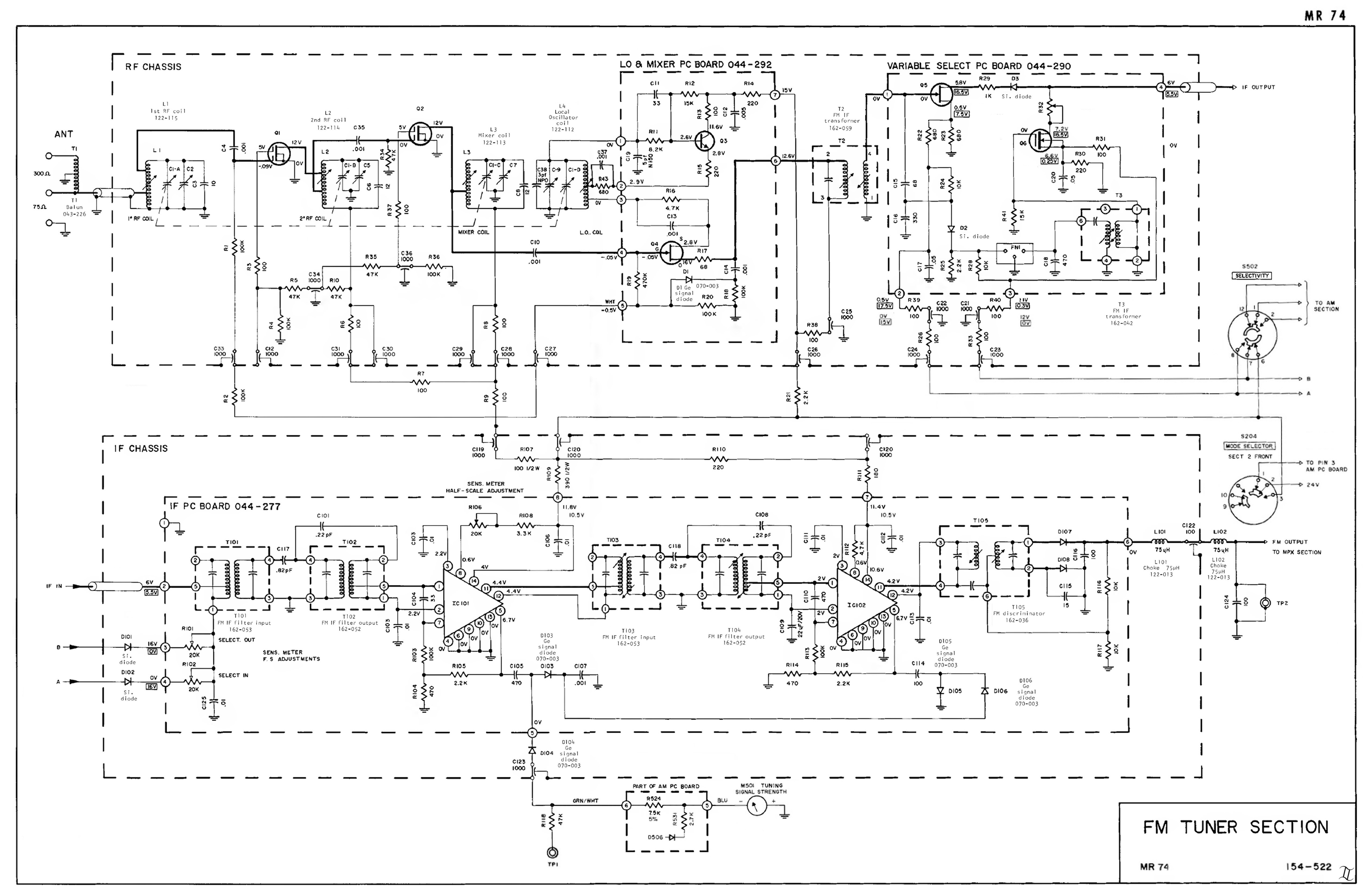

If you do get into repairing one, be aware that the online documentation available is incomplete, or at least, it was. The cut-off FM schematic has been amended, corrected, and verified against a bench unit.
http://www.wwdsltd.com/files/McIntoshMR74FMSchematic.jpg

The example I just finished had multiplex decoding issues, and seems to have had some tweaking of the cores before it got to me. I hadn't done a complete alignment in a while, and while tedious, it was rewarding to decipher the partial instructions in the manual, throw them away, and resolve it the conventional manner to get everything operating. These units have an odd "selectivity" sub-board which affects muting threshold and IF bandwidth, as well as a separate muting level control, and a "stereo filter" control for whatever the hell that is supposed to do. It just makes the work a bit more intense. We've learned a lot since 1973.
If you end up diving in or taking it to a tech, pass along the clean FM diagram, because they will probably need it.
