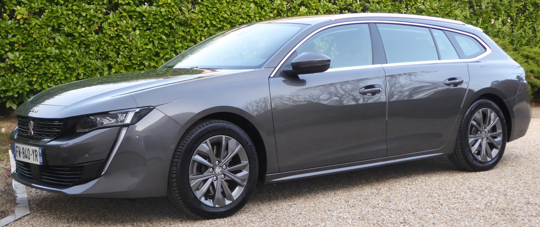

My Peugeot 508SW 2.0HDi absorbs only 4.5L per 100km, on a 600km travel, through plains and mountains, from motorways (at an average of 130km/h) to small roads...
... Thanks to her Turbo-Diesel 16-valves direct injection 2L engine, coupled to a 8-speed automatic gearbox, all this in a Pullman comfort.
