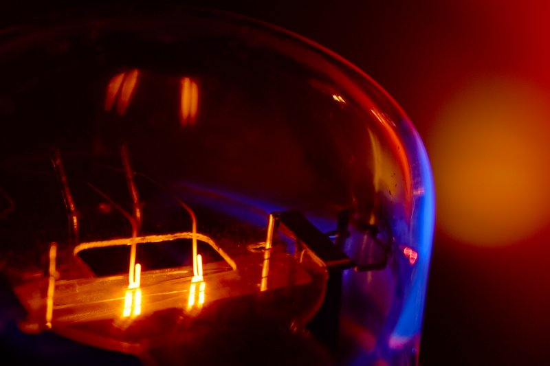

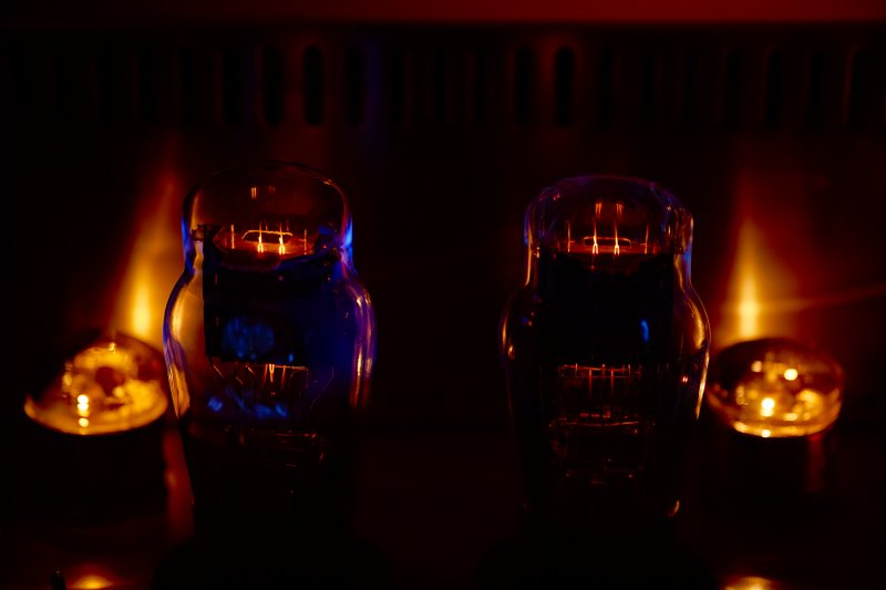

Oh -- took out my 'good camera' to take some pics of the cool blue / violet glow on the new 45s.
