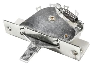

My apologies for bumping this old thread.
I tried to rebuild my Sansui AU11000 power switch, with plans to use the TRIAC design from this thread, but it won't stay together well enough physically due to damaged rocker contacts. I have a different switch I can use but it's designed for very low current guitar pickups. If I can get it down into tens of milliamps it will survive I think. As far as maintaining look and feel of the amp, the 3-way (not 5-way) Fender style selector switch middle position would correspond with the OFF and one extreme position would work for ON. The tactile feedback is even pretty much like the original. I would need to physically restrict movement to the other extreme position and maybe mount the switch at a slight angle vertically to more accurately match the original positions of the lever.
The Sansui switch has a flat blade lever that fits through a slot in the chassis and a slot in the amp face plate and the Fender selector switch has similar but shorter blade lever. I plan to have my son spot weld the original lever to this one so I can use the original knob. He welds razor blade edges together for fun and says he can do this.
I would be happy to add another sensitive TRIAC but I don't know how to do this; I'm hoping someone can point me to the right information because I can't seem to even word my search terms right with my limited knowledge.
Also, can increasing the resistor in series with the gate reduce the gate current surge if there is one? The data sheet for the Q4025L6 lists 2A peak gate current, unless I'm misreading that. I'm pretty sure that would fry this switch even if momentary.
Is such a switch just too wimpy for use as a power switch or can this be done? Are there better similar ones?
Thanks for any ideas.

At the risk of it looking like I am 'teaching my grandmother to suck eggs' - I'd just like to make it clear that a Thyristor is not the same as a Triac, and only the Triac is suitable for this application.
Kindly see my bump on the previous page of this thread, #75.
If your power switch is so poor it can't even carry a momentary peak of 2A then you need get a replacement switch. As reducing the current to even 100mA isn't going to help much. Pretty much any switch with insulation and contacts rated for mains voltages should be able to carry this current, I would be wary of using that Fender switch for that reason, but you could try it and see how long it lasts?
Hyperion, thanks for replying. I too am wary of the Fender switch and I think the only way to make it work is to have another TRIAC to drive the gate of the power TRIAC. The TRIAC directly driven by this switch would need a very low peak gate current I guess, to avoid scorching the wimpy contacts. My knowledge of electronics just isn't enough to figure out how.
@ PViking, perhaps you could reconsider repair of your original switch? I would be leery of a double-triac simply because it has not been tried, as far as I know.
I saw pics of the contacts in your thread. IMHO they are good enough for to be used if the triac mod were to be implemented. Of course, other (better informed) opinions should be solicited.
As far as the mechanics of the switch, if you post pics in your thread maybe somebody can come up with an idea. Lots of creative thinkers here...
