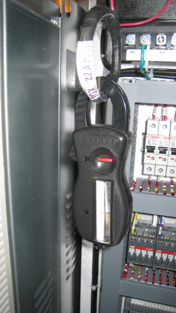

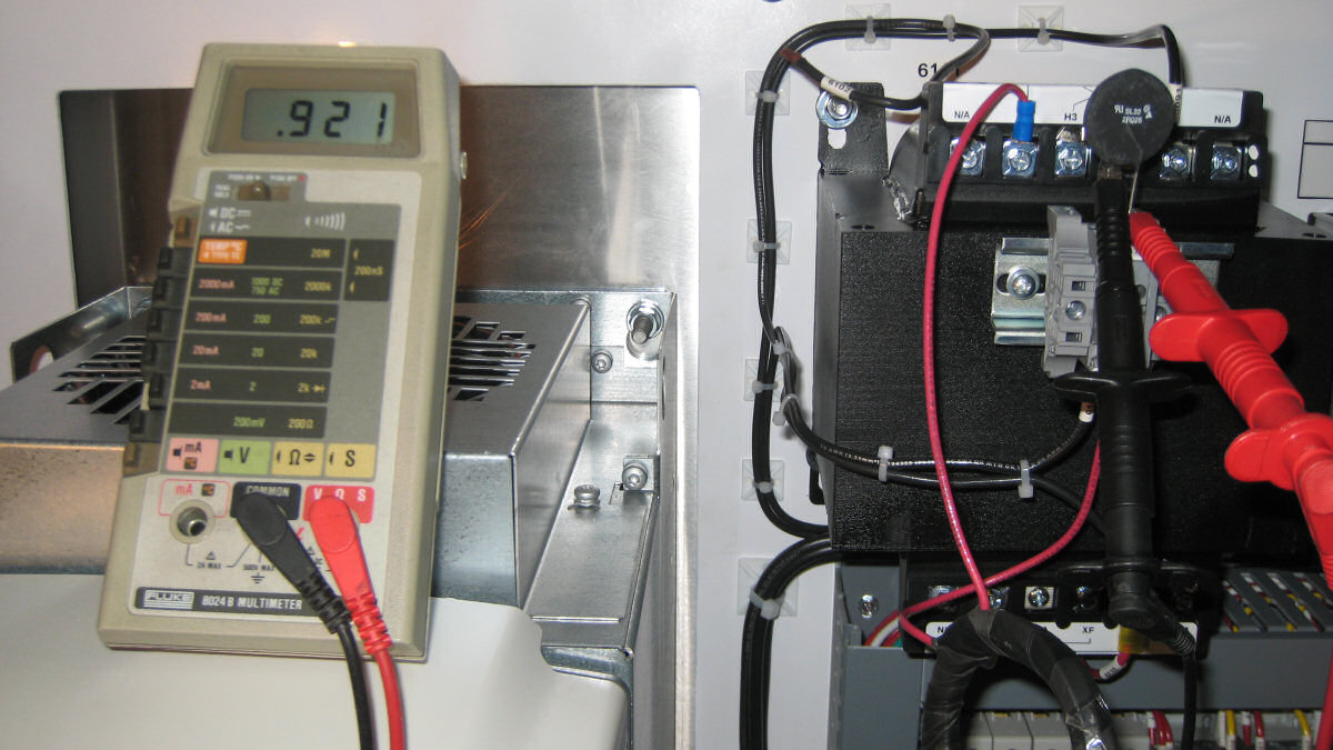

I know the horse is already dead, but I can't resist flogging it a little bit more. As I've stated several times before in several threads, triacs in transformer primaries are not completely without risk. I have empircal and anecdotal (and expensive) evidence dating from the early 1980s regarding this, but that part of the horse has nothing left to wail upon. What we in the rest of the world have done is to limit inrush by other methods. Pioneer was on to this several decades ago with their larger units, using a ballast resistor and relay. It was a good effort, but somewhat cumbersome. Still, it was effective and good enough to be copied by several other makers. They evidently "borrowed" the idea from Ingersoll and Cincinnatti Milacron from a 1960s design in EDM power supplies, and possibly from something even before that, albeit on a smaller scale. Transformers have since become "more efficient" (read "cheaper") by using less iron and less copper. As a result they now have so little CEMF on initial energization that even a Form Factor D circuit breaker can occasionally trip. It's become so bad that even NFPA altered their protection ratings for these small transformer primaries in the 2008 re-write. That makes them much like the even smaller transformers we see in vintage audio linear supplies.
Fast forward to today (or about five years ago) and a more simplified solution became common in controls. NTC thermisters are available in very large energy and current capacities. Since I had several panels in my shop last week I thought I'd gather some data once again. I tried three ratings of thermistors in primary feeds. One was right at the minimum dissipation for the calculated inrush, one was well within a comfort zone, and one was complete overkill but had insufficient resistance to limit inrush as well as we would like. The one which was light eventually split from excessive heat. The one which was best suited was analyzed in more detail.
The result was that after numerous energization cycles on intentional overvoltage it still limited current effectively and easily passed the FLA rating without heating or excessive voltage drop. Energizing a 460V 1.5kVA transformer primary with the supply test panel feeder taps set at 505V (10% overvoltage) the thermister still limited peak inrush to less than 7A instead of the "naked" system inrush of over 55A.
At nearly full secondary load (12A from a 2,000 BTU panel air conditioner) the voltage drop through the thermister was less than one volt (0.2%) and it showed no heating.
Translate this to the primary of your 1kVA transformer in a 300WPC amp and maybe some will grasp what I've been suggesting.
